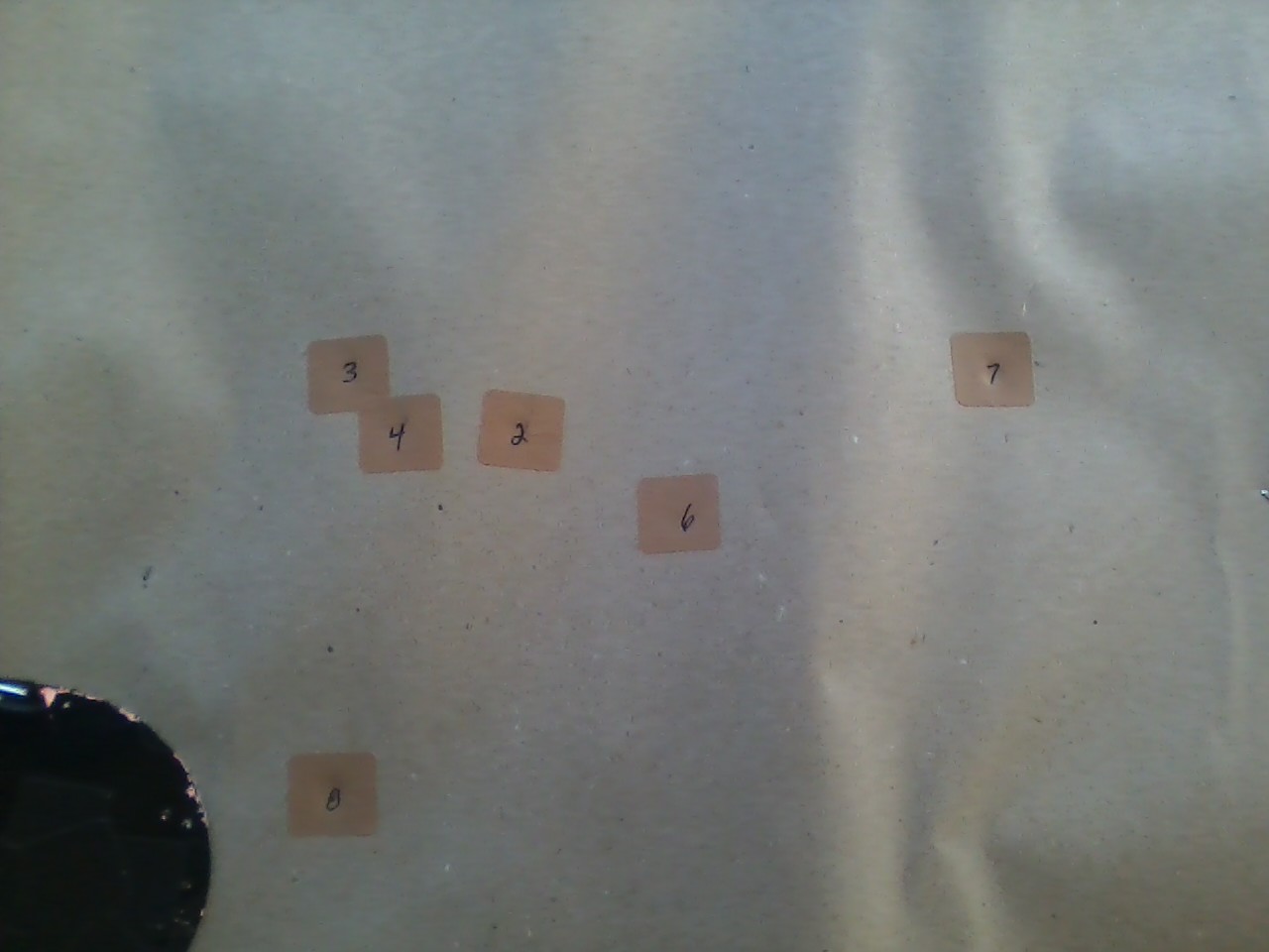

I shot this yesterday at 1000 yards with my suppressed Mk12 Mod1 using mag length 77 lapua scenars, 23.6 varget and Fed AR match primers in Lapua Brass. I guessed the dope and was on target first round, but low. Corrected and left it be for the remaining rounds. My buddy was spotting me and for rounds 2,3,4 the spotter didn't seem to be moving. I think I got excited and pulled round 5 a little low then relaxed and fired the next two. I actually thought he was just messing with me as the impacts seemed to be in the same place. Wind L-R 5mph or so. Don't know why I didn't take pic with measuring, but it was just under 9.5".
Compass Lake match chamber 18" Krieger barrel
Alan
