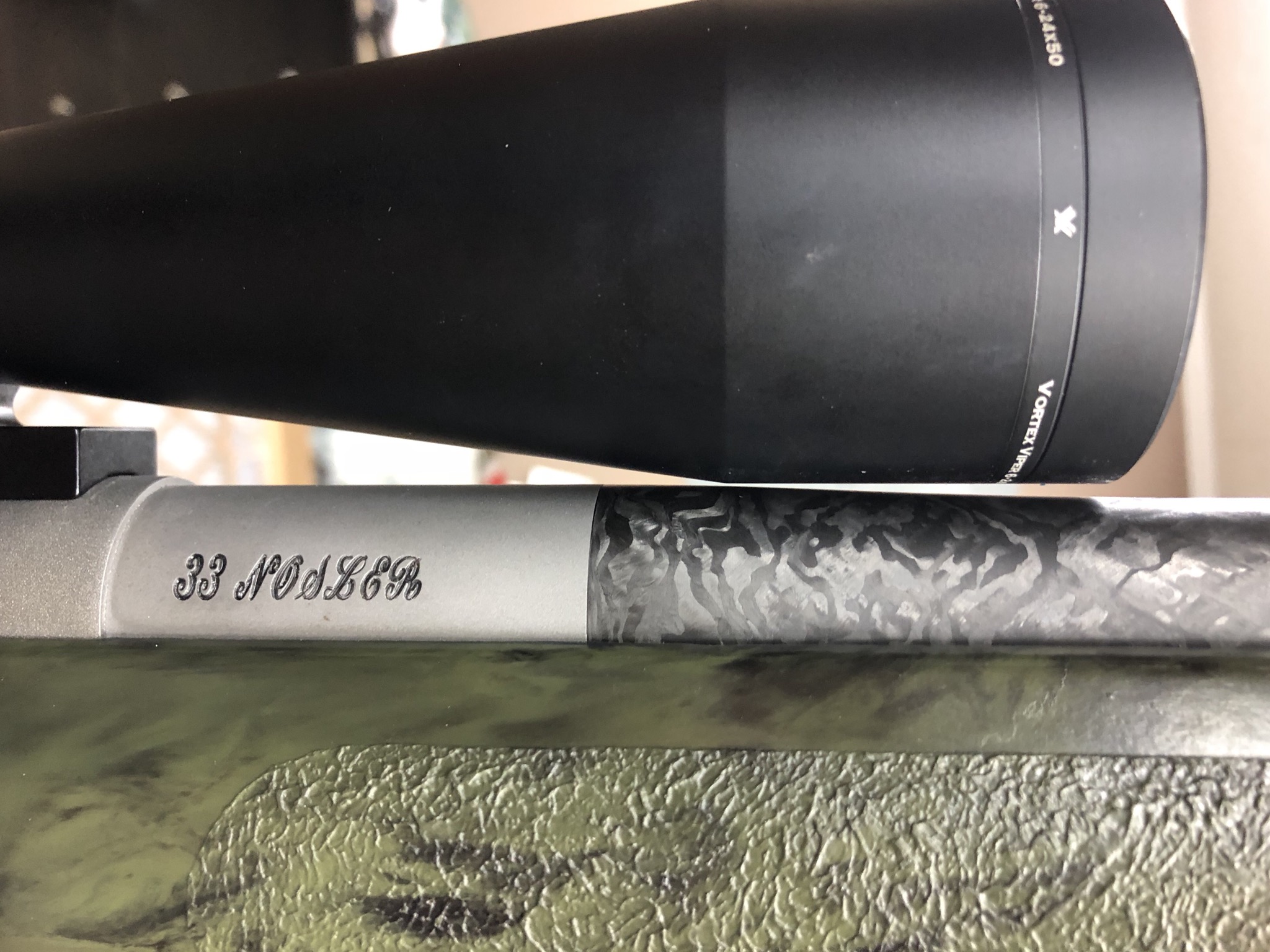

I believe in mounting my hunting scopes as low as possible. I just mounted a scope on one of my rifles. It clears the barrel, but not by much. Is “clearing clearing?” Or is there some rule of thumb out there that I haven’t heard of? I’d hate to have things flex during firing tobthe point where some contact is made. In case it matters, the scope is mounted on a Montana 1999 Long Action via Talley one-piece rings and the barrel is a Proof CF chambered in 33 Nosler. I haven’t measured the clearance yet, as I’d probably have to use feeler gauges or something. Here’s a photo I took. Should I go to the next higher set of rings?

I didn’t say it was. If it works for you rock on. I was just saying comfort is more important than being low. That’s all. As for flex, I think you will be fine, it’s not gonna flex where the barrel and receiver meet
Youll find out after a handful of shots, see if there is a rub mark on the scope. I suspect it will but it’s 50/50, that’s quite narrow if the pic angle doesn’t lie.

agree with spife...hard to tell in a pic, but i had a scope/rings i moved from 1 rifle to another and didnt want to change the rings...it cleared maybe a little less than your pic, a dollar bill would slide under it, but would slightly drag...6.5 creed in a marksmen contour so i figured it wouldnt flex much that close to the action...i shot it anyways and had issues with random flyers...took the scope off after about 20 rounds and the bottom of the scope and top of the barrel had tiny wear marks...mounted with higher rings and problems went away
I have mounted scopes very low. (.020”). I have used one piece mounts with very little clearance between the turret housing and mount (.007”). I haven’t had problems. Get some carbon copy paper and test it.
