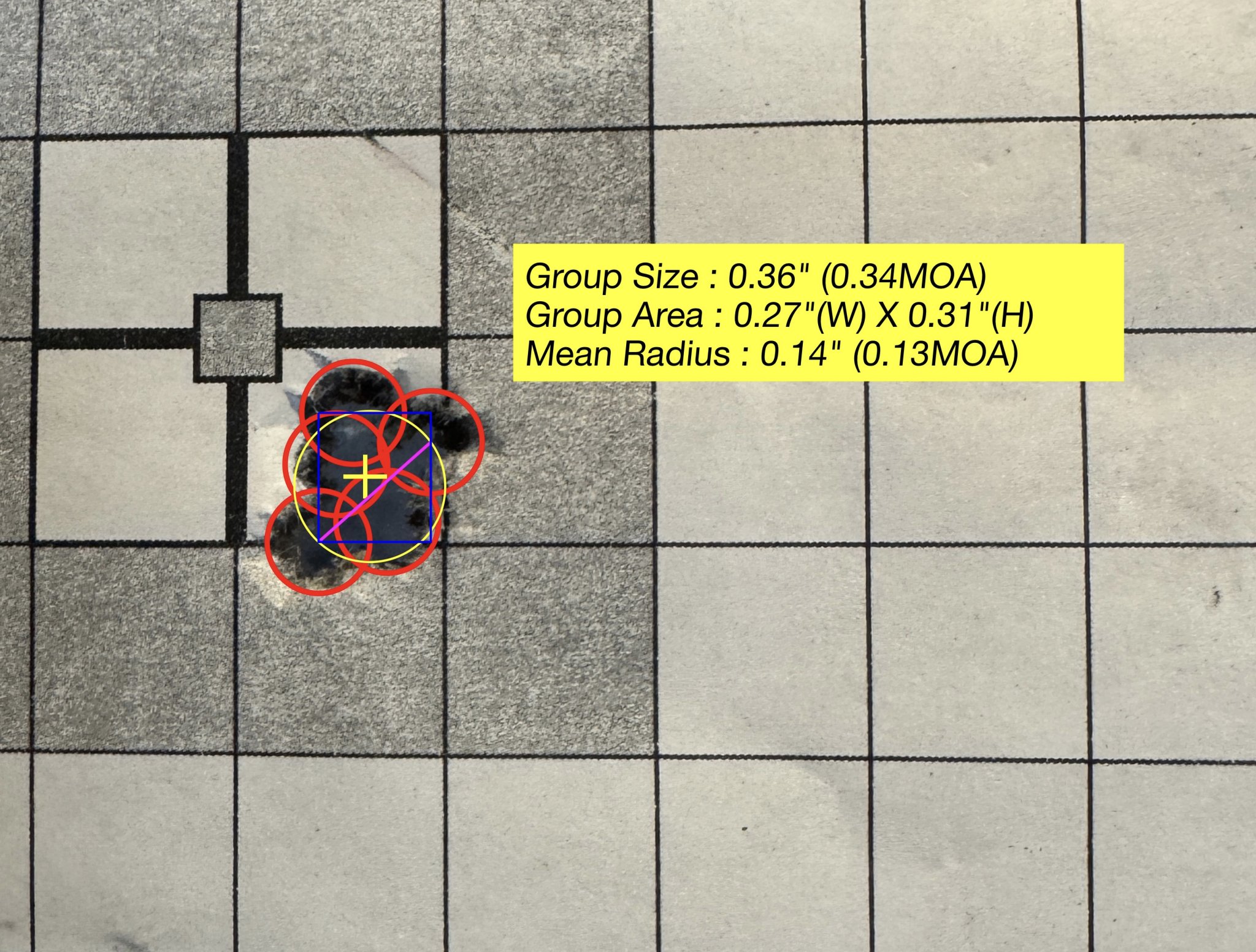

I have a 224 Valkyrie on a 24" barrel fluted, 6.5 twist, no muzzle device, measures .856" at the muzzle.
Its on a standard AR Areo upper, trued, glued, bolt carrier centered.
Capable of .5" 5 shot groups...note: with 3 shots through the same hole, with 95 gr SMK.

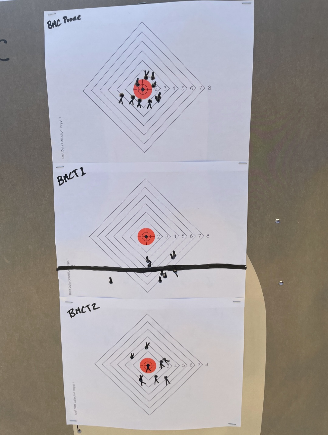

My personal example:
I shot a group from bipod/bag and POA = POI. Moved to a tripod/bag and the center of that group was ~.4mil low. I shot a third group on the tripod/bag while holding .4mil high and found that by me holding .4mil high, the group centered around the POI.
My tripod shooting is ~4moa (I suck), but the group clearly shifted.
Here is the picture of what I'm talking about. As you can see, there is definitely shooter error, but a clear POI shift.

I've used it once at a local match but only had time for limited sight-in. Early results seem to indicate only slightly less POI shift between bipod and bagged shooting positions.
I convinced this shift is an inherent limitation of the ARs design; pressure on the handguard will always deflect the barrel to some extent.
