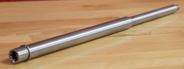

Why not order a barrel with a smaller gas port and a good set of drill bits...
When you get the rifle completed you can open up the port in tiny increments until you get what you are need
Now nothing looks "suspect" anywhere on the rifle

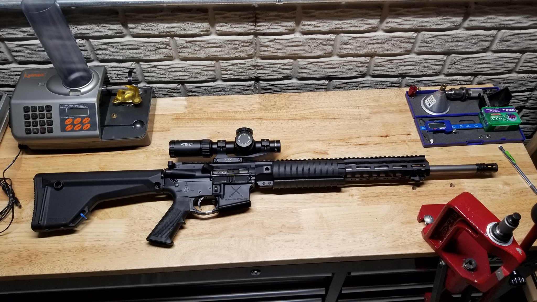

I shoot a fair amount of CMP. I have a solid rifle with no fuckery involved. Good barrel, good trigger, full mass BCG, JP buffer spring, standard rifle buffer, rifle length quard rail, BAD lever, and a 4.5x scope. 13 lbs-ish.
Every single point dropped is my fault. No low mass system or other gadget is going to get me another point.
The off hand is what will eat your lunch if you dont practice it consistently and well.
If you want to build a fantastic rifle, order a White Oak, Kreiger, (and a bolt from them) etc barrel, Geissele National Match Trigger, Geissele Super 42 spring/buffer, Magpul UBR Gen 1 from White Oak Armament, applicable weights, pick your flavor receivers as long as they are forged, a qud rail and the best scope/mount you can afford and go shoot.
As for ammo, 75s or 77s. I watched one of the national guard shooters shoot a 195 at the 600 this year with 77 grain SMK factory ammo (August 2021). He botched the wind call on his first shot, made his correction and then hammered the 10 from there out.
He had no fancy low mass bcg, etc. He is simply an excellent marksman.

A lot of service rifle guys use added weights.
White Oak sells an A2 buttstock weight that is 3.5lbs. You can fill the butt with lead shot if you want a DIY approach. There are several weight systems for the handguards.
The UBR stock has weights for the pockets in the stock.
As for the BAD lever, I can't say I have seen one on a grunts rifle, in combat. I can say nearly every single shooter at CMP matches these days uses a BAD lever. I feel it falls into the "similar" bucket and is non permanent, so they let it fly.
My rifle is as follows:
Aero Precison upper and lower
Geissele SSA trigger
FN Heavy Barrel
MWI Hanguard with quad rail covers (more comfortable to hold)
Magpul Fixed buttstock (plumbers putty and lead shot to balance it out)
A2 pistol grip
Rifle buffer
JP Rifle Buffer Spring
Warne MSR scope mount
Athlon Helos BRR 1-4.5X
It shoots under MOA and is more than sufficient when I do what I am supposed to.
More or less everyone on the line has a similar setup plus or minus a few different names on the parts.
A fully equipped service rifle with a modicum of weight added for balance more than eats up the recoil of the cartridge.
Don't over think it and just go shoot.

I figure most people use weights, it just surprises me that modifying the weight is so prominent, yet the gas system is so controversial.
It looks like the A2 with lead is a little under a pound heavier than the UBR with lead. Granted, I will probably go with the UBR just because I want to be able to adjust it.
Agreed on the BAD lever; the instruction states that so long as the BAD lever (or really, any other bolt release extension) doesn't permanently alter the receiver it's fair game. So the question is whether or not light mass BCGs are "similar", or are they "permanent"? That said, I wonder why piston systems are okay? Nothing against them, but, why?
Beautiful rifle. For your setup...
I too have an Aero upper and lower. Got a "Freedom" in black and a "Liberty" in FDE. Hopefully I can use either, though preferably the FDE. I haven't seen anything limiting the color of the rifle, and I've seen some with blue stocks, so I assume FDE is acceptable.
Definitely going with the Geissele as well
FN Herstal? What makes it a "heavy" barrel?
Not a JP Silent Capture though, right?
How's the Athlon? I'm probably gonna go that way, MAYBE the Leupold after the military discount, but it'll still be $900, and the Athlon is $300 after discount.

A "heavy barrel" in Service Rifle means a thick barrel under the handguard to the gas block. After that, the barrel is back to the normal diameter.
Example below. I have no stake in Liberty(Satern).

Is there a standard diameter to a barrel with a 0.75" gas block, above the gas block? Or are some "extra thick"?
