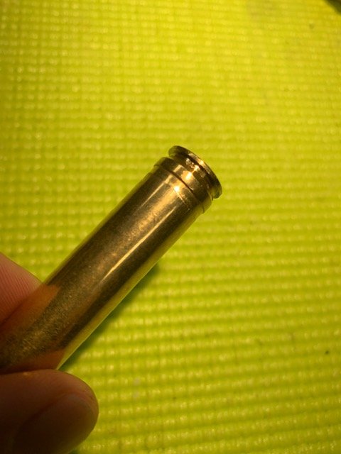

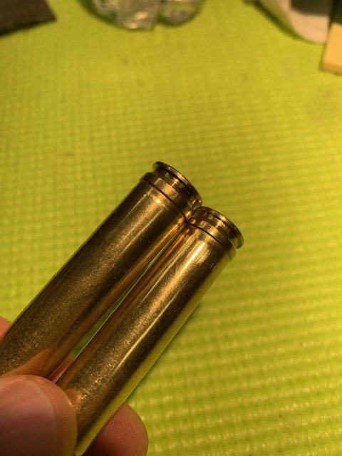

Hi Everyone -
I'm a first-time poster, looking for some advice. I have a new Howa 1500 in 7mm RM. The rifle has up until now (i.e., the last two range sessions) been functioning ok with acceptable accuracy. I have fired approximately 50 rounds through it.
During this "break in" period, I cleaned the bore using Bore Tech and Wipe Out bore solvents (more or less alternating) to minimize copper and other fouling.
The action did have some grittiness to it when cycling, so to smooth it out I put small dabs of jeweler's rouge on the bolt and cycled it a few times. I cleaned it all off well immediately after and noticed some improvement in cycling smoothness.
During my next trip to the range, I experienced problems extracting fired casings. Specifically, I can feed/chamber/lock without issue, but extraction is VERY sticky. So much so that I need to pull back on the bolt with both hands, sometimes after giving it a solid whack forward. I was thinking it looked like an overpressure issue, but I am not shooting any hot handloads, only the same factory ammunition I was shooting before (Nosler Trophy Grade, and Federal Nontypical). I see no signs of excessive pressure at the primer. I see some extraction marks near the belt but it didn't look terrible to me (this is my first belted cartridge so maybe I'm wrong?). I've attached some photos showing some fired casings with the marks near the belts.

Only fired casings are difficult to extract; I can easily feed/chamber/lock/extract/eject unfired rounds without issue.

Your rounds are over pressure and wedging the brass into the chamber abnormally. Regardless of what was or was not before, they are now. It takes two hands for gods sake.
I would agree, looks like pressure. I would also have a good look inside the chamber to make sure it has been cut uniformly. With Howas I doubt that it’s the rifle but in all things there is a chance of error. If you end up seeing anything in the chamber contact legacy sports, they will make it right.
I would give the barrel AND the chamber a good cleaning and make sure the chamber is wiped out. Also clean the recoil lug abutment that the bolt recoil lugs lock into. Clean the bolt and lube the back of the recoil lugs with grease.
Reactions: spife7980
Thanks everyone for your replies! After a thorough cleaning of bore and chamber I had the rifle out to the range again yesterday. This time I brought a few different boxes of ammo to try. I learned that it is the Nosler Trophy Grade alone that is giving me the trouble. The others (HSM Trophy Gold and Winchester Expedition Long Range) cycled without issue.
