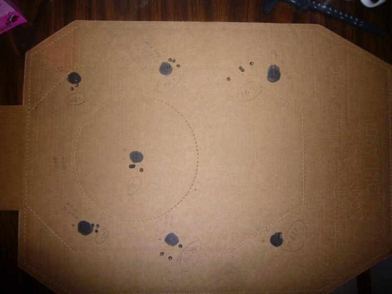

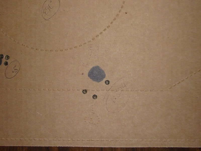

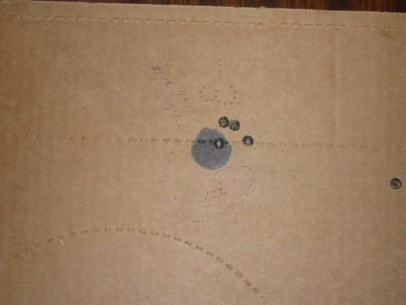

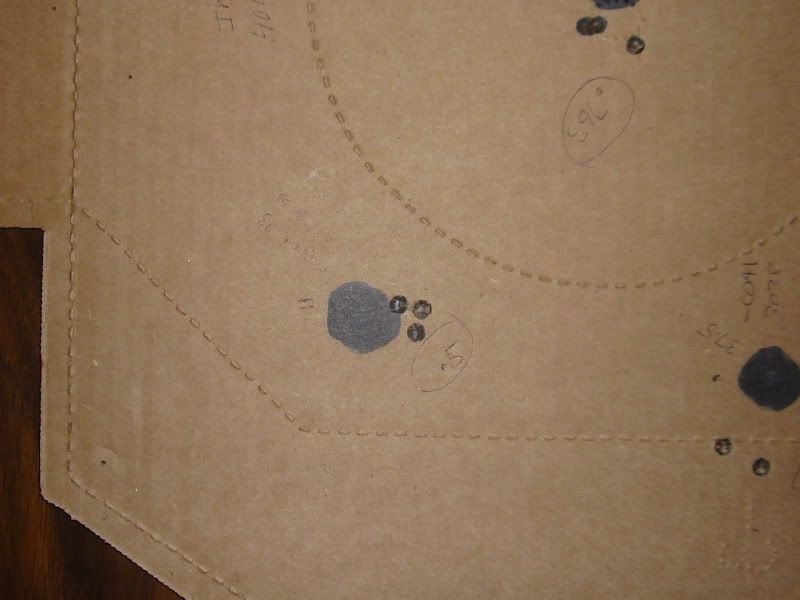

<div class="ubbcode-block"><div class="ubbcode-header">Originally Posted By: fmsniper</div><div class="ubbcode-body">got the rifle out to the range 8:30 am, windy and 28 degree temps, with barrel break in shot .5MOA w/140 grain Amax hand loads, will do better when i figure out what it likes, I started with minimum Grains so i have lots of room for testing
</div></div>
Those A-Max 140 are a great round for 6.5x55 Swede. Love the stock on your rifle.

<div class="ubbcode-block"><div class="ubbcode-header">Originally Posted By: fmsniper</div><div class="ubbcode-body">Varget 33 grain COAl 3038 </div></div>
For what it's worth, that's a very light load for shooting 140 gr A-Max. You have pressure capability up in the neighborhood of 40 grains of Varget.
If I were loading, and this is just my opinion and nothing else, I would load Hodgdon 4831SC, start at around 45 grains and work up. But thats just me. H4831SC tops out at about 48 grains. Be smart, be safe, watch out for pressure signs, etc.
Just an opinion, nothing else.
