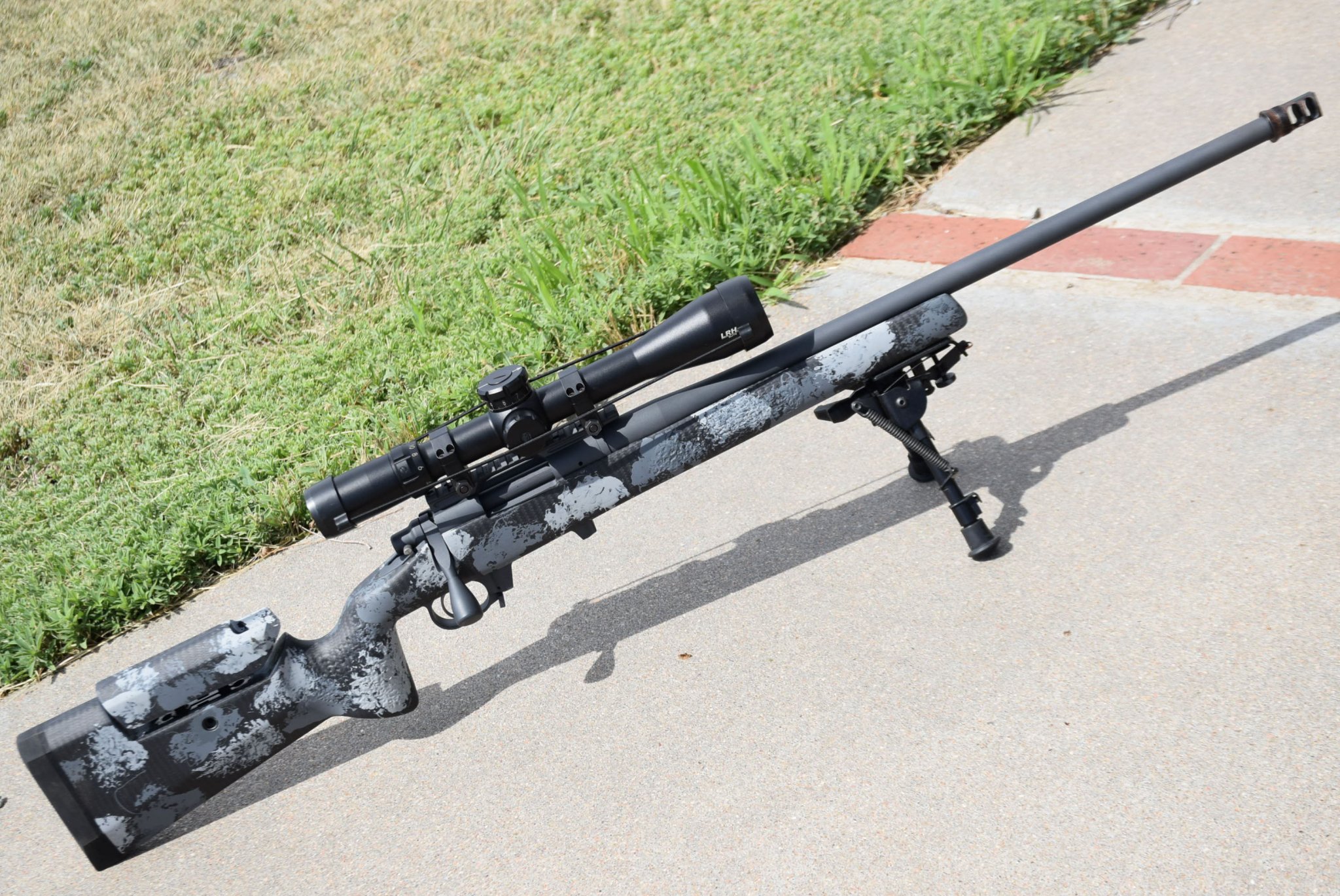

I bought a Manners EH1A stock a few months ago to replace a Manners T3 on a M700 build in 6XC. I really like this stock - even with the adjustable cheekpiece, it's considerably lighter than a T4A, yet is comfortable in prone w/bipod. When I talked with Tom Manners about doing the Mini inlet 2-3yrs ago, the EH1 was the stock he referenced as the most likely model he'd choose for the Mini action. After shooting this EH1A on that M700 for the past few months, I'm really, really wishing he'd re-consider doing the Mini inlet for at least this one stock model....but the last time I spoke with one of the guys who works at MSC about them doing the Mini inlet, he said the only way for me to get a Manners with inlet for a Mini was to buy a flattop stock w/o inletting, and either doing it myself or sending it to someone who has the skills to do a good job. I guess that means that the folks at Manners who make these decisions have decided definitely not to do inlets for the Mini. So, the question becomes - is it worth $700+ to have LRI do the Mini inlet on a Manners EH1A flattop stock? I'm tempted, believe me. If Howa had made a good faith effort to replace their somewhat flimsy & problematic plastic mags with a much-improved magazine, I think it'd be worth it. As it is, there are a couple of companies making BDL-style hinged floorplate bottom metal for the Mini actions, which would get you away from the problems of reliable feeding with the detachable mags, and make for a rifle easier to carry due to the lack of the mag well being right at the balance point. Here's a photo of the M700 6XC that I mentioned, in its EH1A stock - what do the Howa Mini fans here think of being able to get a stock like this with the Mini inlet?

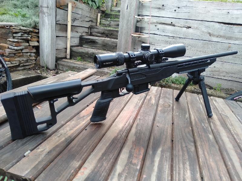

Brownells has a pistol chassi inlet for the Mini on sale for $289.

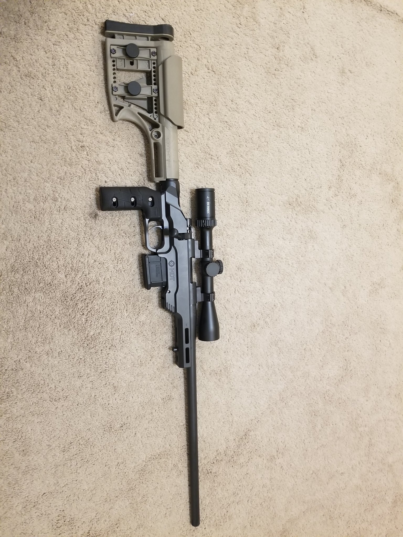

This isn't final configuration, just a stock and scope I had on hand. The magazine seems to work well in the chassis, but haven't put any rounds through it at all.
I am building this out to be a 6BRA.
I am building this out to be a 6BRA. View attachment 7422834
I really like the little Chassis options and think they would be ideal for these guns but they get expensive quick. Even on sale at $289 by the time you add a $100+ dollar stock and a $50 grip you're still around $450. I wish there were better solutions for stocks or at a minimum more offered a rear picatinny attachment like the Pork Sword. I just think it's a shame a generic little folding stock can't be had for less than $100.

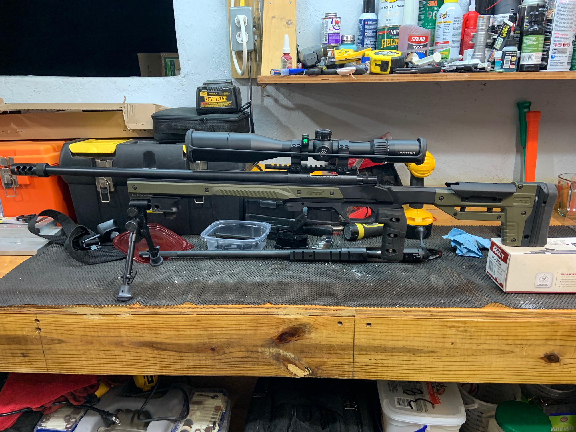

This is my other mini action, this one is a 6.5 Grendel in a Southern Cross Small Arms chassis with an MDT Arca rail.

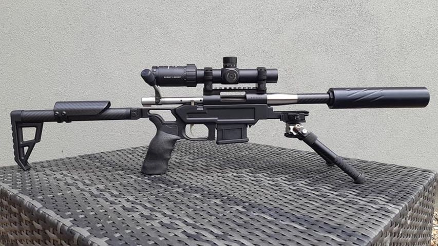

Grandson is of slight build but very athletic for his age. The standard measurement from crook of elbow to crooked finger is 8.5”. I think he can handle the recoil of the Grendel, but fitting a stock is being problematic.
I am considering a LSS Gen2 Pistol Chassis to replace the current plastic stock. Could one cut down a buffer tube and fit a minimal stock to get the needed length that way?
I think you could cut the tube and use some of the butts out there.

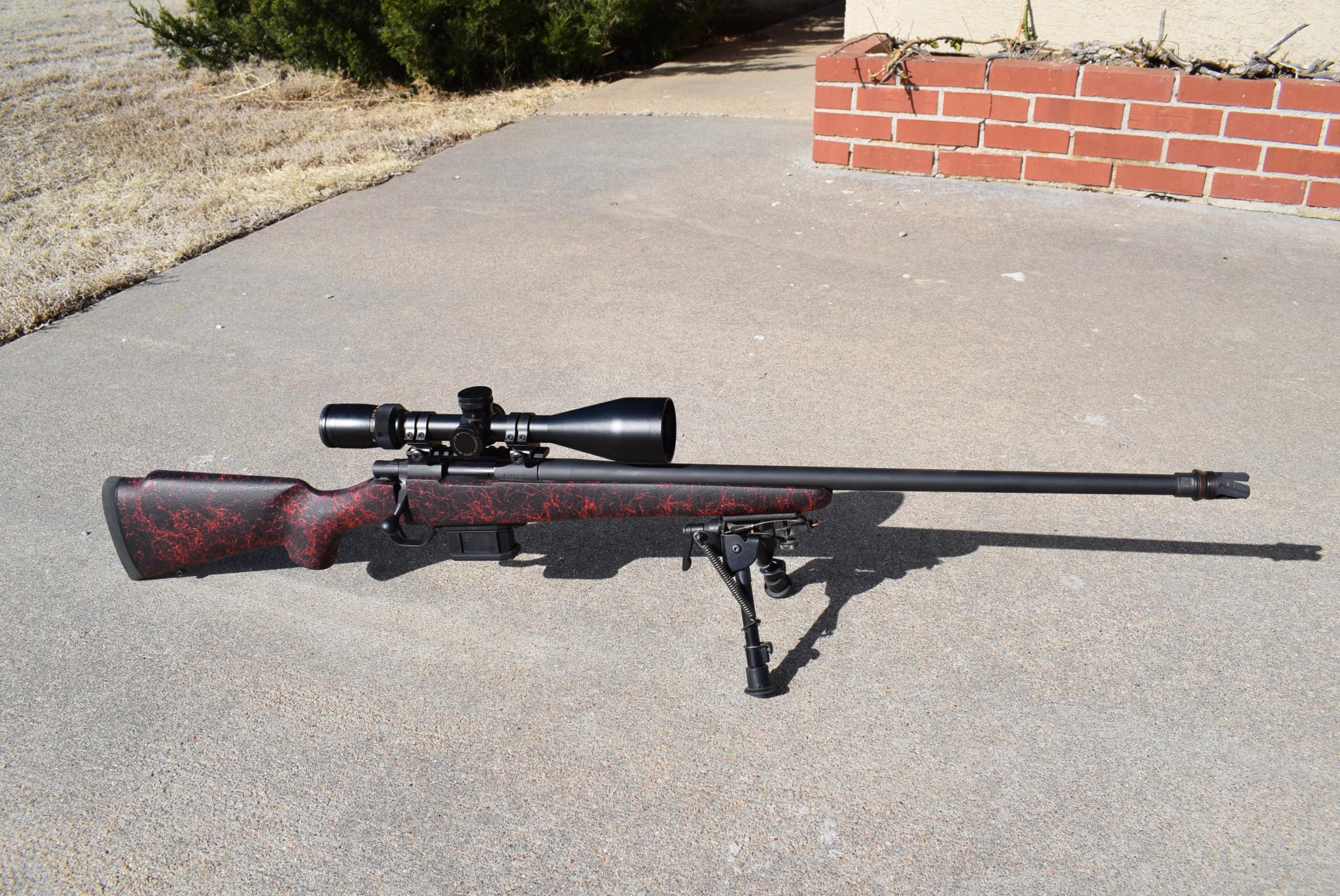

Latest Howa Mini build, based on a Mini that was purchased as a complete rifle in 223. Shot a few rounds through it in the tupperware HTI stock, then bought a B&C #1002 sporter stock, shot it a bit more, then checked the OEM bbl's bore with a Hawkeye, and found a weird looking void (for lack of a better description) a few inches forward from the chamber, which I thought might explain rather poor accuracy out of it. Was looking for an excuse to re-barrel anyway, and this provided all the reason I needed. Got a Krieger #4 sporter 1-8tw blank that was ordered with a shank dia of 1.090", chambered it for 223AI, finished at 24", threaded the muzzle 9/16-24 for a TBAC flash suppressor/mount, then bedded it in the B&C stock, and finally shot it with CeraKote armor black. The aluminum DBM is from Jefferson Outdoors, went with a Warner 20 MOA sloped scope rail up top, then mounted an old Weaver 4-30x50 Super Slam in el cheapo Weaver Quad rings. Not crazy about the Weaver's 1/8 MOA clicks and lack of a zero stop, but it's got very good glass, and has tracked/returned to zero quite well when checking zero at 100, then backing off to 600 to shoot some old ammo loaded with JLK80VLDs (which shot quite well at that distance), then moving back to 100. It takes just over 13 MOA at 600, which is nearly 2 full revolutions on the elevation turret. Could swap the Weaver for an Athlon Midas Tac, but I kind of like the looks of a good quality 1" scope on the Mini.
