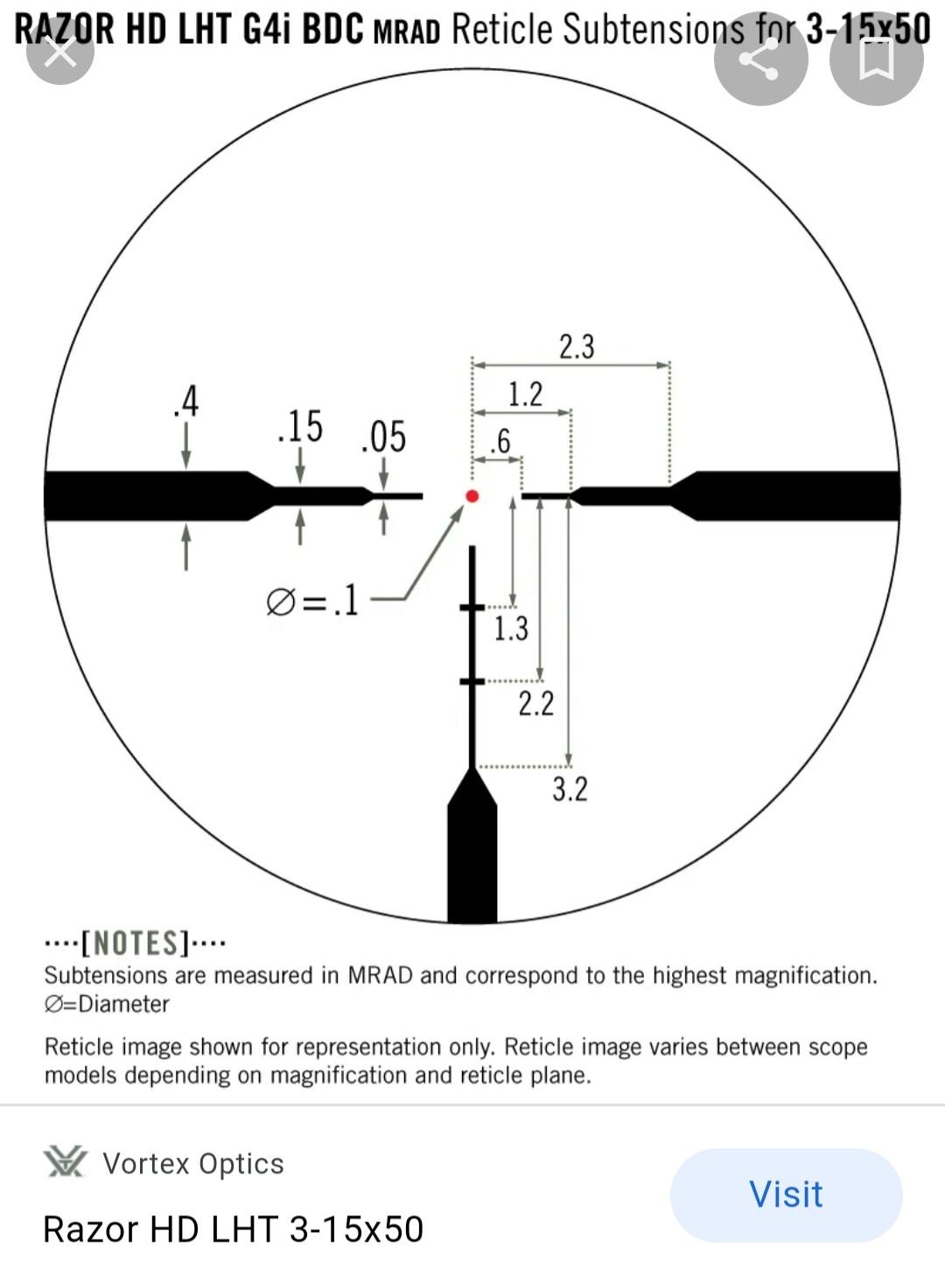

I also have a pst2 3-15 and the lht is brighter overall and is better in low light. Not that the pst2 is bad the lht is just a bit better as well as a lot lighter. Imo the lht also has an excellent eyebox on 3x for offhand shooting.
Downsides are the turrets aren't the greatest and on that sale model the focus isn't marked.

Razor HD-LHT 3-15x should be on your list.

I think the safe bet is the razor LHT. Pretty solid bang for your buck. Pretty sure you can catch them on sale for sub $900.

Vortex must be reading Lowlight's posts.. 0.6 mil... mph rifle/ammo combo
I have two of these for the reticle simplicity and wind correction simplicity. Not a crowded reticle is a plus to me.
