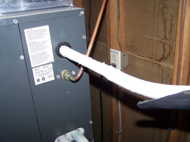

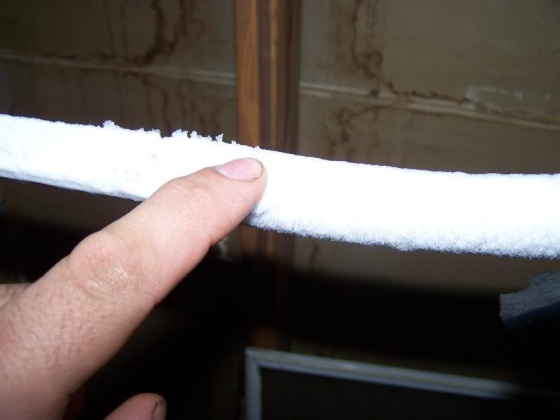

Hey everyone. I have a question for you hvac guys. I installed an amana 95% efficency furnace and a 1.5ton ac in my house 2 years ago. It has worked fine untill I started to use the ac this summer. The airflow out of the vents is less than before. I changed the filter and no change. I inspected the air inlet and there are no restrictions. The air outlet is not restricted from what I can see with a mirror in several registers.
The other night I went into the room to look it over again and the low side copper tube had ice/snow built up on it where the copper was exposed before the foam insulation covers the tube. It has never done this before. It seems to me the blower is not moving enough air thru the evap coil and the evap is icing up after running all day.
I put my wind meter by several registers when I started it up tonight after not running the unit all day. The outlet temp was 70deg and the house is 72.5deg. the wind meter did not register at all. I had one register cover removed and stick the meter up into the center of the vent and I get 2mph reading max. It never moved air like a jet engine but before you could feel airflow and now there is next to nothing.
I verified the fan blades were not damaged in any way and not covered in lint or anything. It has never been run without a filter and they are changed regularly. Also, I have been using the better quality pleated ones not the cheap blue mesh ones.
The owners manual says the fan motor is preset to the high blower speed. I verified the correct wire (black) is run to the correct spot on the controll board for high speed blower/cooling.
I can only figure the issue has to be the blower not running full speed or something blocking airflow over the evap coil. Being as it has never been run without a filter and I had the vents cleaned when I put the units in. I doubt it is anything built up on the evap coil. So, can the blower motor operate but not run full speed when powered thru the high speed wire? I just need a plan of attack before I start tearing into things.
