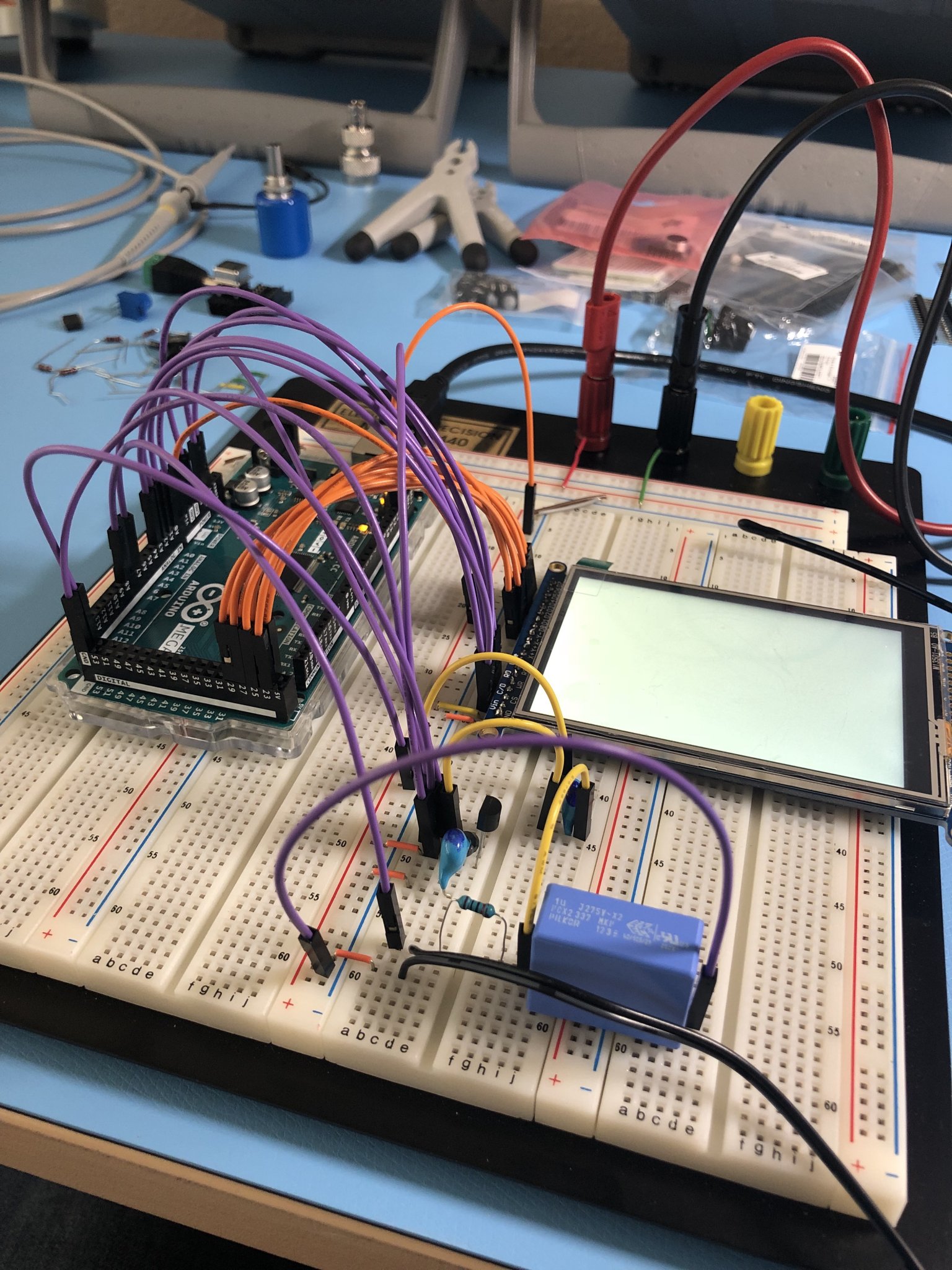

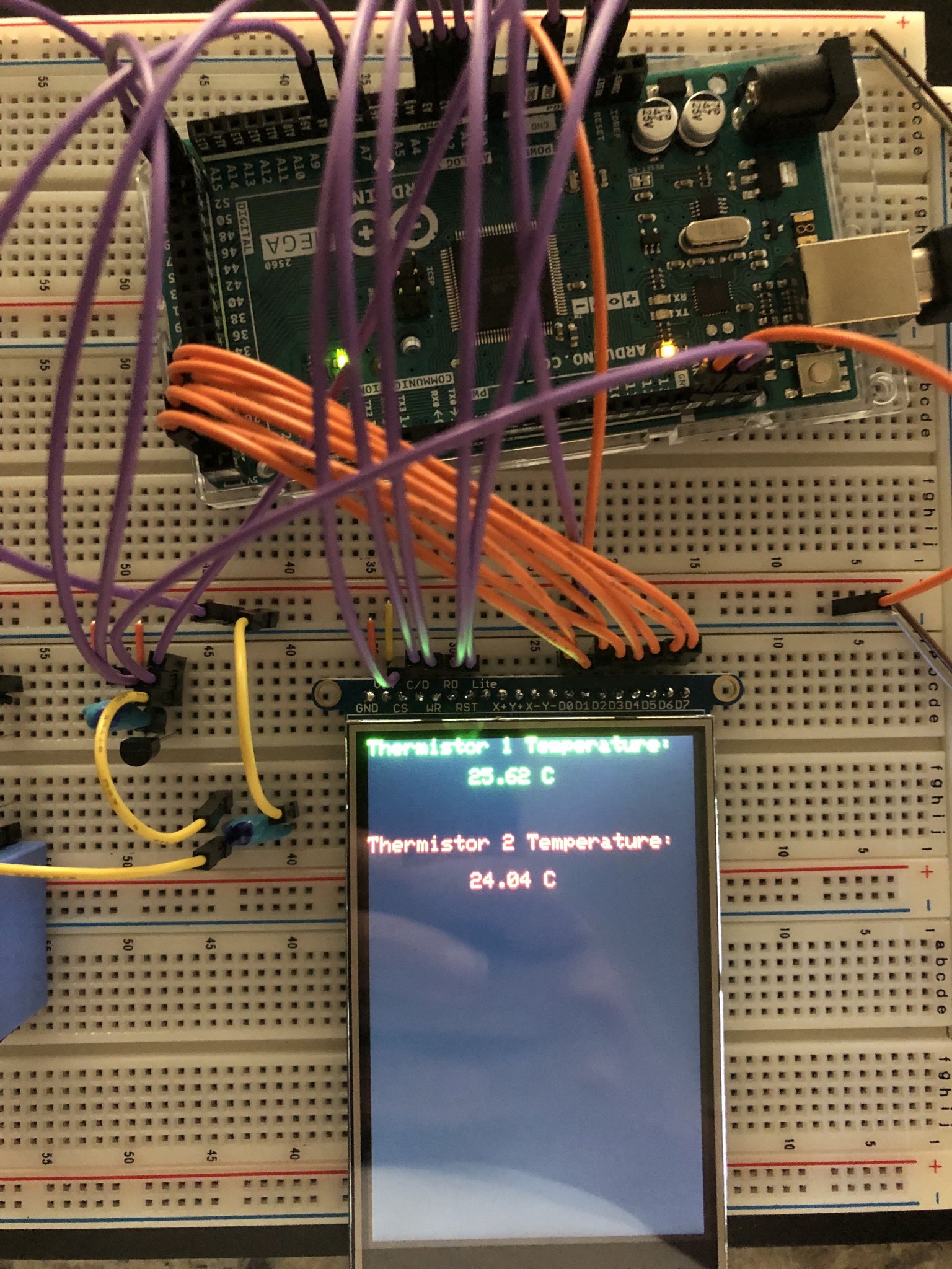

Join the contestI’m in the process of building and programming a machine that will check headspace and/ or trim length of sized cases. I find the process tedious when I have 1300 cases to load up for Prairie dog hunting. Plus i just love to tinker.
You'd also be amazed at how much effort can go into such a simple device.
