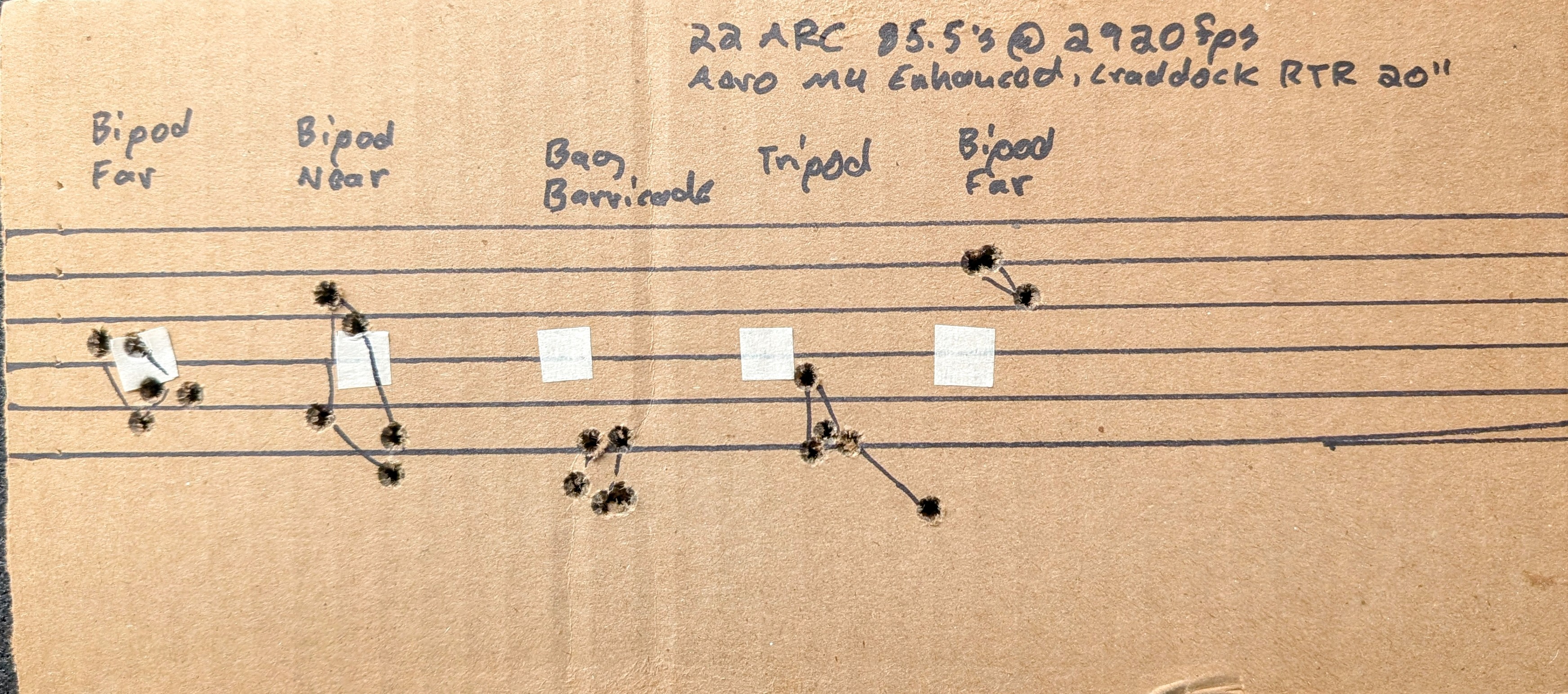

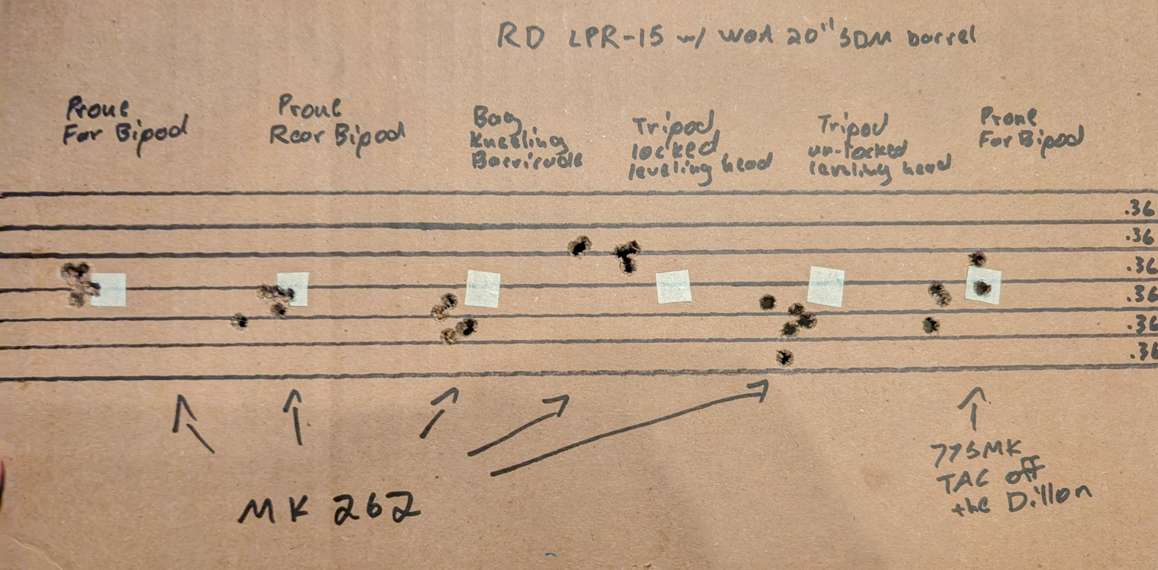

You might consider that control comes from the support hand. In a variety of shooting disciplines and with mechanically different guns. When shooting a pistol you want a firm grip with the firing hand but a hard grip with the support hand. When shooting quickly at short range with an AR, you want more grip and pulling back into your shoulder with the support hand and again just a firm grip with the firing hand. These are for slightly different reasons, increase speed of the trigger finger, but it demonstrates that control doesn't come from the firing hand grip. When you're shooting a long gun, your firing hand grip is the 3rd and sometimes 4th point of contact. Your cheek, shoulder, and support hand(wether on the rear gripping a bag or on the foreend applying pressure on a bag on a barricade) are supporting the gun in it's NPOA. The firing hand should not support the gun. And on top of all that the ultimate goal isn't just to lay down and shoot tiny groups at 100, it's to shoot the same zero out of multiple positions. So are you going to maintain the same pressures with the firing hand grip off a barricade and a tripod, or off a bag? Probably not.
One parting shot. Here's what I'm shooting using the technique I described above with a 20" WOA. Might be worth at least trying.

Well said. And are those different positions for each group?

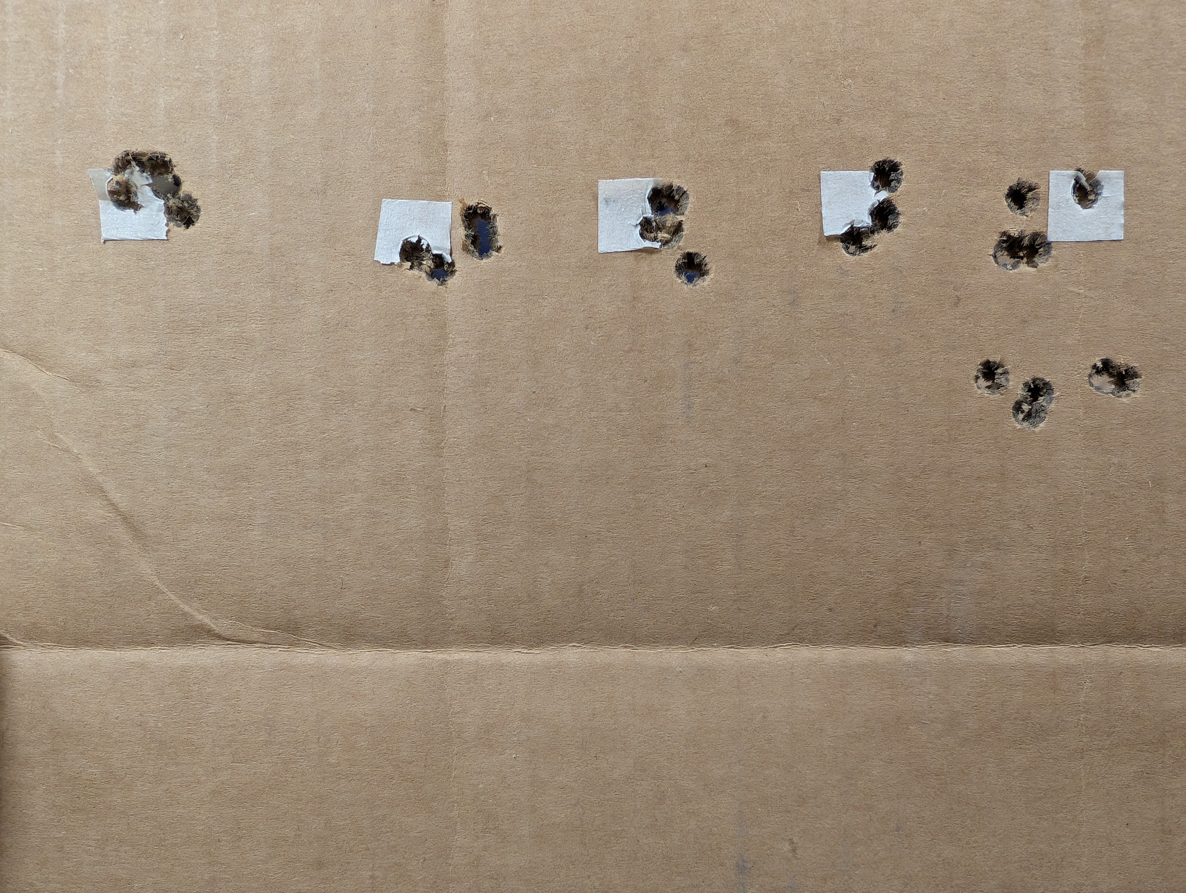

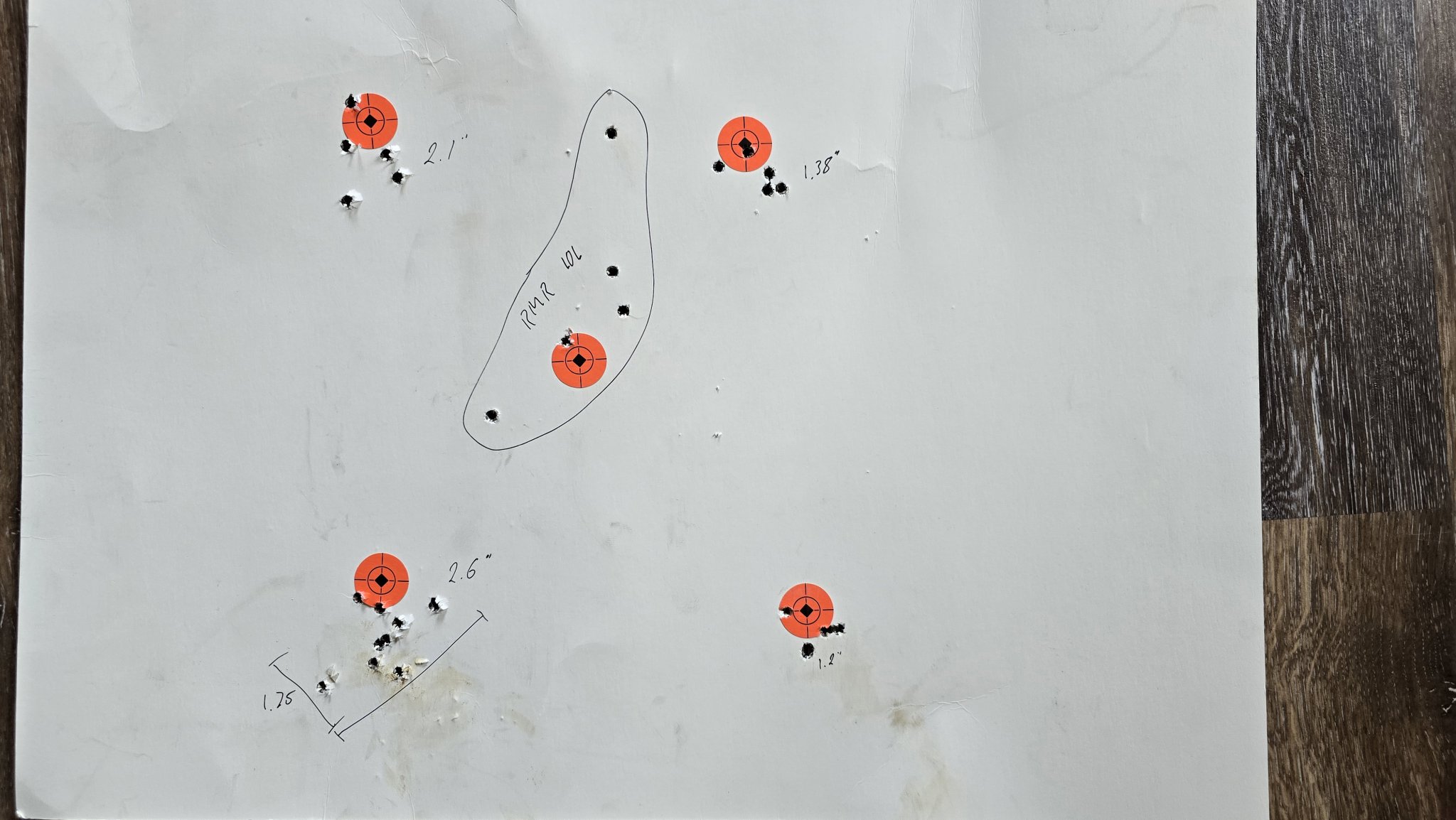

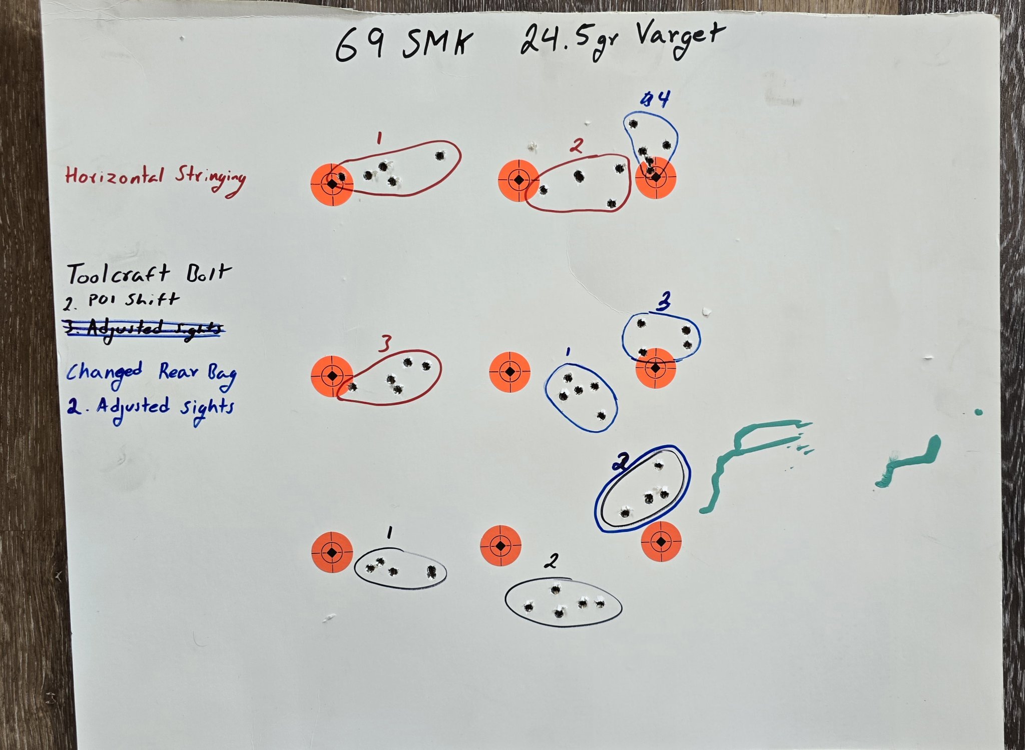

I'm having some real struggles with shooting groups. I'm slowly realizing that I just might be trash at shooting.
This is my first attempt at building and shooting a precision small frame AR. The plan was to get a barrel in and test it before sending it off to D.wilson to have it converted for the LMT MRP.
This is where it went sideways. The barrel shoots like crap. My first outing I had shot the 75gr RMRs in to a laughable 6" group (didn't measure). The 69gr SMK and N140 shot a lot better but still big.
The second outing wasn't much better. I was testing a different load and was removing muzzle devices changing bolts etc.
The groups had a totally different shape with a lot of horizontal stringing.
After getting off the rifle, I shot Black #2. I noticed a POI shift and figured I'd change my bags out (ended up stacking a fortune cookie on my Wiebad rear bag (I don't like that bag, but it fit under the B5 sopmod stock)
Do I just need to get a different stock? New rear bag? Is this barrel trash? Am I trash?
I know semi autos are a different animal but I'm not new to shooting precision rifles...

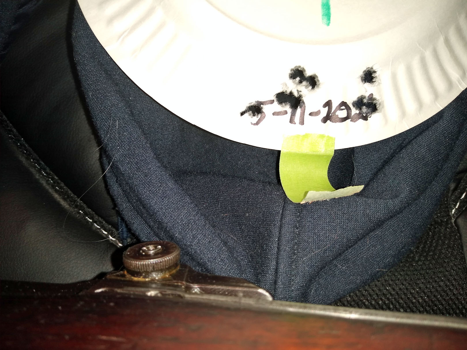

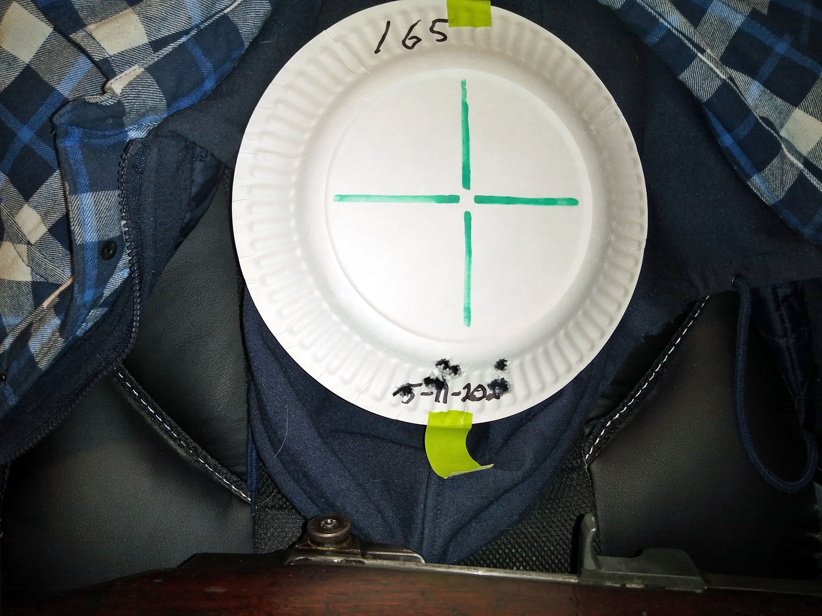

When I use Iron sights ,I can't see the target cross at 165 yd. ,I can see the plate but JUST BARELY . So I aim for what I'm guessing is center mass . Yet CAN'T see impacts . Evidence illustrated with paper plate target and My M1 Garand using MY handloads and 173 gr. bullets back in 2021 .
All #8 are there , what I was unaware of until I pulled the sights down was a stripped pinion . Since replaced and I now can elevate or lower POI . What I can still do is Aim and 3 point reference ( Triangulate Rifle sight too target ) while holding steady and squeezing the trigger . I'm confident MY rounds will be grouped as near as I can hold but actual POI ,is now somewhat of a Mystery ,until I pull the Target (y)
Shot strings up and down are powder variations mostly, left and right is the shooter....plain and simple
