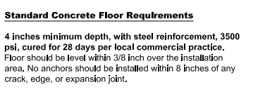

Got a price for a 40x64 metal building I want. Found a local guy who sounds like he knows what he's doing. It's going to have a 15,000 pound car/truck lift installed. Where the lift is going has to be 4 inches thick, steel reinforced and 3,500 psi.
