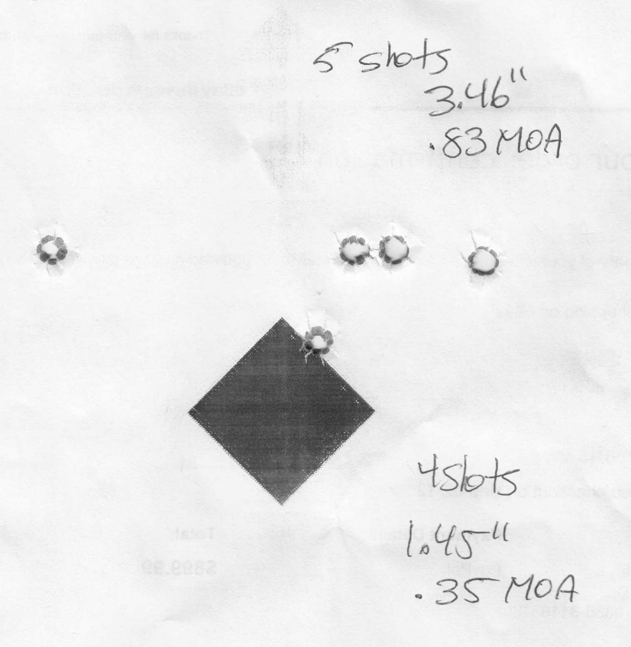

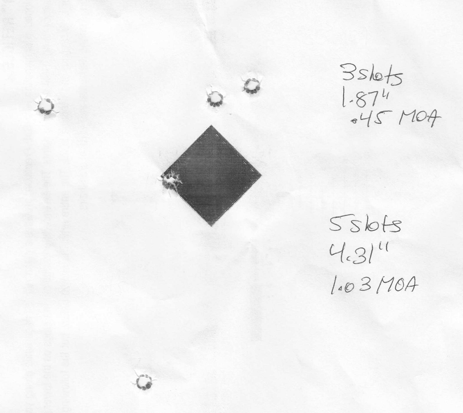

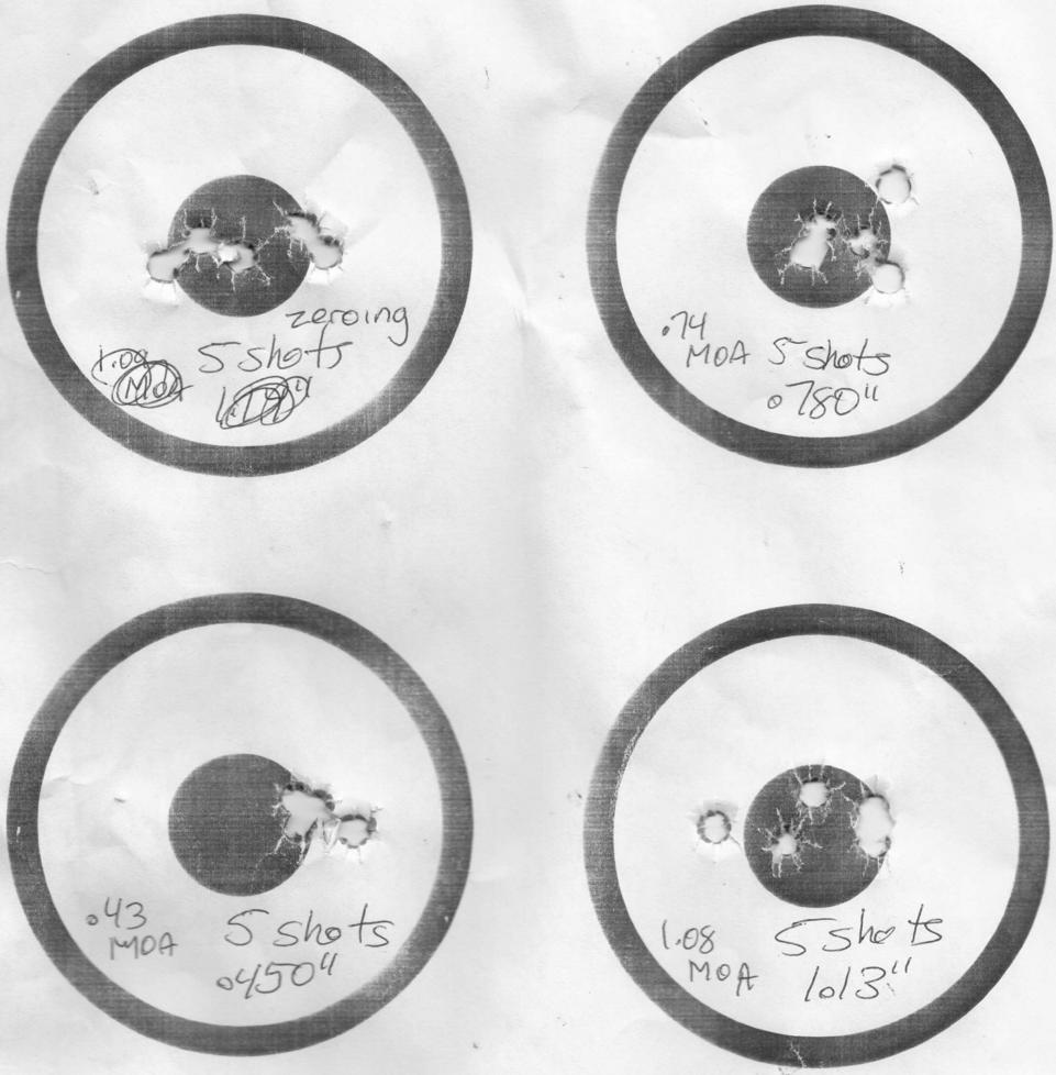

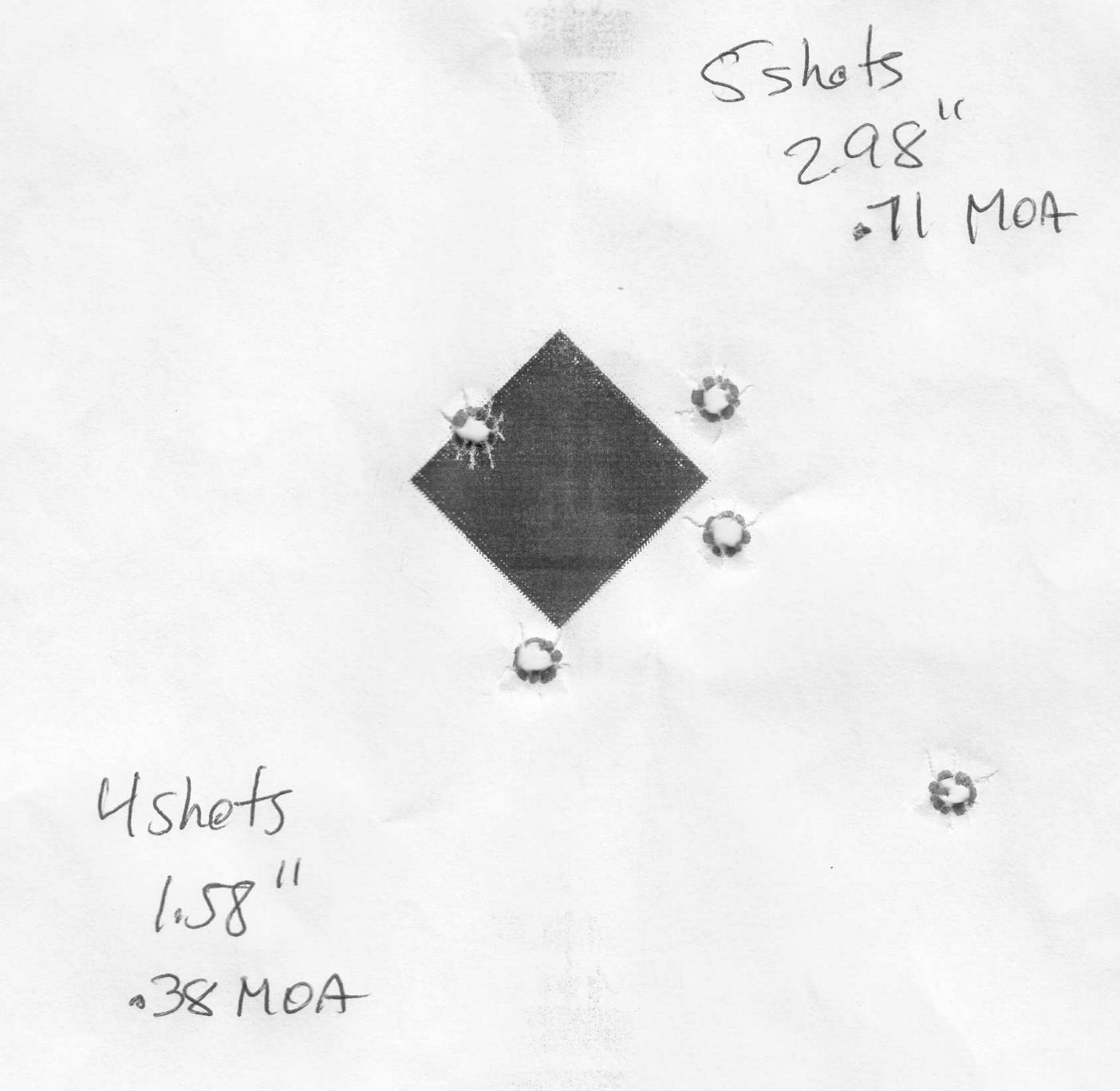

I shot at 100 and 400 yards today and got some mixed results.
One 5 shot group at 100 yards is the tightest I've ever shot, and 2 others were spoiled by "fliers".
Those results followed out to 400 yards, with most of the shots grouping tightly but the groups ultimately spoiled by an errant round (or 2).
If I could go back in time, I would mark the rounds I had to correct, and hopefully I would find a correlation there.
If I could ignore the fliers (which I can't) 2 of the groups at 400 would be astoundingly good (for me and my ability).
Note that regardless of my skill level, I know when I'm shooting well and when I screw up a shot, and I wasn't doing that today. The wind was 1 MPH or less the entire time I was there, in other words, perfect conditions.

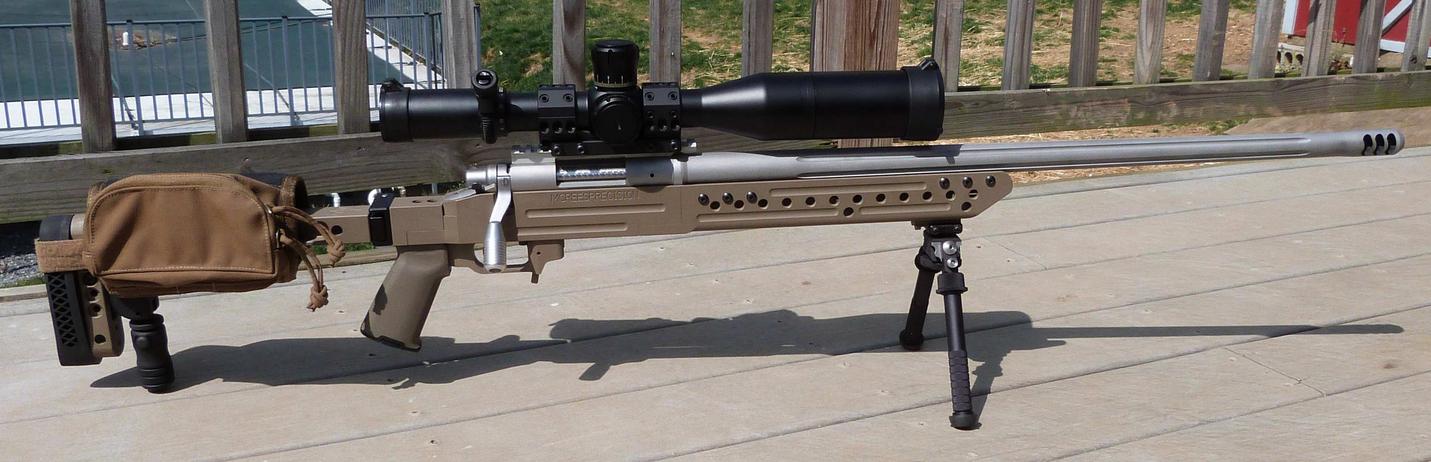

It's a stick I put together myself.
Stainless SA Remington 700 action, Brux 24" M40 profile 1:8.5 twist fluted barrel with a Little Jimmy brake on a McRees folder, pinned rail (screws opened up to #8-40) with a Steiner 5-25x56 MSR in a Spuhr 13 mil mount.
It had an XRS on it when I took this picture.
With the weight of this rifle and the brake, there's so little recoil... I could shoot this thing all day.
