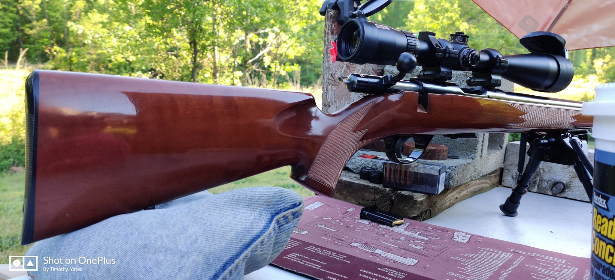

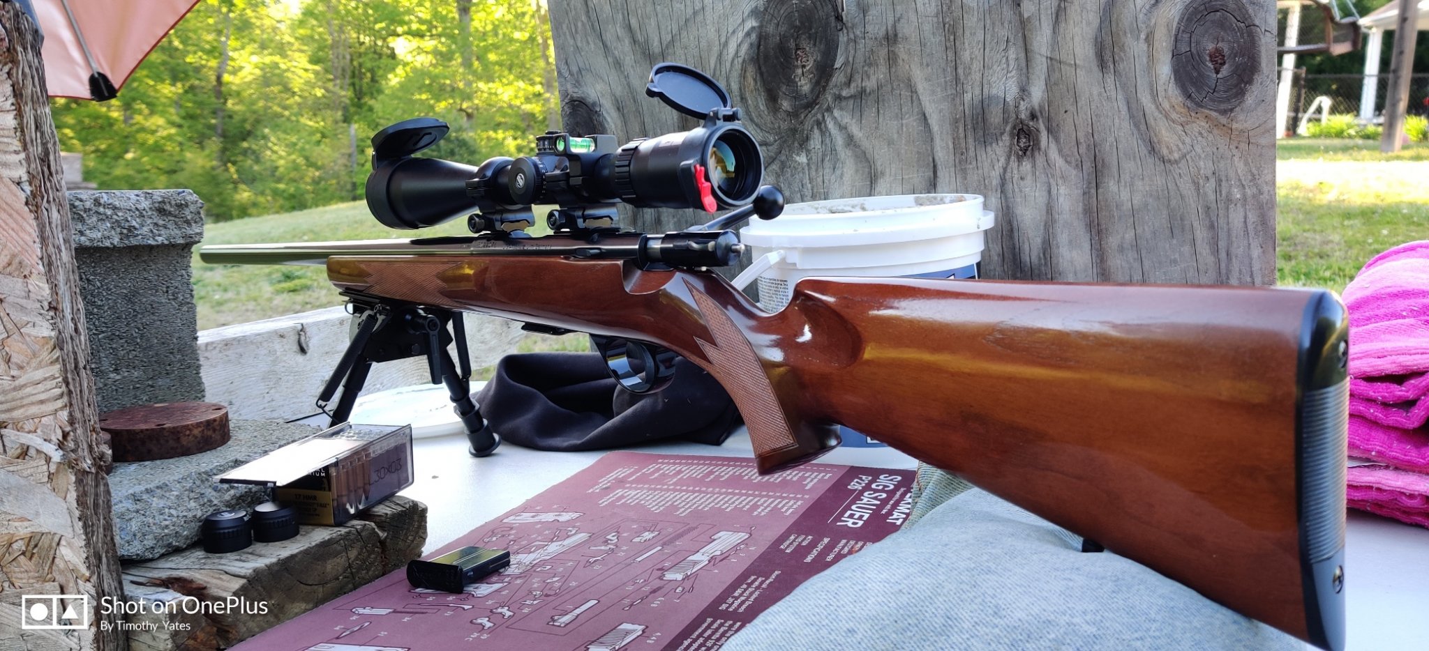

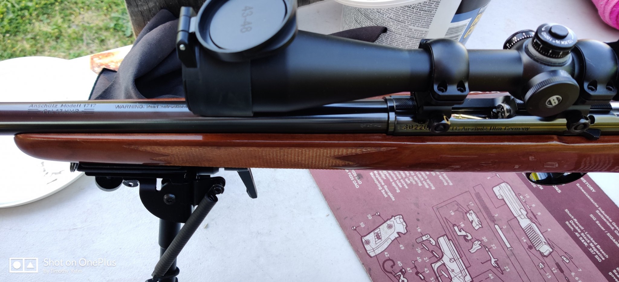

Everything is fixed on the T1x with the IBI Barrel with the Win 52D chamber. SK feeds great, Lapua feeds great some Eley does but not all. A few days ago I got to shoot the T1x and 457 with zero wind and the results were fantastic with both rifles "for my skill level". I believe the Win 52D chamber is overall more accurate than the Calfee 4 chamber in my 457 IBI barrel. Sadly the B-14R is lagging behind both overall. My next session will include the Anschutz 1710 and 1712.

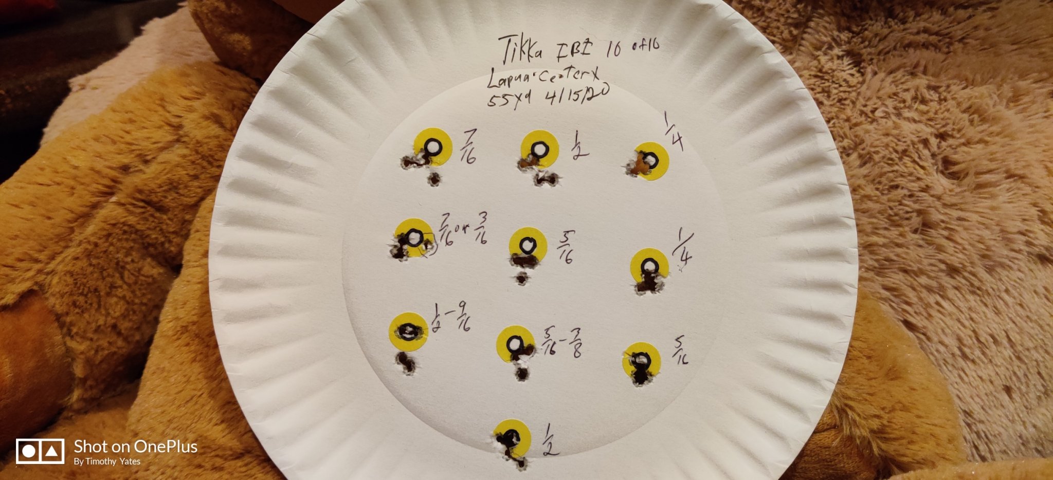

A friend of mine invited me to the Greenville Gun Club and I got to shoot the T1x and the 457 at 100 yards. If I do this again I will have to come up with a different target type. I'd like to at least get five 5-shot groups in. I calculated an average based on the 4 groups, AVG is at the top left of the plates. Ammo that was most accurate at 55 yards was the most accurate at 100 yards. There was some wind on this day.

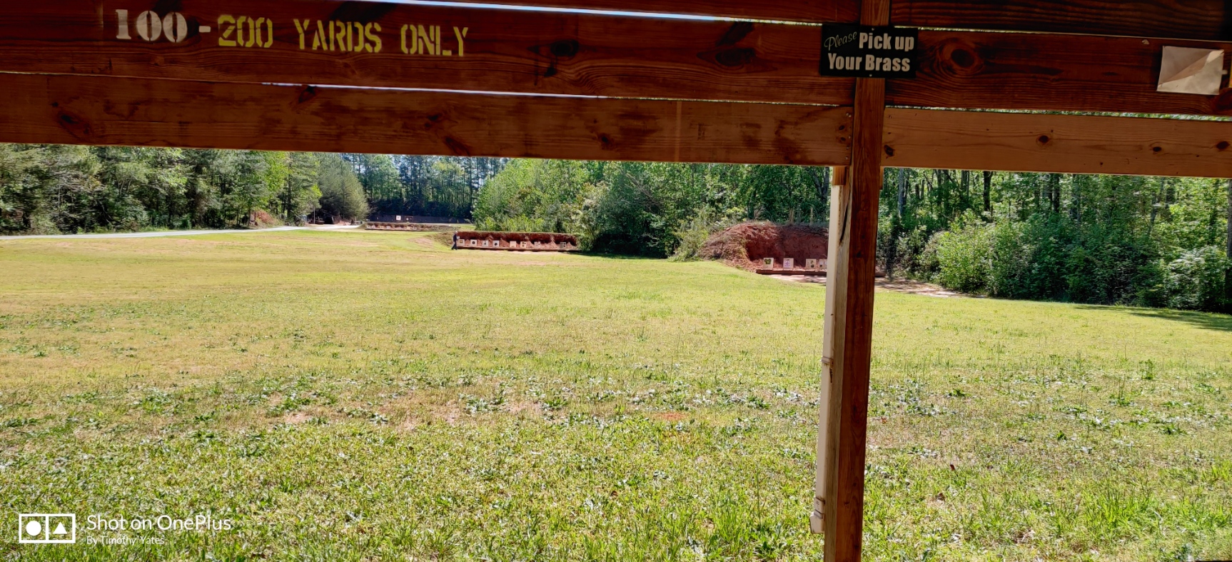

Here's the range. At the 300 yard line there's a 24" and 10" steel gong. I hit the 10" plate 9 out of 10 times with the "bitch to feed" CCI SV. From left to right you have the 50 yard, 100 yard, 200 yard and 300 yard. The white speck is the 24" steel plate.

The barrel was probably good to go from the start even though the feed ramp did look kind of crappy. The real issue is how the T1x feeds ammo from the magazine. It works great now. I am using a fired .223 case. I do believe overall the Win 52D chamber is more accurate than the Calfee 4. I make that statement for my two rifles, others may have a different experience. Glad you enjoyed the writeup.

In the five plates/targets above I shot fifty 5-shot groups at 55 yards with five different ammo types. That's 250 rounds back to back to back. BTW, Midas + was shot last. Out of those 50, 32 were 3/8" or better, 46 groups were 1/2" or better. Is that not consistency at its finest? With those kind of results I have to start questioning myself, "do I really need a Vudoo or Deuce or RimX"? I get 100% feeding, 100% extraction and ejection plus I get the accuracy. I have approximately $1,350 in my T1x, not including the scope. I see a lot of great groups on here and RFC but nothing that would compel me to pay $2500 for a complete rifle.
