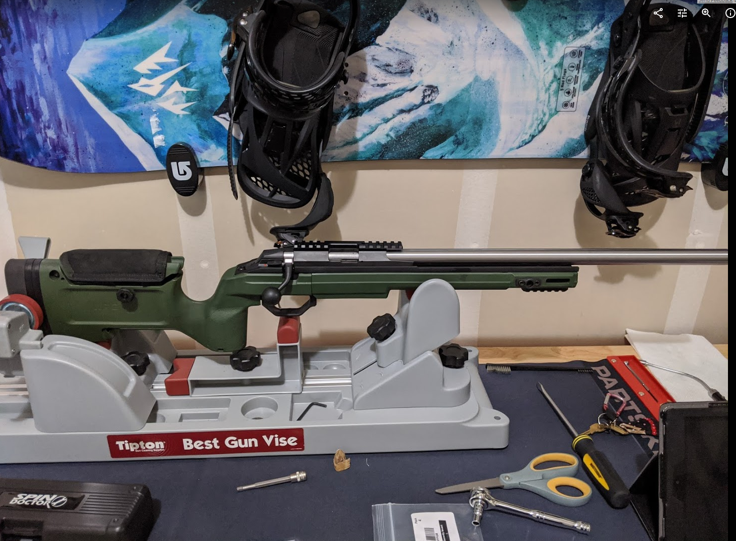

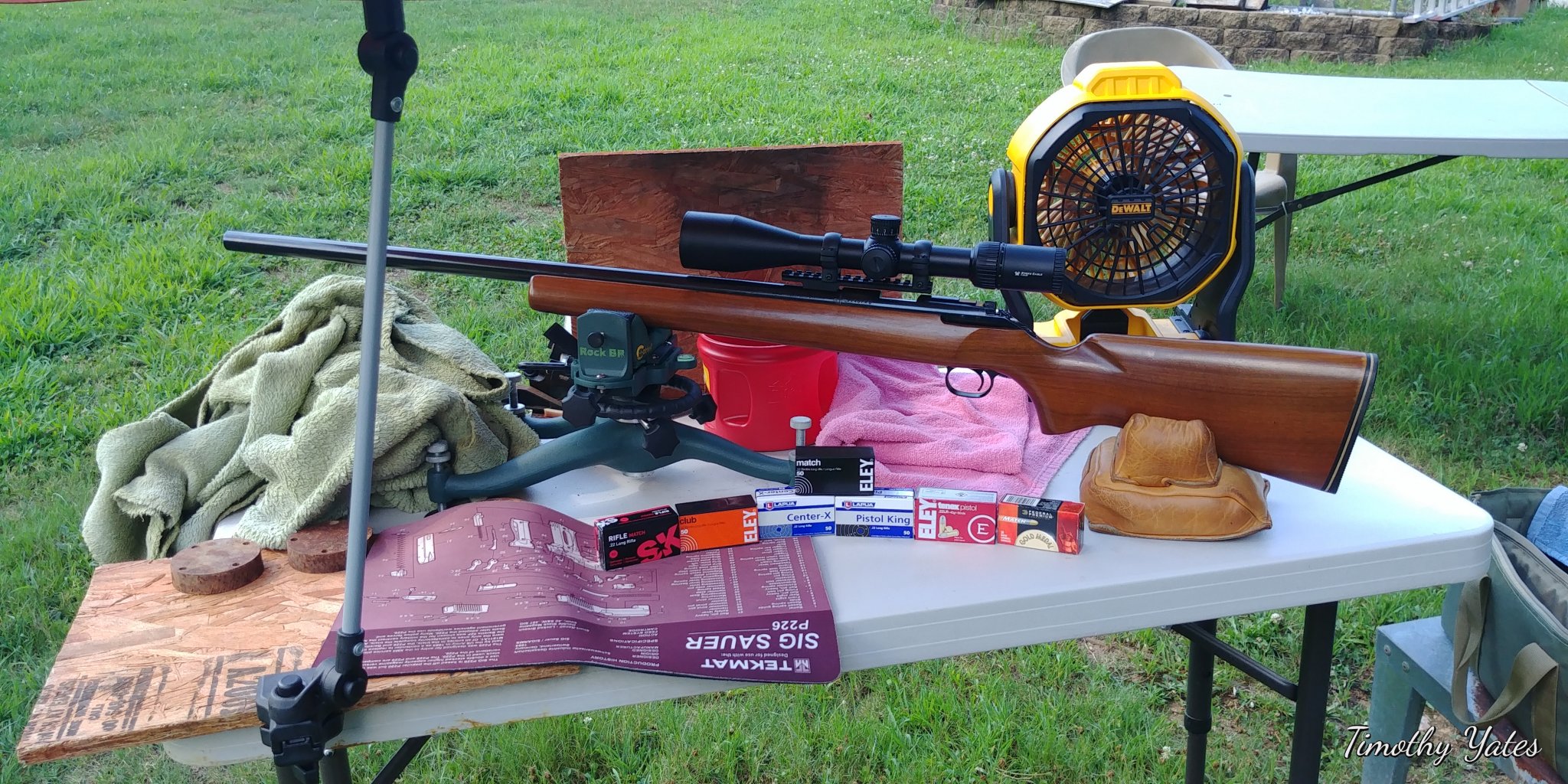

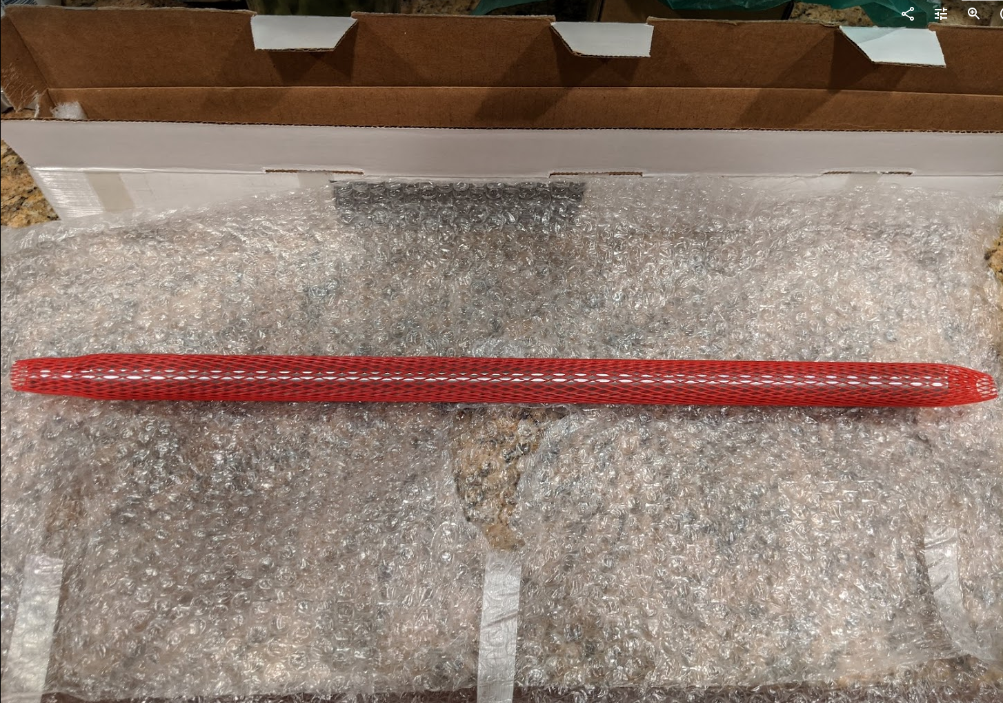

IBI barrel for Tikka is here. Maybe first in the US.
Next up is a toss up between Eley Match and SK Rifle Match. I'm giving it to Eley Match simply because I shot two great targets but only shot one target with SK Rifle Match. Remember these are with the shim under the barrel, I shot more SK Rifle Match but it wasn't good and I only had one box left to shoot with the shim in place.

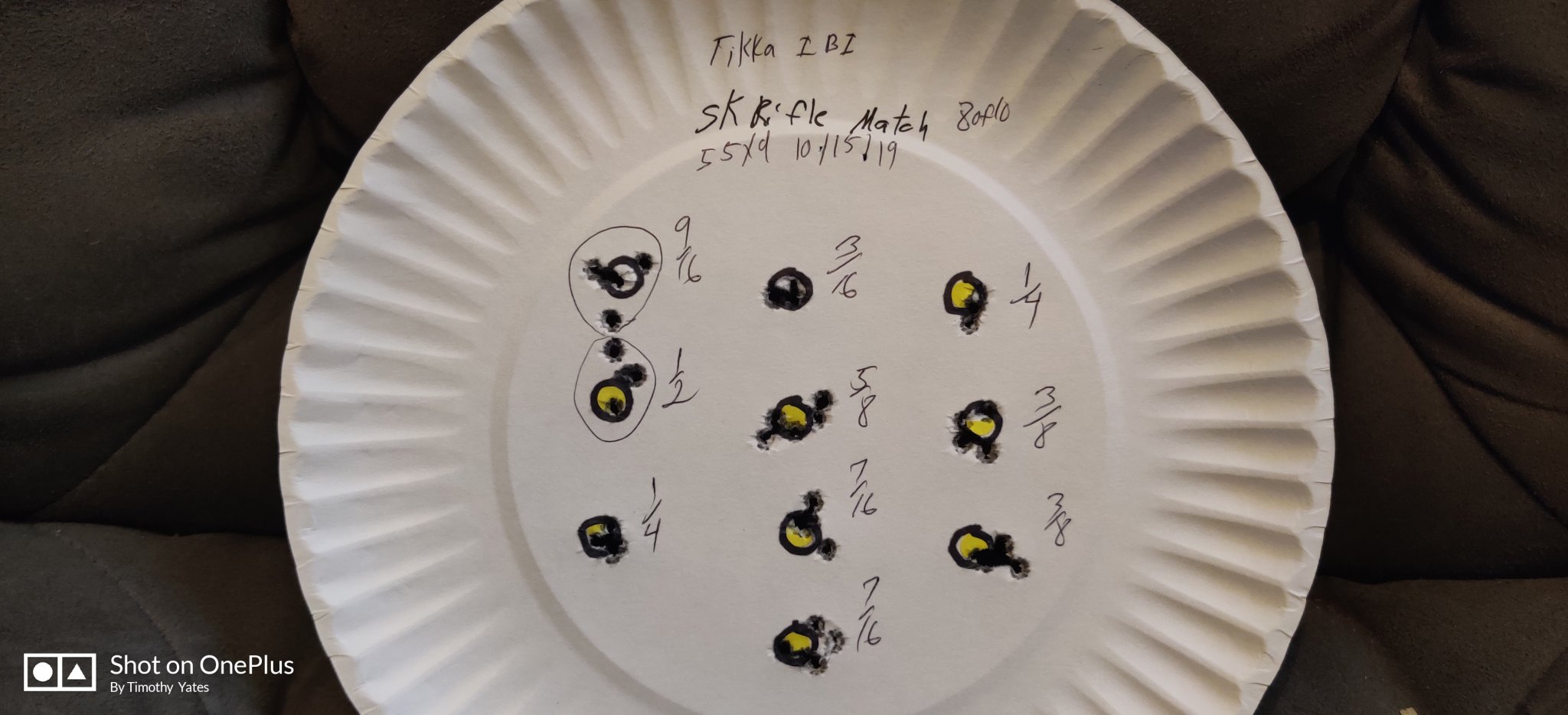

SK Rifle Match. This is a cheaper bullet costing around $7-8 a box.I had a couple of bad groups but a 3/16", two 1/4", two 3/8" groups definitely warrants further testing. I will by buying more of this.

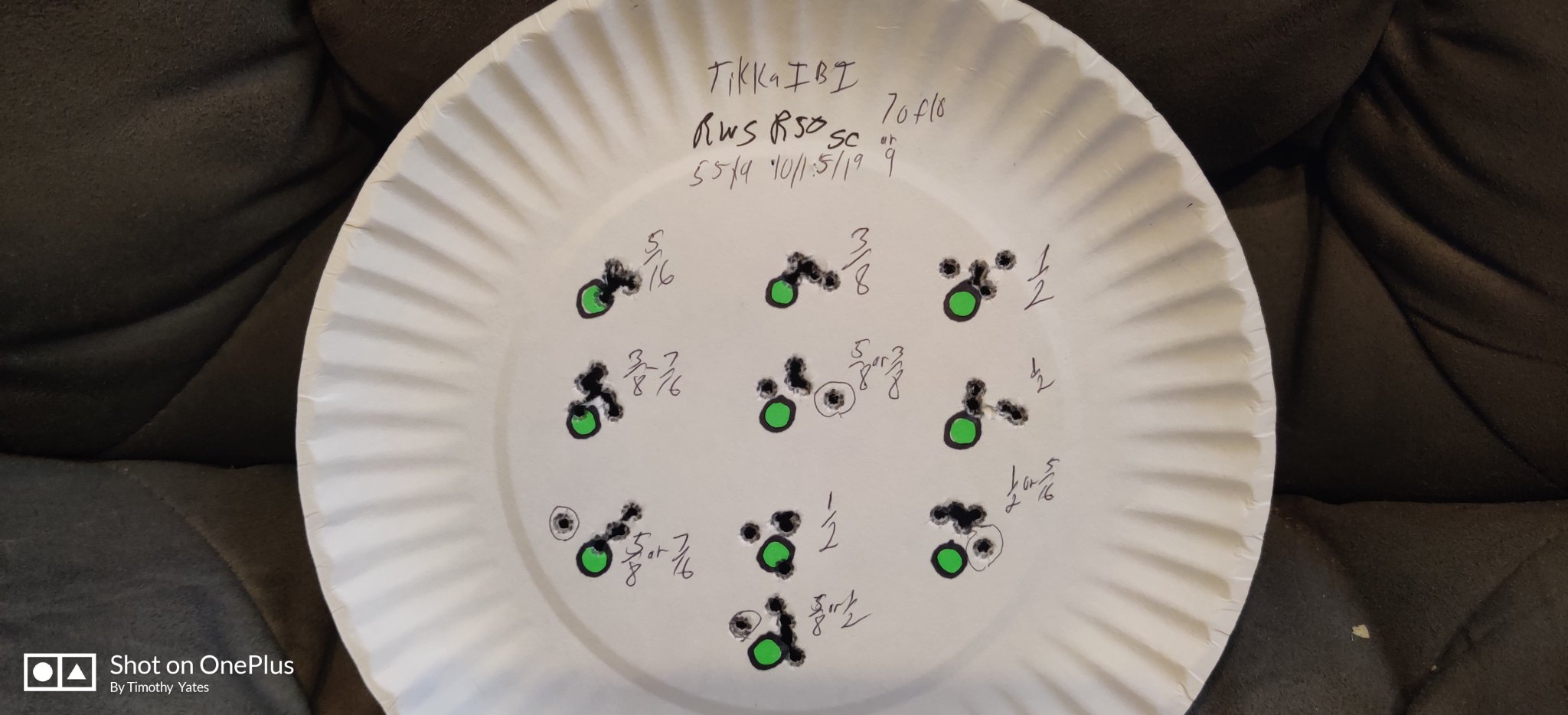

Next up is RWS R50sc. This is an expensive ammo, I've seen it anywhere between $15 and $20 a box. I bought mine on sale at SWFA for $10.81 a box.

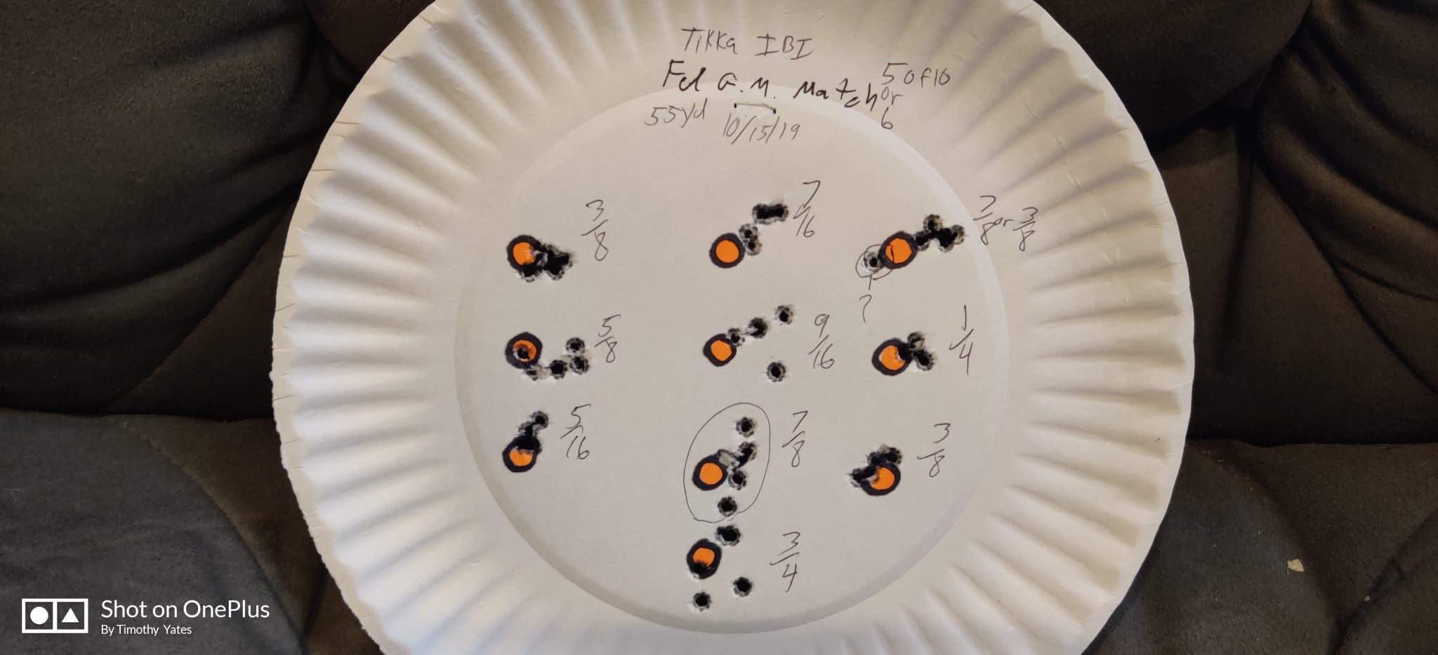

The rest of the ammo groups are all about the same. I do want to say that the Flatnose bullet by SK does have a unique tip profile compared to the others. It appears that the Basic shot as good or better than the Match at $2 box cheaper. The biggest disappointment was in the Eley Team. To be a fairly expensive ammo it really shot bad, just bad. Not sure what "ninch" Eley is trying to fill or sell to but I won't be buying any more of it. The CCI SV was hard to lock the bolt down. CCI has been like this the entire test period. I won't be shooting CCI in this barrel any longer. SK had a very small percentage of hard bolt closures but nothing to be concerned with. Everything else chambered with ease. Another thing to point out is that I had zero malfunctions of any kind throughout this entire test. That's at least 1300 rounds of feed, extract and eject to perfection. I also checked several bullet tips after chambering and none were damaged like you see sometimes with denting the tip, scraping at the drive bands or scratching.

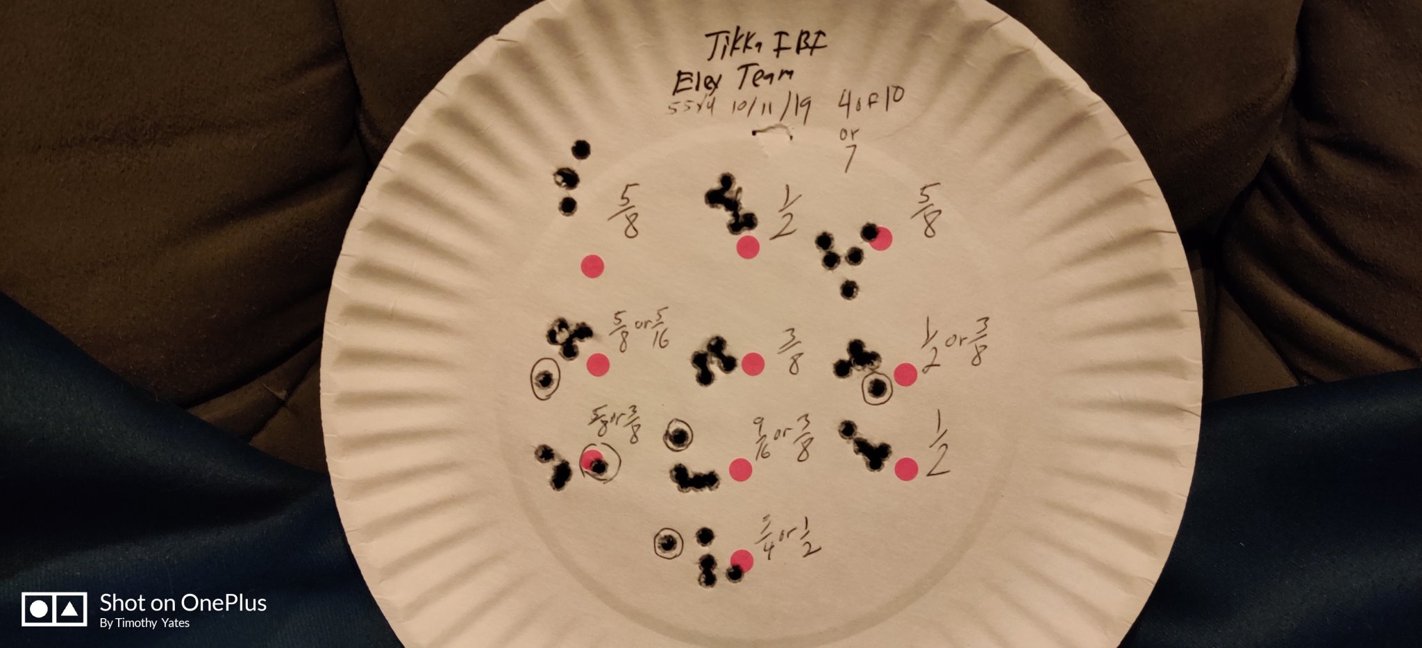

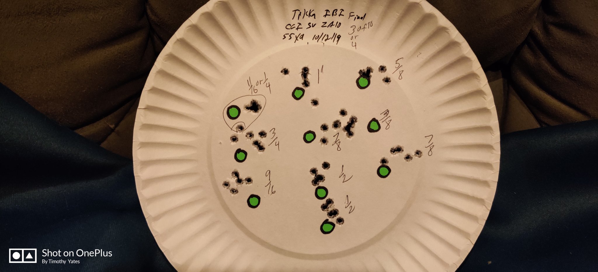

Final conclusion. I am happy with the barrel I have AFTER putting the .003" shim in place. I would hope that IBI increases their barrel diameter but others already shooting this barrel my say theirs shoots fine as is and that's great. I would like to see IBI put out barrels in 17 HMR and 17 HM2, if they did I would be buying one of each. I believe this barrel to be accurate with a variety of ammo and extremely accurate with a few. I believe the IBI barrel to be on par with my 1813 and 1710 Anschutz, the two Sako P94S, the Kimber SVT, Winchester 52D and the Tikka #3. I'd say that's pretty good company to be in. I would highly recommend this barrel to anyone who is not getting the accuracy they desire from the stock barrel.

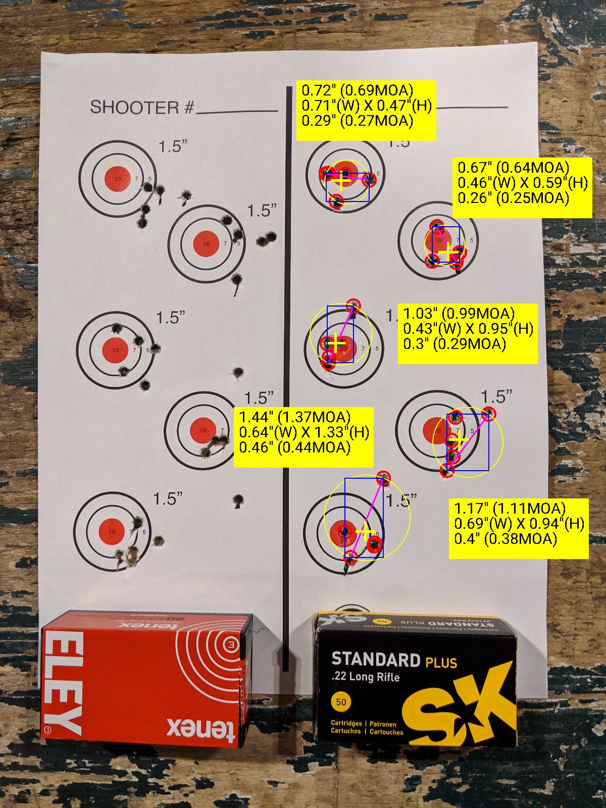

Got to the range today with a couple of boxes of ammo. Mainly wanting to confirm headspace and re-zero the scope.
I headspaced with Eley Tennex (left that ammo at home). Left the Lapua Center X at home to try another day past 100 yards.
Took some CCI SV to check the action and zero the scope and some SK Std+ to see how the barrel likes it.
The SK is reasonably inexpensive and I was hoping it would be good for general shooting. I have a couple of bricks of it.
Temp 11°C (52°F), no wind. Bag rest front and back.
The CCI SV was a bitch to chamber but it got the scope on paper. The SK was smooth to chamber, no issues at all.
Once zero'ed did five shots with the CCI. 3/8" - Not bad for pretty standard/cheap ammo.
Then did a few groups with the SK Std+ (first target not shown I had to adjust 1 click from the CCI sight in).
Std+ best group at 50 yards pretty much same hole, worst group under 3/16". Happy Happy Joy Joy
Took it out to 100 yards and shot a 4 shot group just over 3/8" - 1 shot to test scope holdover.

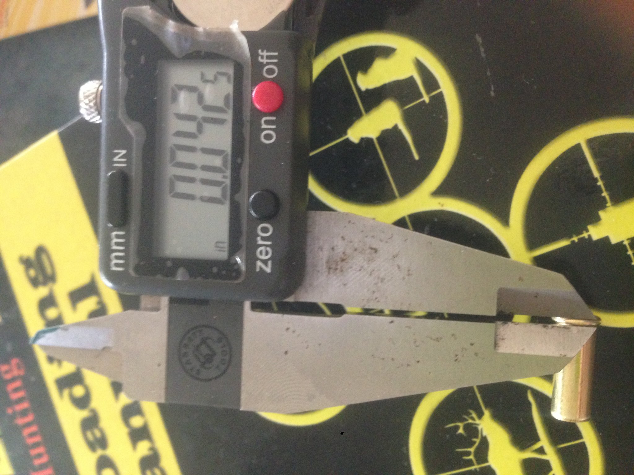

Measurements were taken edge to edge after zeroing my calipers at .224
These were not cherry picked, I wasted 8 shots sighting in and switching from the CCI to SK and those 2 targets were binned.
Have a box each of Eley Tennex and Eley Match as well as 2 bricks of Lapua Center X to try out at some point.
This barrel certainly likes the SK Std+.

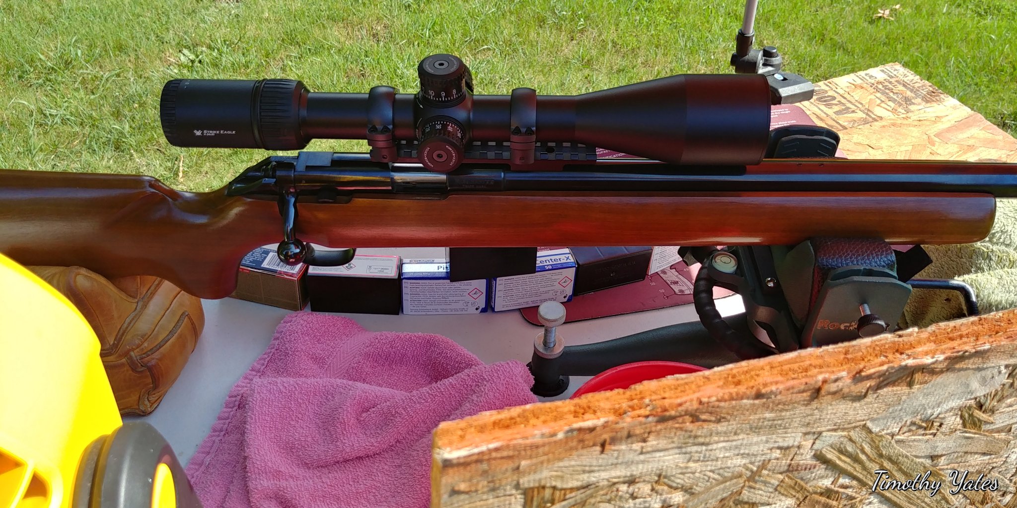

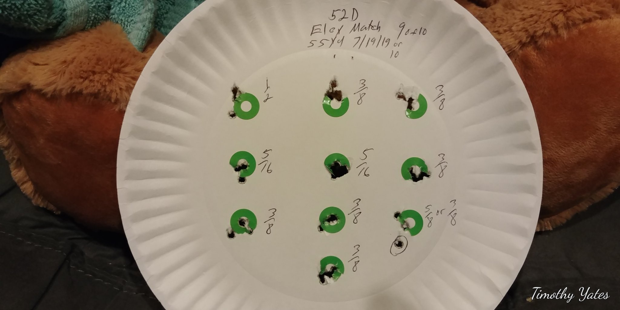

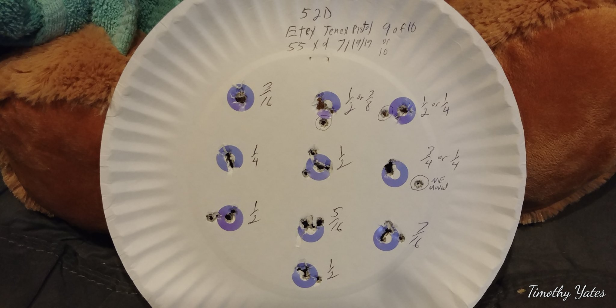

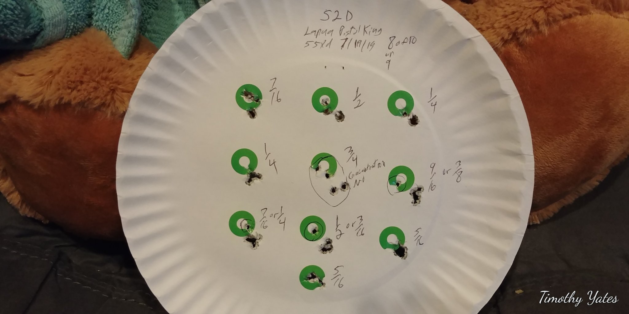

Here is my 99% 1964 52D along with a few targets with different ammo. Obviously not every ammo shoots this good in it but it gives you an idea of its capability. Of course none of this is any guarantee that an IBI barrel with a 52D chamber will shoot any better or worse or the same. Keep in mind, it doesn't take a lot of movement to turn a 1/4" group into a 1/2" group.

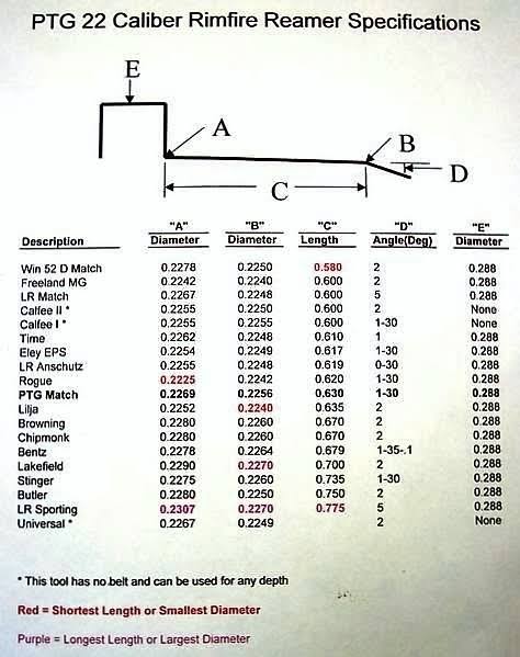

PT&G reamer specs, the 52D is not as tight at the base, will engrave the bullet a fair amount and has a two degree leade. With a good quality barrel that should translate to a chamber that will feed well in field conditions and shoot most types of ammunition well. Though not completely optimised for a certain bullet, ie centre X.
I don't think you will be disappointed.
Dimension "C", the Length is what I was referring to as being the tightest.

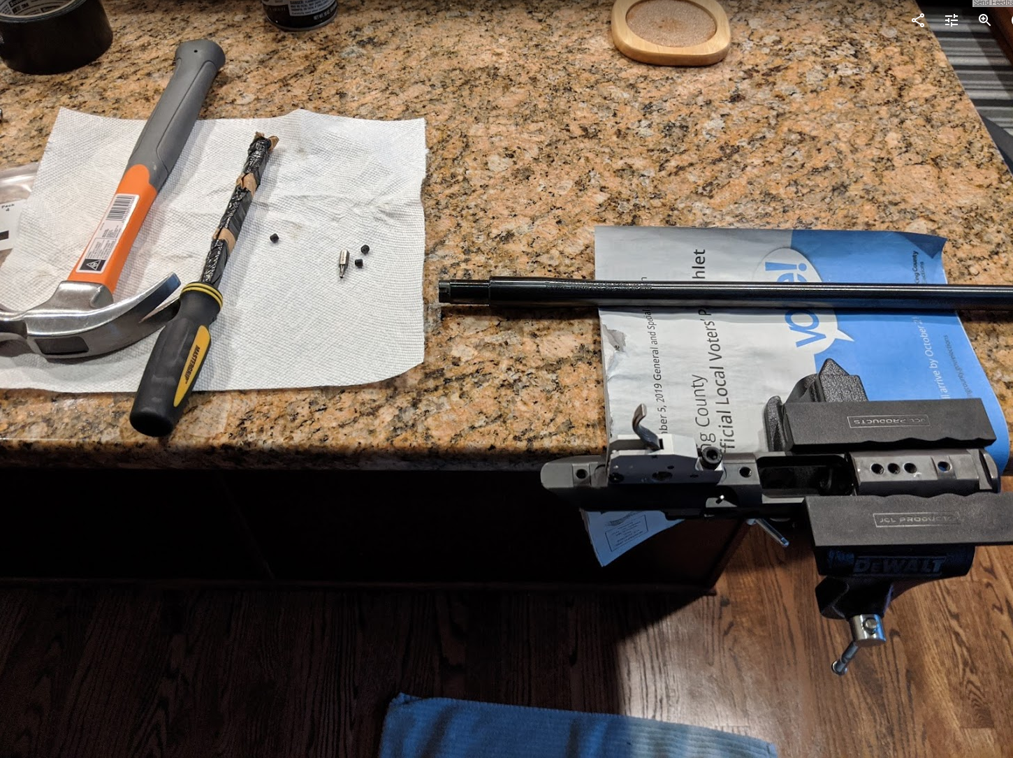

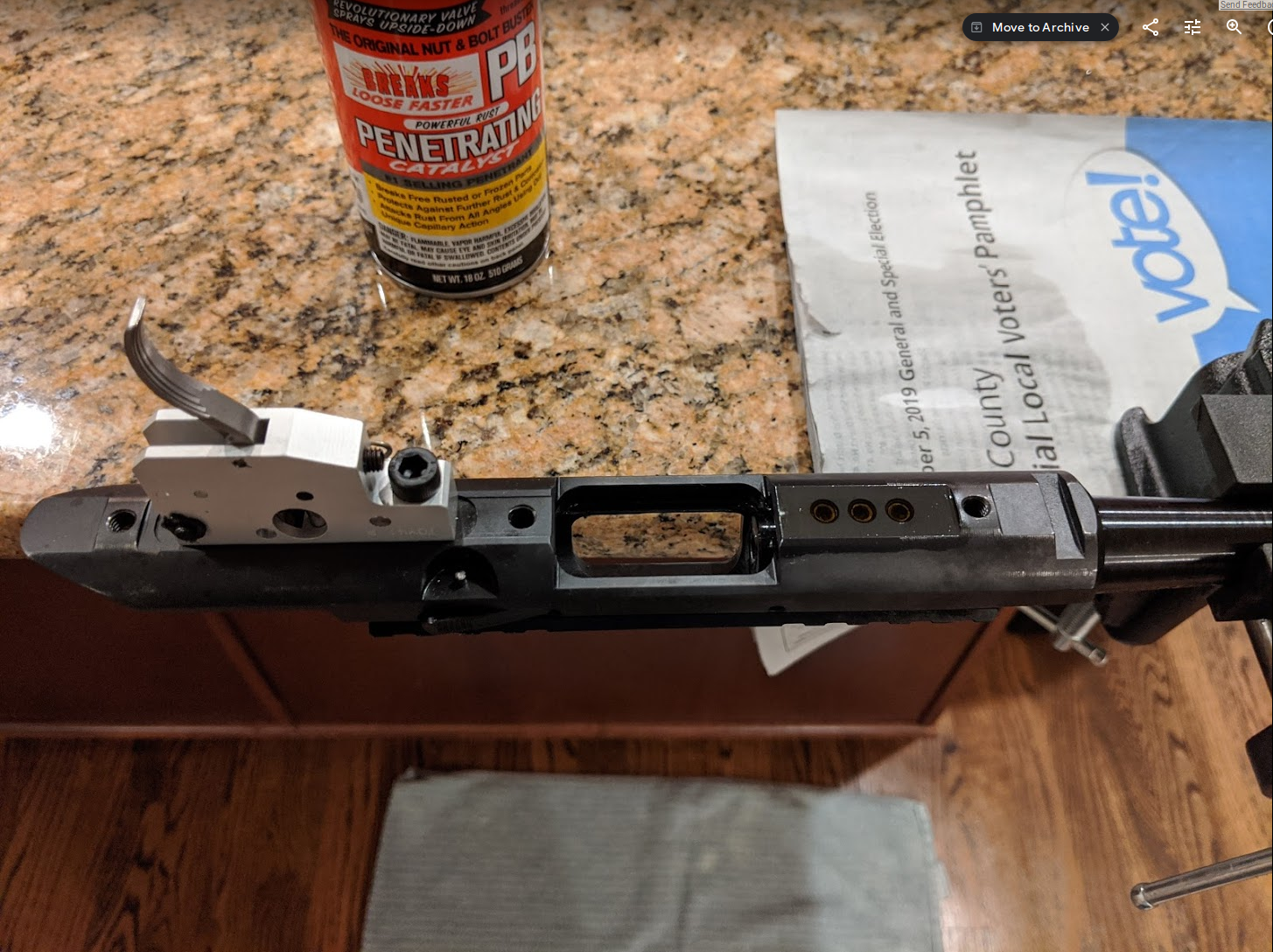

I got mine in - stainless bull barrel 20" 3.25 lbs.
Heat gun, then soaked in PB Blaster over night.
Barrel came right off in the morning. Minimal force required for screws, barrel wouldn't budge. I used the heat gun to heat up any glue/compound around the barrel. Then I took a hammer and a screw driver and tapped it out.
New barrel installed... I wanted black, but this will look nice in the new MDT chassis... needed higher rings for the scope caps to clear the new barrel so I'll do that later today. I rushed to the range and headspaced it. Winchester 52D chamber was pretty hard to seat a round. I need to really push forward with some oomph to get it seated. I tried to widen up the headspace but got a bunch of no fires. So I put it back... SK ammo seems to chamber easier than Eley.

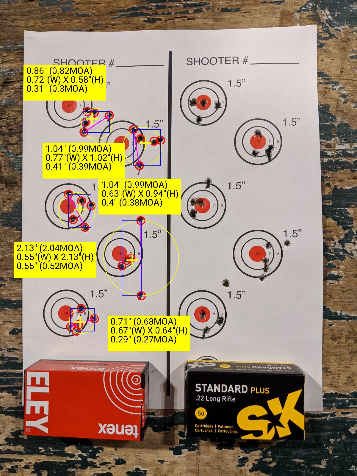

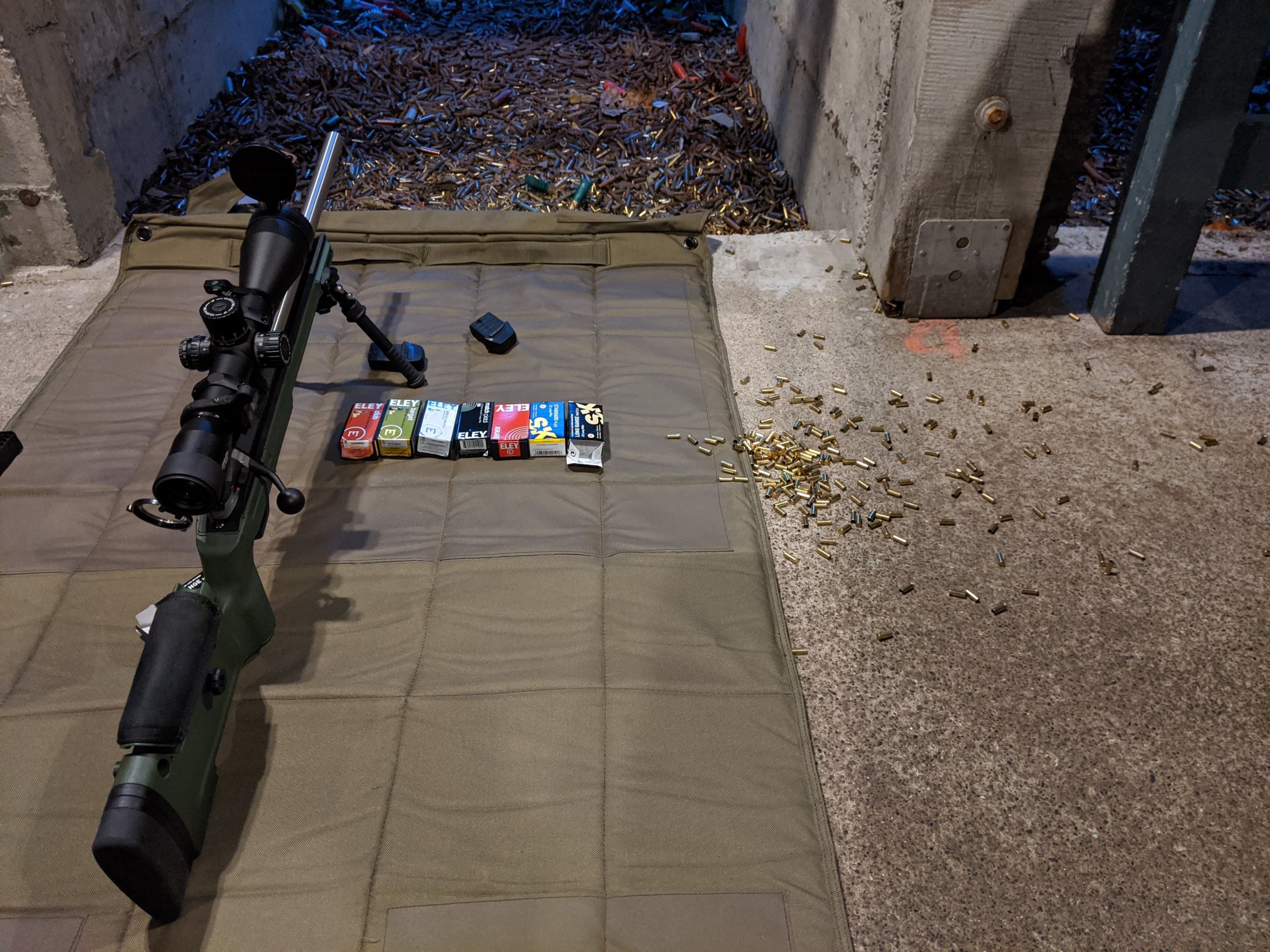

Alright, went back to the range and started my groups. I'll post separate pictures of everything, but here's the aftermath. I shot 7 rounds of ammo, 30 rounds each. 5 fouling sharts / test POI, then shot 5 groups of 5.
General summary is my Tikka factory barrel shot almost every ammo the same, and it seemed to like Eley. As I progressed through the Eley Line it would do Eley Target 1.1", Eley Match, .9", and Eley Tenex .75". This new IBI barrel the the Eley groups were 20% larger. So 1.2-1.3" for low end ammo, 1" for Match, .9" inch for Tenex..
I switched to SK ammo, and it did better than my factory Tikka. SK+ generally shot 1.1" and SK LRM it didn't like before. With the new barrel I was getting .9" with SK+ and .8" with SK LRM. I'm curious what Rifle Match / Center-X will do...
I shot 6 groups of Eley Contact because it started shooting well and wanted to see maybe it needed extra fouling to get going.. The random group in between the last 2 was my 6th group. I am curious if I want to go shoot another 100 rounds of this to really see if it's a winner, but the other Eley ammo just didn't hold up for their price.

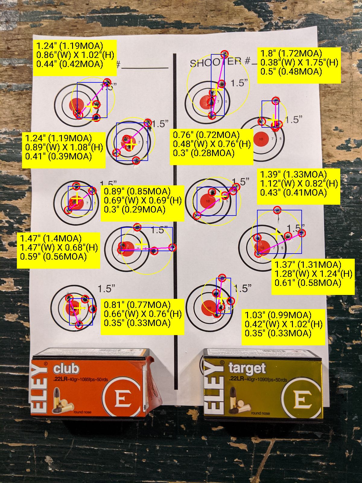

Tenex for $18 a box, didn't perform as well as I had hoped. This shoots .7" groups in my Ruger and the Tikka Factory Barrel. If I exclude the group with the high and low shot, the overall average isn't bad. But I want better for a $325 barrel investment.

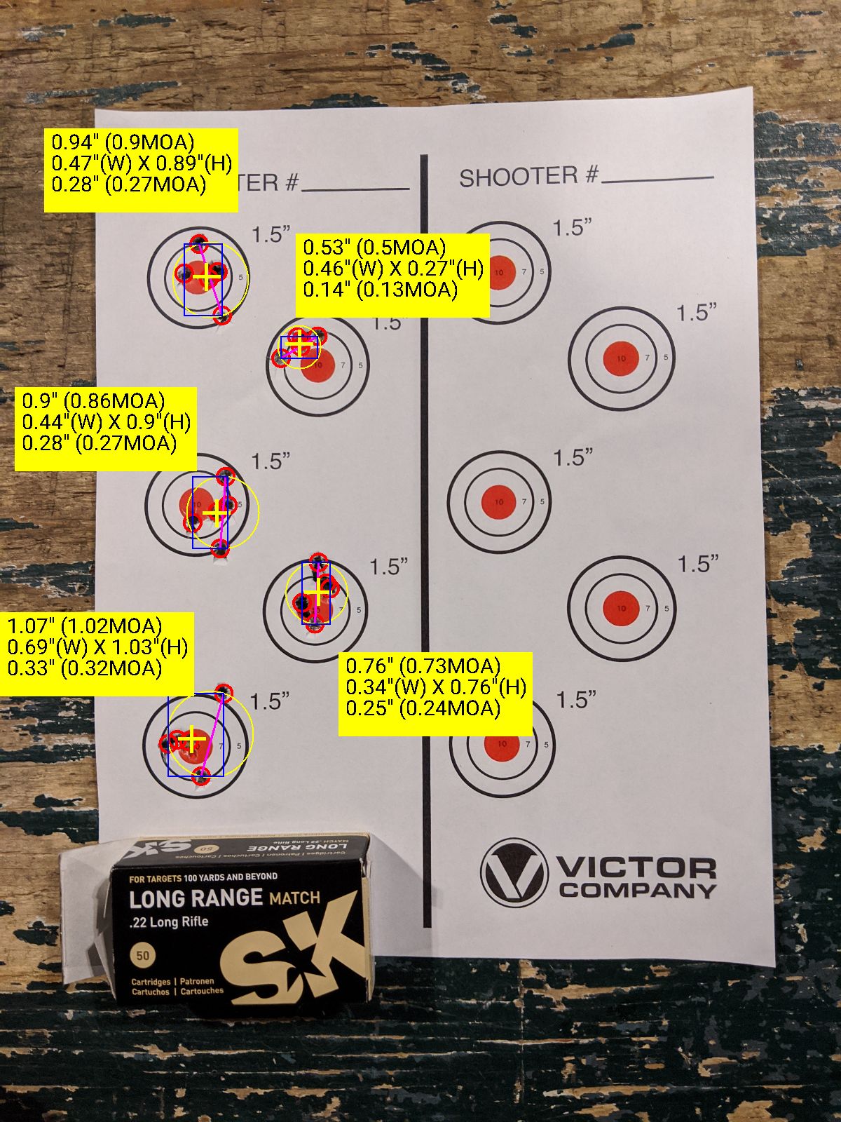

Lastly I switched to some of my few remaining boxes of SK ammo, SK+ and LRM. $5 a box for SK+, and 7.50 for LRM, which puts it significantly cheaper than Match, and Tenex... I'm pretty happy with these results.

I'm going to get a few lots of Center-X and SK Rifle Match, and Pistol Match Special to see how this performs. I think evidence shows that it's just not a Eley shooter. Now I might have some headspacing issues... the tight chamber of Win 52d, I do have to put some oomph into loading rounds... loading into a bipod wasn't a problem to cycle a round, but on a barricade, that might be rough. I might have to re-headspace it, but I'm pretty new to doing all of this. When I loosened up the headspace I was getting light strikes.
