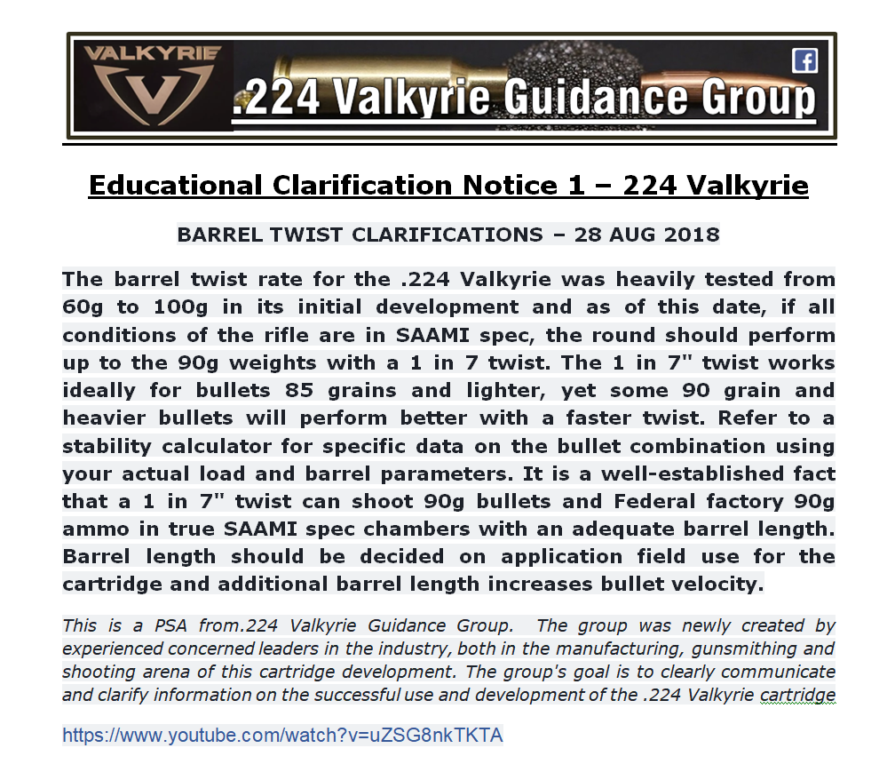

I have a Dtech Valkyrie Shilen Match Select Upper that has a 1:6.5 twist. It appears that most of the manufacturers are settling on the 1:7 twist as the standard. I want to ultimately get a bolt gun in the the Valkyrie configuration - (old fashioned shooter who likes bolt actions for long range shooting!), but am wondering about the best twist rate for shooting a wide range of ammunition. Any reason to try and get a barrel with a 1:6.5 twist versus just staying with a 1:7?

You ought to have mentioned you weren’t talking about SAAMI Valkyrie.
Don’t know about SMKs but VMAXs, Blitzkings and similar have been ok for me at 360,000 RPM. Same for the army.

I would likely try 1:7 personally.
I don't know what the Valkyrie is capable of for speed, but I have shot 90gr vlds in a 22" 22-250 at 2800-3000fps in a 1:8 twist rock Creek and they're stable and accurate past 1200.
