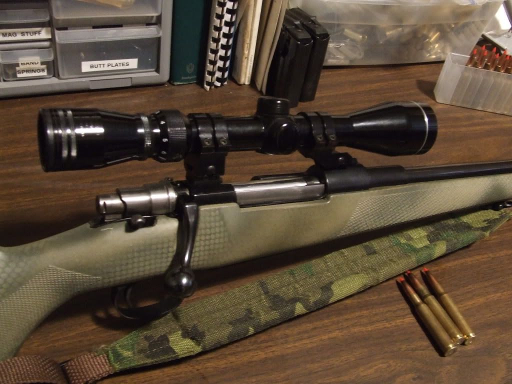

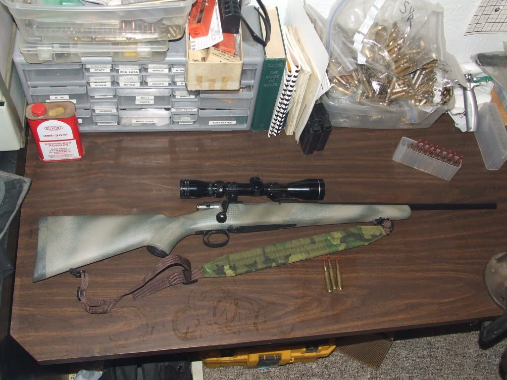

Boyd stock , Bold trigger , cocking piece , lugs done , new factory barrel in the white when I got it and funny story on the scope... When I got this done I had no glass but wanted to shoot her ! I put a tasco 4-12 I yanked from a gunshow score on her and I was at an inch from the get go....I left it there ever since and am now at .5 with handloads . A sheer delight to shoot and I have killed a mule deer , a bear and a coyote with it this year .
