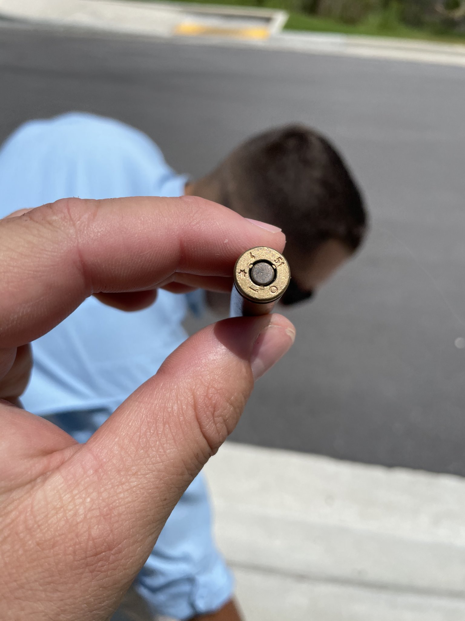

Bringing up a old ass thread. But can anyone identify. I’ve tried googling but so far no luck.
