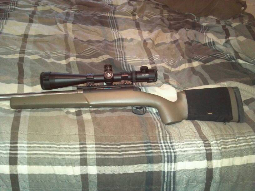

I'd be happy with an A2 version for tikka t3. The only b&c i have is an older4.25" a2. I spent a couple hours with some fiberglass mat and resin, grinding and sandind. My results were a stock that has a mcm a3 type forend instead of the 4x4 factory forend.
I took a b&c for a short action and filled in the front hole drilled a new hole and milled in a new recoil pocket. Later i got sick of the huge fore end and cut that down to size. None of the work was difficult, just time consuming for any of you that feel the need to give it a try. I did it in a mill but if you take your time it could be done with a dremmel and die grinder. Any imperfections get filled with epoxy anyway.
Here is what i ended up with.
