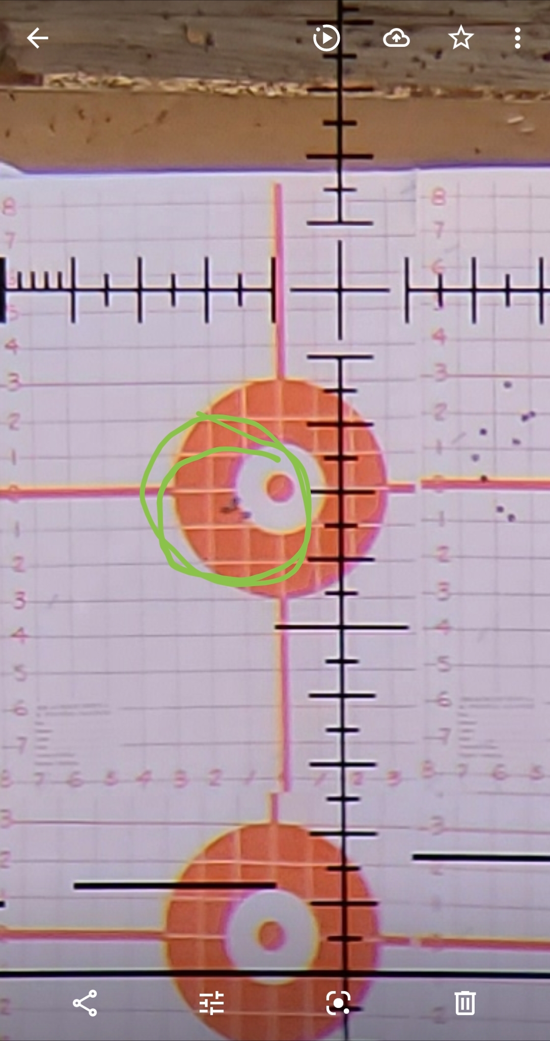

My 10.3" 1:7 SOCOM profile did the Green circled is 5 rounds 77SMK black hills at 50 yards. 1 inch squares
^^^^^^^^^^ I agree. We run 62gr bonded in our 10.3 patrol rifles, and they're not the best at all (wish we could switch). While doing some testing with different bullets the 77SMK's consistently gave us the best result. Our zero was 50 and walked it back to 100 yards plus, with good results still.
