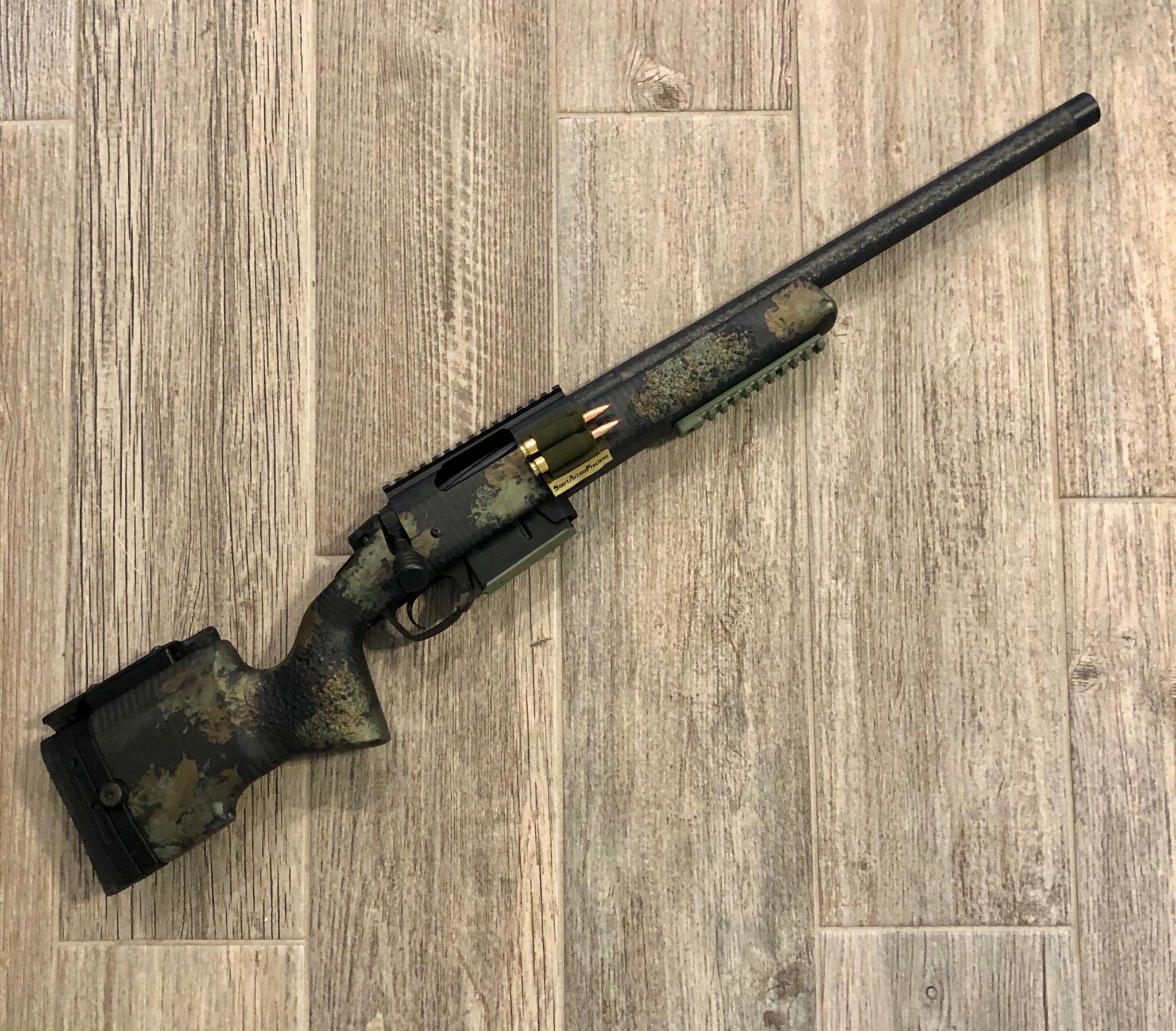

Those shitty low light cellphone pics don't do justice but here:
The short barrel chassis anTI sports the 12.5" bartlein 1:8 twist 300BLK. I originally planned to use my VX-6HD but once I started pushing this little rifle to 600+ yards with supersonic Speer 150 gdhp and 300 yards with 190 Sub-X it clearly wasn't enough scope so I put the Razor LHT HD 3-15x42. Fun fact, I had to hold 2 full mils of wind for 5 MPH crosswind at 600 yards
The Manners ultra classic one I went with the 204 Ruger in a Benchmark #1 taper barrel. I had to use the 20 moa rail because the Accupoint 3-9 has a huge eye piece do to the fiber optic and I couldn't get my medium talley rings to clear the bolt handle. I took that one to 700 yards this weekend with a Berger 40/27.0 gr XBR hand load but factory 40 gr vmax super performance does fine. It is a .75 moa rifle but the really lightweight barrel heats up fairly quick but it's a dedicated coyote rifle for 0-300 yards so it's perfect for what it is.
They're both below 7 lbs.
Still planning to get a 6.5 prc or 7 saum or similar prefit carbon fiber barrel next spring.

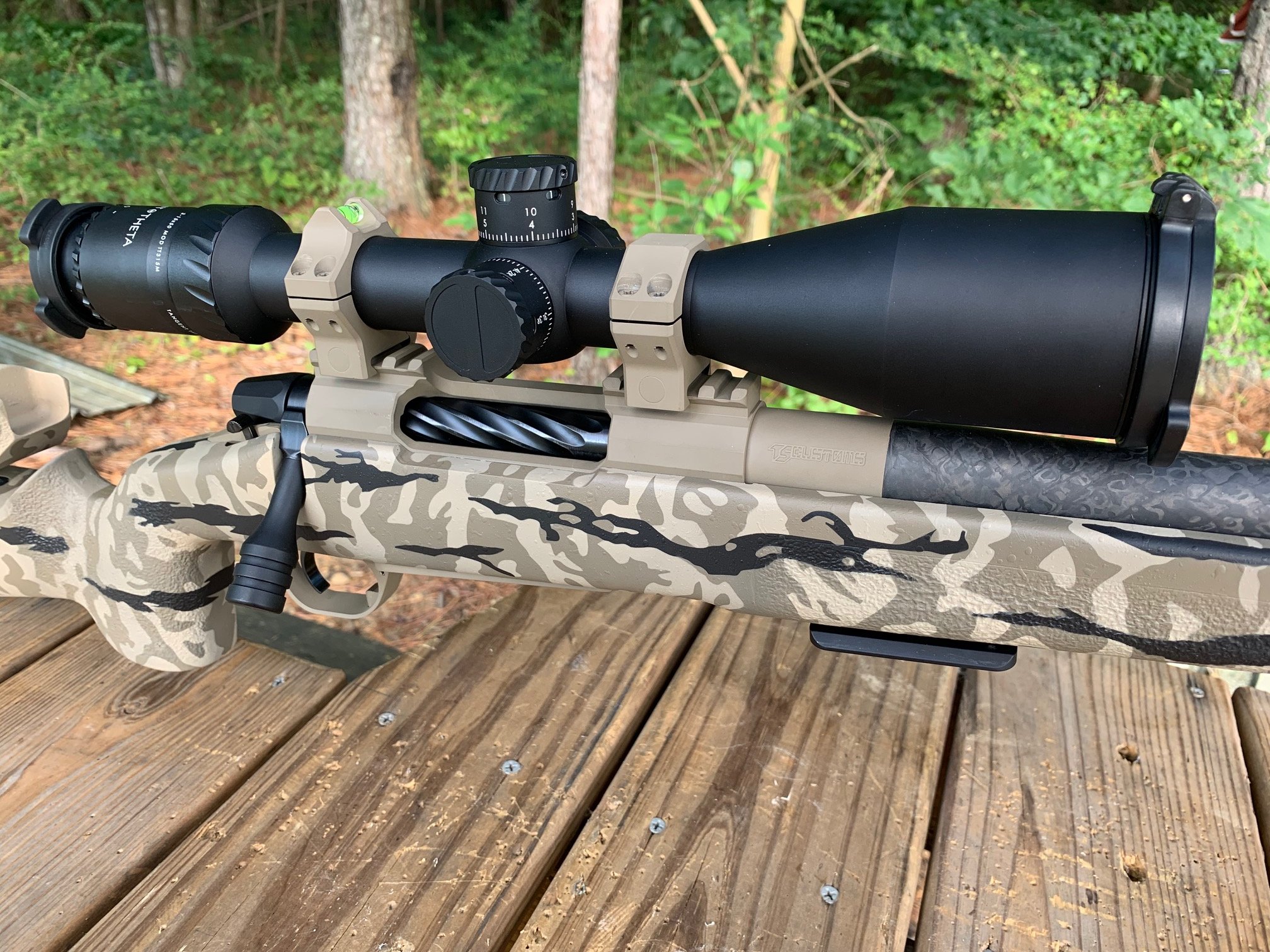

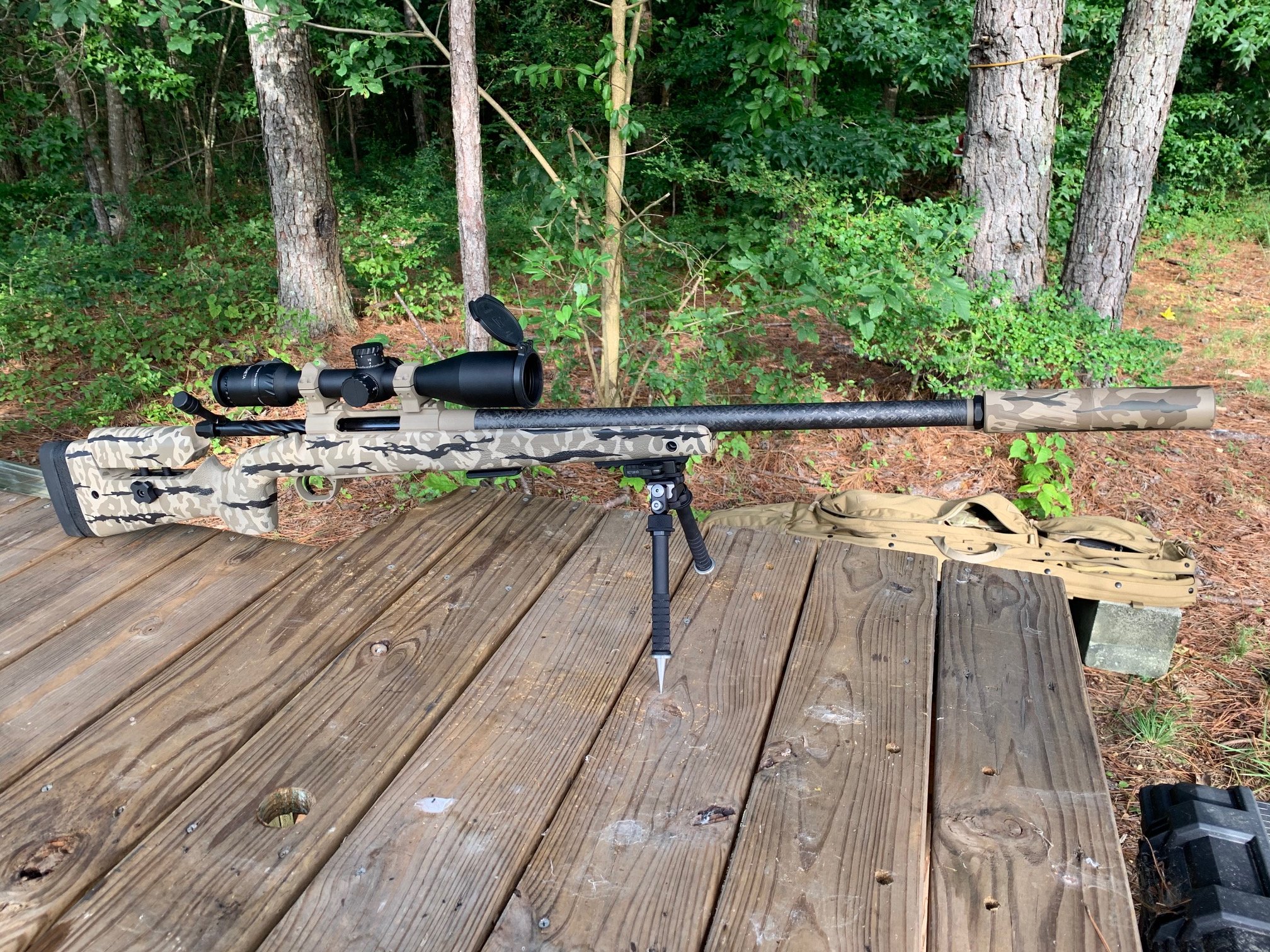

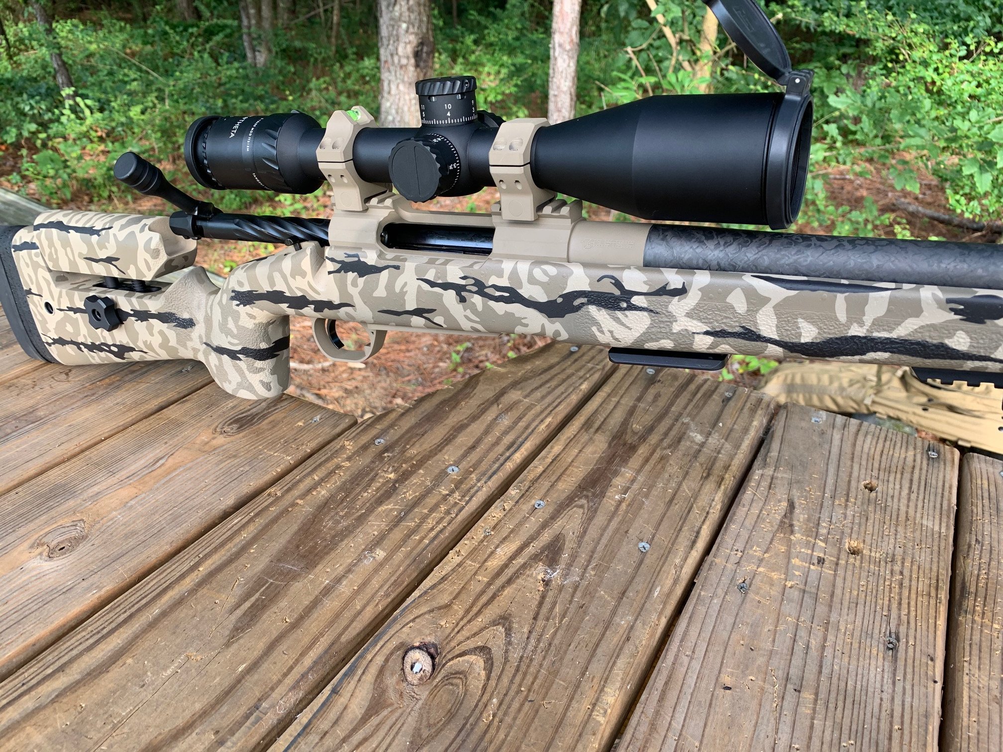

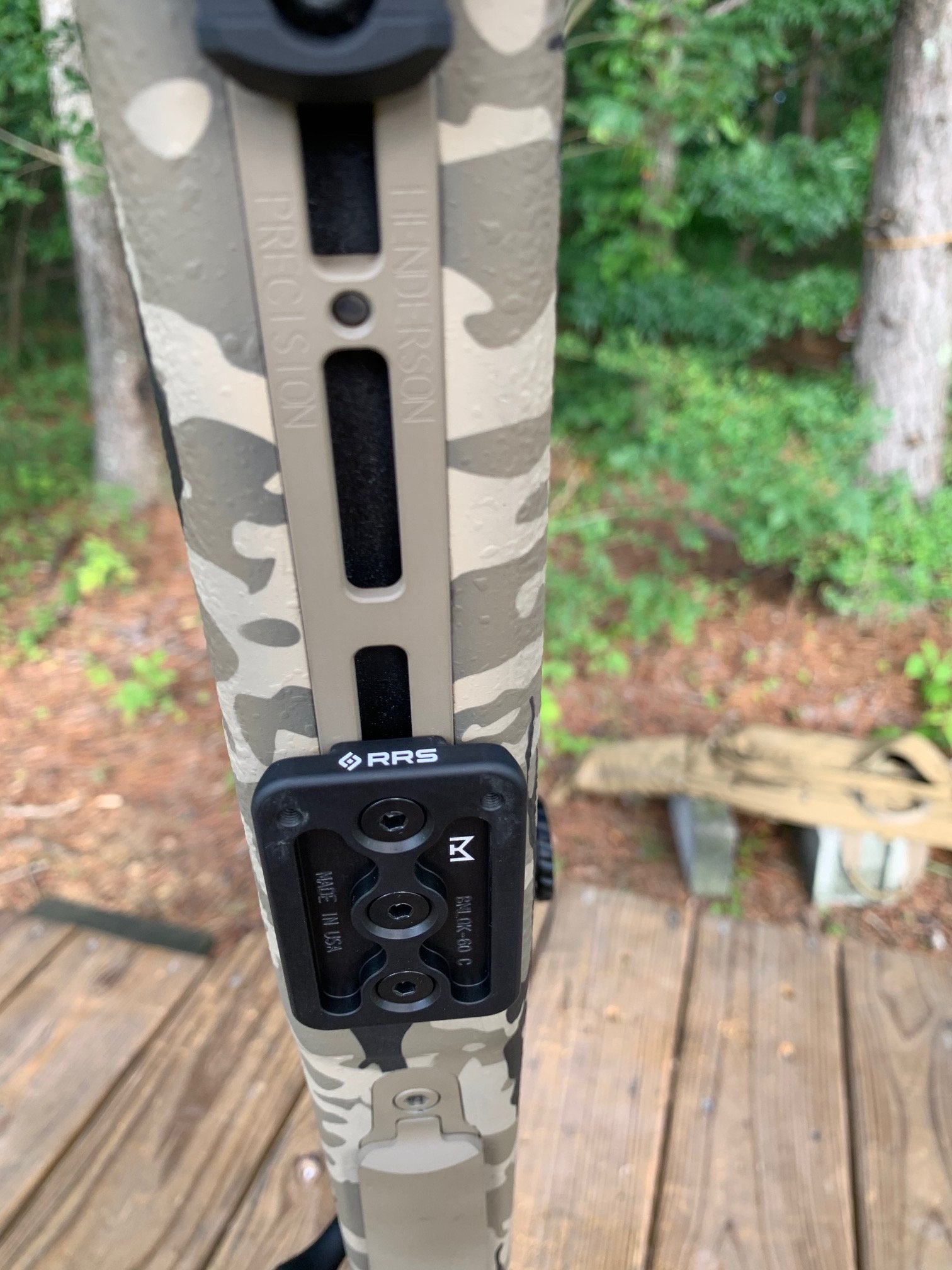

LP Ti mid action
22" Proof Carbon 6.5PRC
McMillian A3A Carbon
TT Special
Hawkins BDL BTM
TT 3-15M setting in Hawkins light Tactical rings
TBAC Ultra 7
Weights just over 10 Lbs
