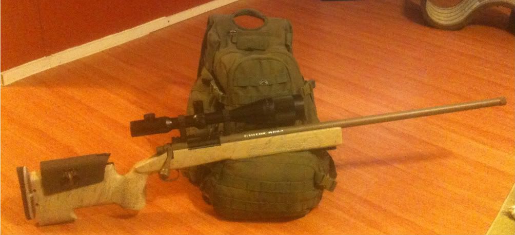

UPDATE: I ordered the picatinney rail and hardware kit from Accushot and ordered the Atlas Bipod from Triad. That seemed like the simplest, most efficient route. Should get the rail and hardware in this week and have it installed and then receive the bipod mid next week. I worked for a composite manufacturing aerospace company for about 6 years so this little project should be fairly straight forward and easy enough, especially after reading the link above. There are a number of things that I could've done to achieve my goal of mounting a bipod, but I wanted everything to maintain that "professional build" appearance just in case my financial matters tank for some unknown reason in the future and I have to sell my rifle. I'll do whatever I have to do to avoid that day, but I can't foresee the future, I can only prepare for it. You all know what I'm saying. Anyway, done rambling, went with the Atlas bipod and rail w/ hardware.

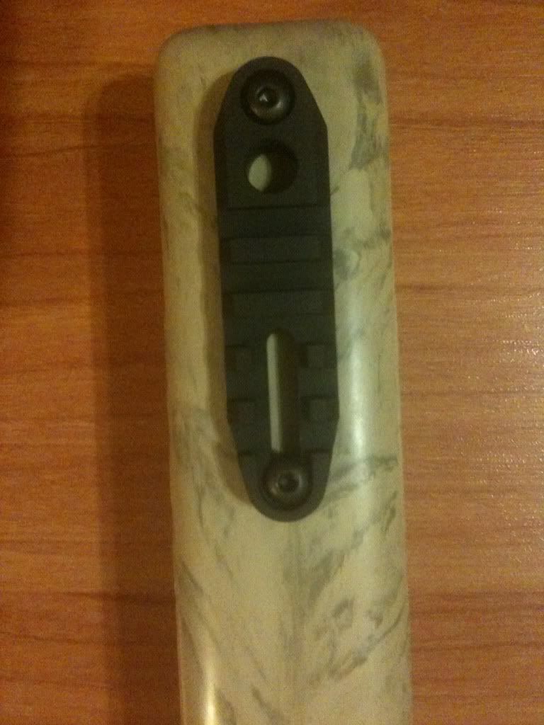

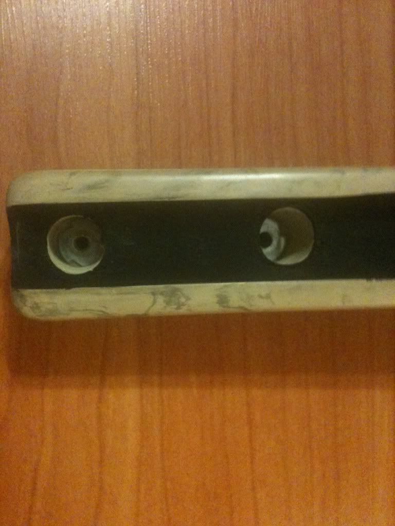

Got my rail and T-Nut kit in the mail today. Used a 3/4" forstner bit and a few various sized drill bits and had this thing installed in less than 10 minutes. Hopefully my Atlas bipod will come in the mail before next Friday.
