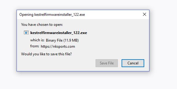

1.23 is if you can use the app. If you don't have the LiNK version and have to use the PC Software to perform the update, the latest you can get is 1.22.

That's what it seemed like to me, thank you for the clarification.
