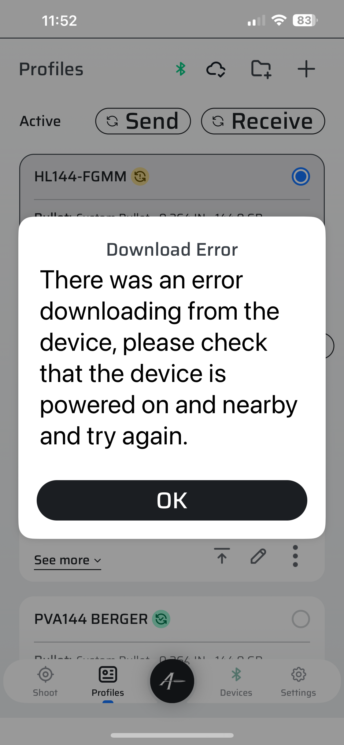

Yeah, no luck. Running the latest build for AB, Vectors are on their latest build. I've had issues with AB connecting up to my Fortrex as well when I want to push a profile update. Everything seems to be playing nice together except for AB connecting to my devices.

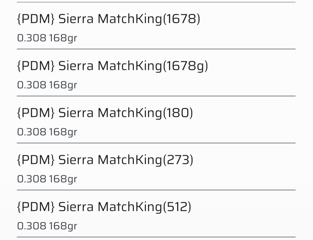

Why are there so many different PDMs for a single bullet, and how do I know which one to use?
168gr SMK seems to have 5 different options.
P=Personal, are as many as there are individuals who fired them across AB's mobile lab setup. While it can provide some interesting info they are only meant to be used by the individual who fired it.
The CDM are the ones to use.
Cheers!
That makes more sense, I found the correct one now.
