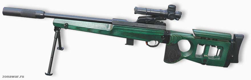

The one I want is the Ishmash 7-2 Biathlon Basic in 22lr (also available in 22WMR). 5-rd mag, and toggle bolt similar to the Anschutz Fortnier action (but not the same). MT Guns in Santa Barbara offeres a Lyman/Redfield Peep sight option. Prices run from $300-900 depending on our state of diplomatic relations with Russia. The one I want is the SV-99 model which comes with scope, suppressor, and adjustable sight. Now if we can only get Obama and Putin to play nice.
Irish

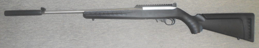

My 10/22 is setup almost like you're wanting, excepting the threaded barrel. To do the stock change, trigger upgrade, lightweight barrel, front sight parts and rear sight parts, I think I'm close to $700.00 in mine. If you get a steel barrel rather than lightweight aluminum, you could probably save $100.00 ish and hit your <$600.00 mark.
Here's some decent info on a few different aperture sights for the 10/22: Ruger 10/22 Peep Sight Roundup | Garp
Look at Stockys for stock ,mine fits me well and I'm 6 feet: *NEW!* Eliminator Ruger 10/22 Pistol Grip Thumbhole Laminated Riflestock Right & Left Hand
Threaded lightweight barrel: Ruger Rifle Barrel Upgrades Archives » Tactical Solutions
Front sight setup: 93 MJT AR-15 & MATCH RIFLES TARGET FRONT SIGHT | Brownells
.922" barrel band: BARREL BAND | Brownells with the proper front sight base adapter.
front sight: 93 MJT AR-15 & MATCH RIFLES TARGET FRONT SIGHT | Brownells
Rear sight: FP-AG-Tk Receiver Sight w/Target Knob fits Airgun : FOOLPROOF-TK RECEIVER SIGHTS | Brownells
Trigger kit: Power Custom Competition Rifle Trigger Kit Ruger 10/22 (Hammer Sear
