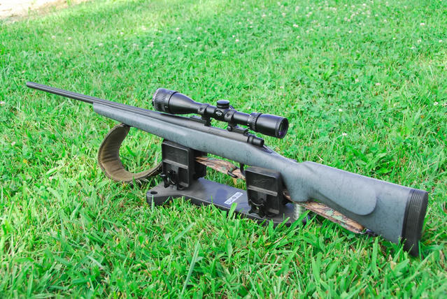

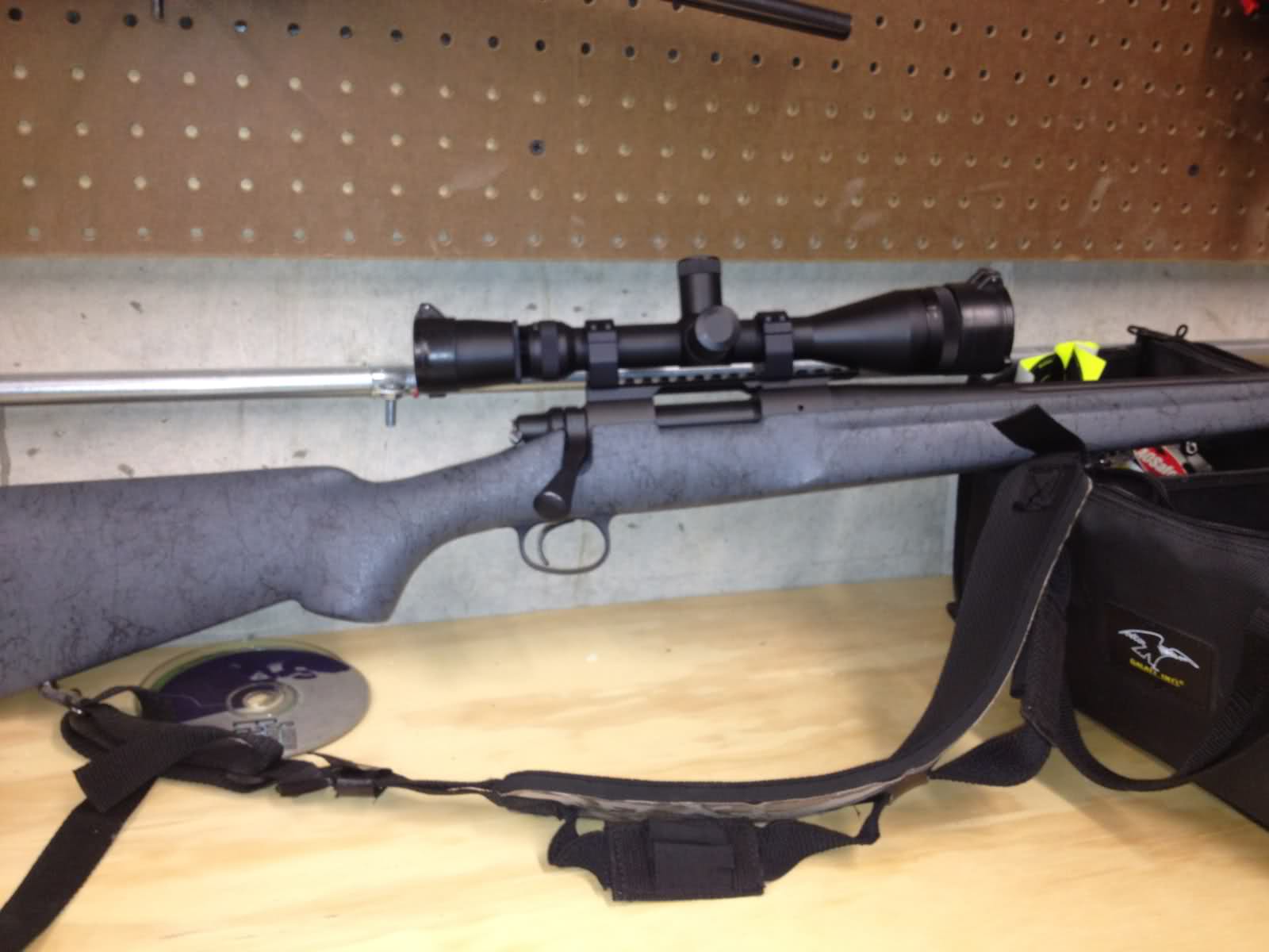

Here is that 700 tactical I was talking about...
