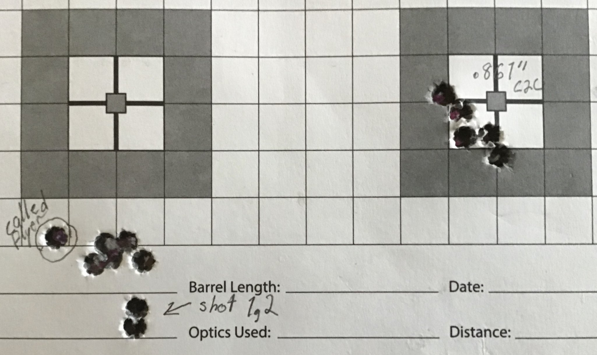

First target shot off my assault pack w/o rear bag (no brake). Clearly, I’ve got some issues with trigger control / recoil management.
Second and third target, from right to left. Second - on the bipod, rear bag. I don‘t usually shoot with crossed arms - more or less the same horizontal, but with vertical stringing added for flavor! Third target is the addition of the APA brake. This markedly different vertical POI was not unique to this target. Target 4, not shown, has also about .5 inches of horizontal with a full 1.5 inches of vertical. I think I varied leg length between some of these groups...
I am definitely riding the struggle bus...I just can’t seem to pick a seat, either.
