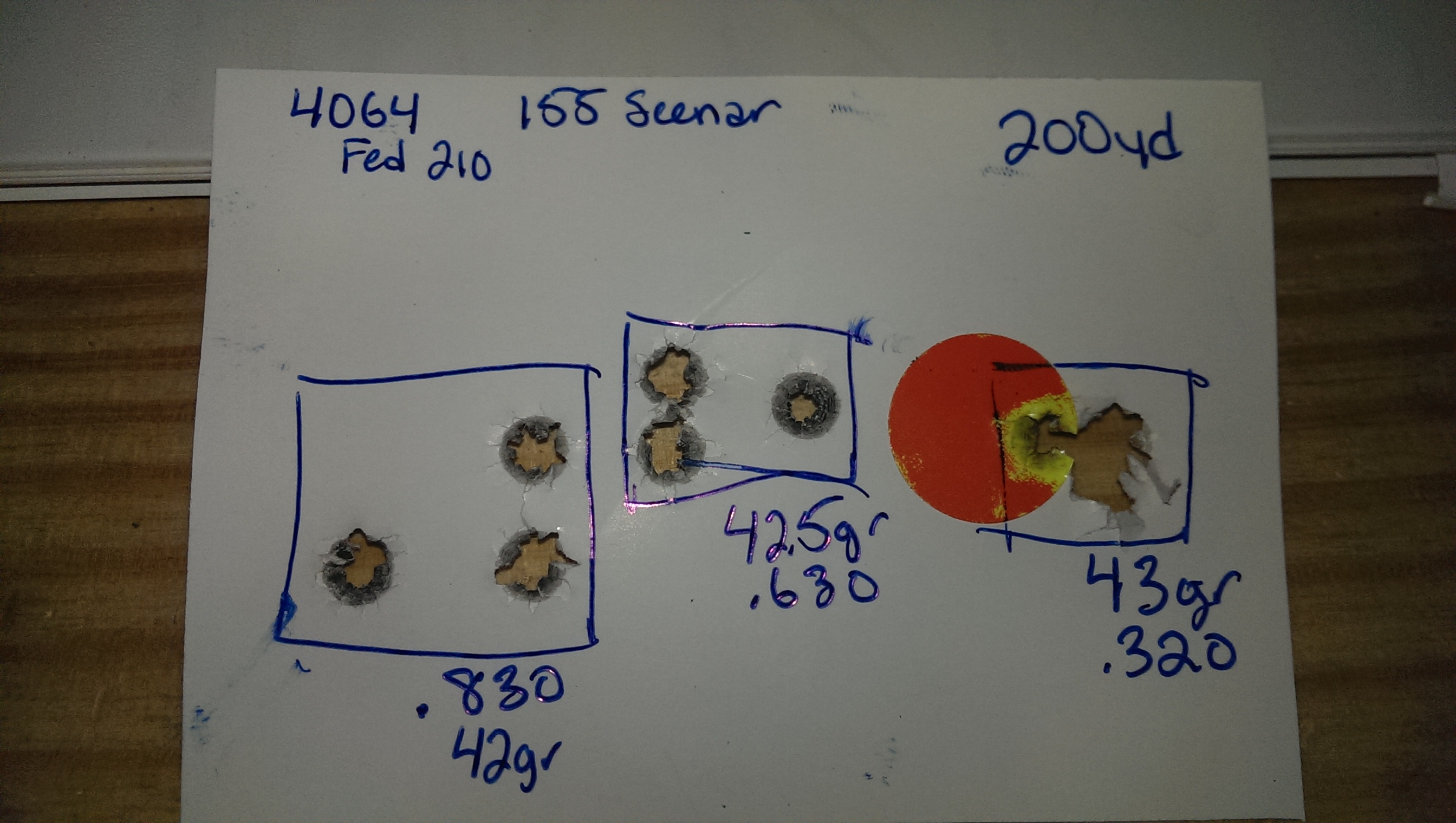

    I measure my 4064 using a CM1500, to .1 gr accuracy and have no problems with it. Throw charges .3 under trickle to my target charge weight. The fact that I picked up 9 lbs of it ~ $17/lb makes it that much more awesome.
    And then there are the results. Can't argue with my results especially when shooting a factory tool chatter lined Rem 700 barrel and action.
    (Three shot groups fired in windy condition during load development)
