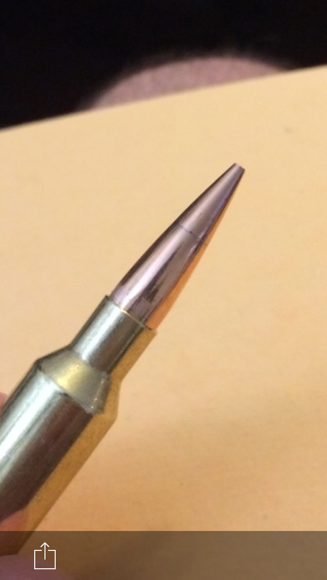

I think this "fingerprint" or sticking may be the problem. I will send a pic.

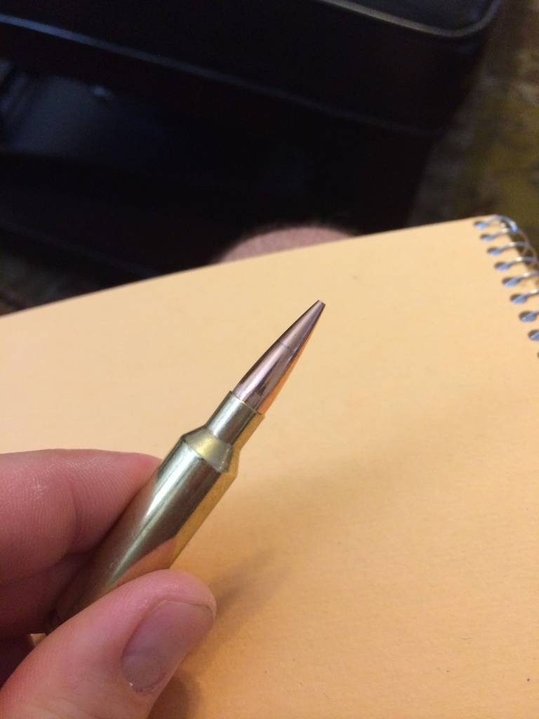

So I am getting this ring on half the bullets or so. ImageUploadedByTapatalk1410013458.045762.jpg

Possibility: You have too much neck tension and what's happening is that as you seat the bullets you are deforming them. The ring is from the seater in the die. Some bullets are getting deformed more than others and its resulting in inconsistent seating depths. Your bullets are .264, what's the inside diameter of your cases? Is should be consistent and should be .262-.263. If your ID is smaller then .262, you need to look at a different sizing die or a larger bushing or turn the necks. If you are running a bushing die without the expander ball and you are not turning the necks you will need to in order to get a consistent ID and neck tension. Lots and lots of problems with seating bullets are from sizing issues. You might not see this with bullets with thicker jackets.

I didn't realize nosler made 6.5cm brass. If you're forming them out of some smaller caliber brass then you're running into a doughnut. When necking up, the thicker shoulder material will be brought up into the neck causing a doughnut at the base of the neck.
So I am getting this ring on half the bullets or so. View attachment 48913

This is probably the main cause of your problem. Have you annealed the cases? How about the chamfer of he case mouth?
If the case mouth ID's aren't exact, and the case metal at the same state of work hardening, varying seating pressures will result in different seating depths. The ring tells me that you have some really heavy neck tension.
To prevent this I do several things. I anneal cases frequently, often as much as every firing. After sizing I use a Sinclair mandrel expanding die to make sure that all my case neck ID's are uniform regardless of my sizing method. I use an RCBS 3-way tool for trimming so I have totally uniform chamfer's on my case mouths.
Lastly I take any press flex out of the equation by making my seating dies into Dead Length Seating Dies. This is as simple as finding a washer that will just fit the case while in the shell holder. Put the washer over the case, raise the ram, and adjust the die so you get a firm cam-over. The washer keeps the die from crimping the case but there is absolutely NO variation in how far the case is pushed into the die-------- period, no matter how sloppy the press may be. Once you adjust the seating depth each and every bullet will be seated to the same depth provided the neck tension isn't so high you push a groove into the jacket.
If you like high neck tensions you can minimize the tendency of seating plugs to form these rings by adding some devcon or J-B weld to it. Clean and de-grease the inside of the seating plug and apply a thin layer of he epoxy to the inside. Then seat a bullet that has been waxed up real well with Kiwi Shoe Polish. Seat the bullet and secure the press handle with a bungee cord or hang a weight on it. Let the epoxy cure and then part the bullet from the plug. Drill a small relief hole in the epoxy where the bullet tip sits. You now have a plug that will seat bullets with no rings. It may have a tendency to stick a little at first when you are lowering the ram but it goes away. Some guys will go to the extreme of chucking the plug in a lathe, putting the epoxy in place, then the bullet. They will then "dial in" the bullet by indicating off the bearing surface of the bullet and "tapping" it into a position that yields the lowest TIR. They even make seating plugs like this for each bullet they use so it fits the ogive perfectly.
