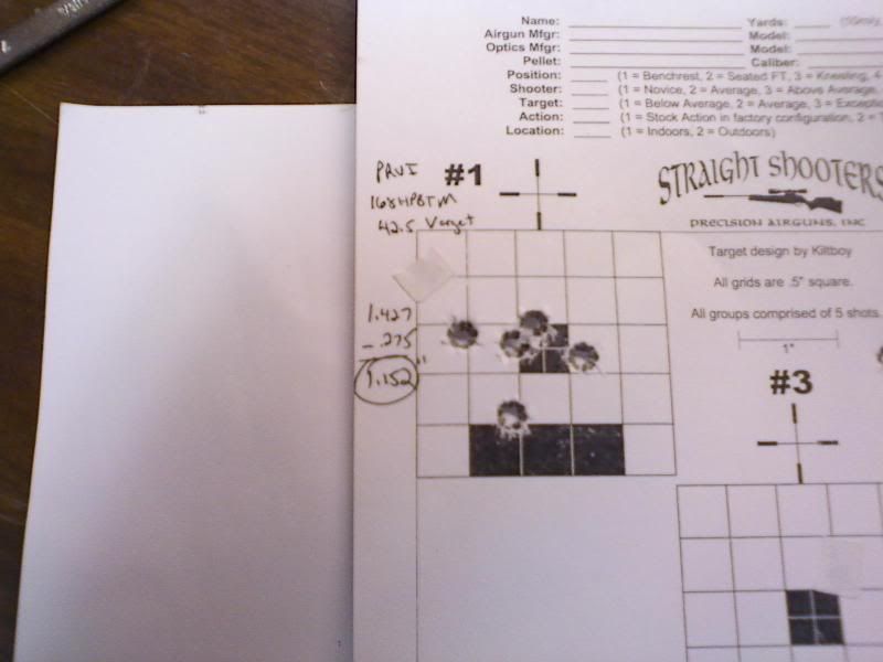

Picked up the rifle yesterday from my FFL, loaded up what I had and went to the range. It's an FN SPR A2 in .308 from Mike at Tactical Coordination. IOR 10x42 MP8, TPS low rings. I only had my cell phone for pics. I'll take some pics of the rifle later on but here's what it printed today.
I used some loads that had performed well in the past. All middle of the road powder throws and seated deep enough to feed in the magazine.

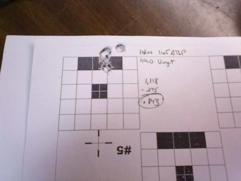

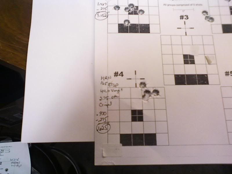

First up is the Hornady 165 BTSP that shot well in my K31. 44 grains of Varget, OAL is 2.75" and they are crimped at the cannelure with a Lee factory crimp. Two 5 shot groups. One looks like 4 rounds but I've accounted for every round I took, so I either missed the entire target or shot one round in the same hole.
The groups are measure edge to edge with .275" subtracted for hole diameter. Even though it's a .308, that's the size hole it was cutting.

I bought some PRVI 168 Match projectiles a while back. They did okay and if I went to the trouble to weigh them, they would make good ammo for plinking. 42.5 gr Varget.

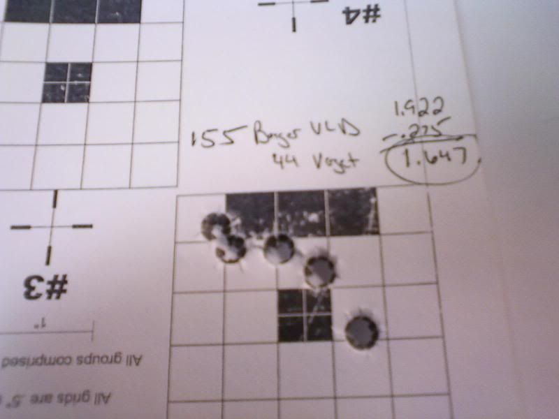

Finally the 155 Berger VLD over 44 grains of Varget.

You got yourself a good start. Don’t be disheartened on the 155 berger's. Any vld projectile will be seating depth picky when not resting in the lands. More so than say standard match profiles. But once you find the depth it likes it will run with the rest of them.
Case in point I wanted a load for Berger’s 168 vld in my factory rem tactical. Rather than stretch the testing out for several weeks ladder testing with different seating depths in the mix at my long distance range (3 hour drive round trip) I chose to load up 5, 3 shot loads in the area I know other 168’s run well. Loaded to max mag friendly length and tested them at home at 100 yards. Then took the best two and dropped the OAL by .015 and reran the test, both shot better. The heavier of the two loads was in the .5’s so no need to go further in the short term. Next time out at the long range I will shoot these with one more test load a little shorter oal at 500y. Pick the better of the two and I got my mule deer load that will work perfectly with my FDAC slide rule and my old school BDC m3 knob in the leupold.
