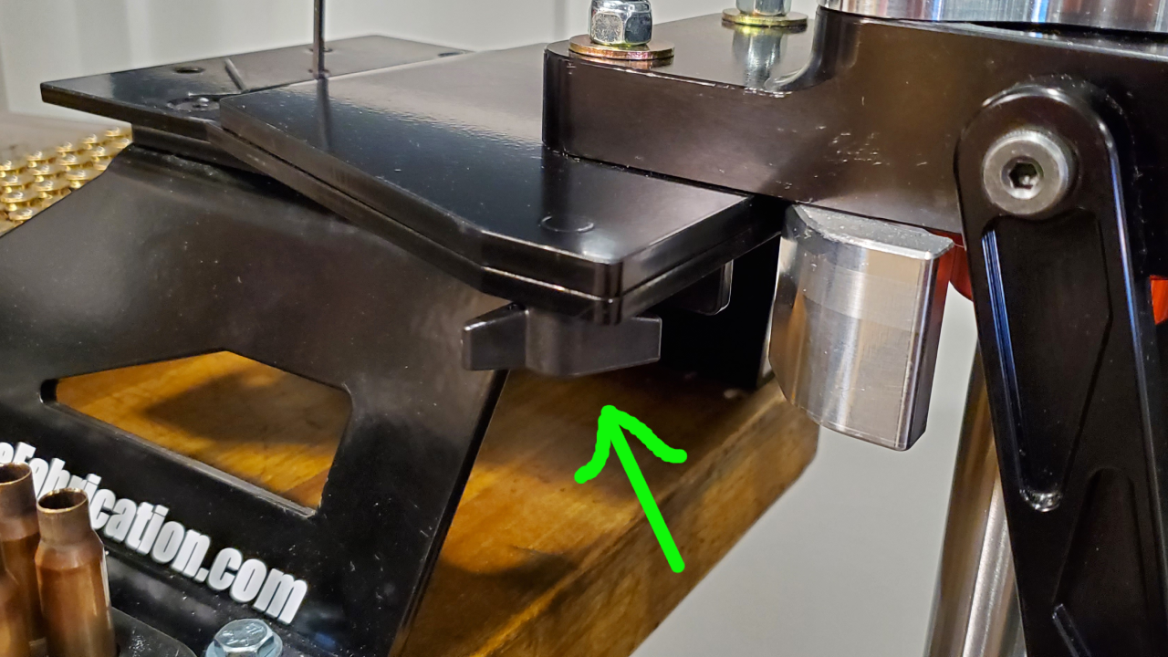

Just mounted my Inline Fab quick change press mounting system tonight on the new reloading bench I just completed and there’s a little slop (side to side) when operating the press. Is this normal or have I done something wrong? I took a short video clip but apparently we can‘t post those here. Any advice greatly appreciated.

Did the install the wing nuts under the plate you are using? Have you adjusted the set screw on the backside of the mount?

I didn’t do thru bolts. I lag bolted the plate to the bench. That part is solid as a rock. The plate that’s mounted to the press has a slight left to right movement where the two small bolts at back of press plate slide into holes in the bench plate. Haven’t tried the set screw yet but seems like that would adjust up and down movement but will give it a shot

Just to confirm since there are no pictures, are you attaching the wing nuts on the threaded parts of the plate that connect to the press? There should be a rubber protector that is on the rod, you pull that off to expose the threaded rod then use included wing nuts to snug it down.

Ah that was the problem. Thank you very much. Thought those were for when the bench plate was thru bolted on the bench.
