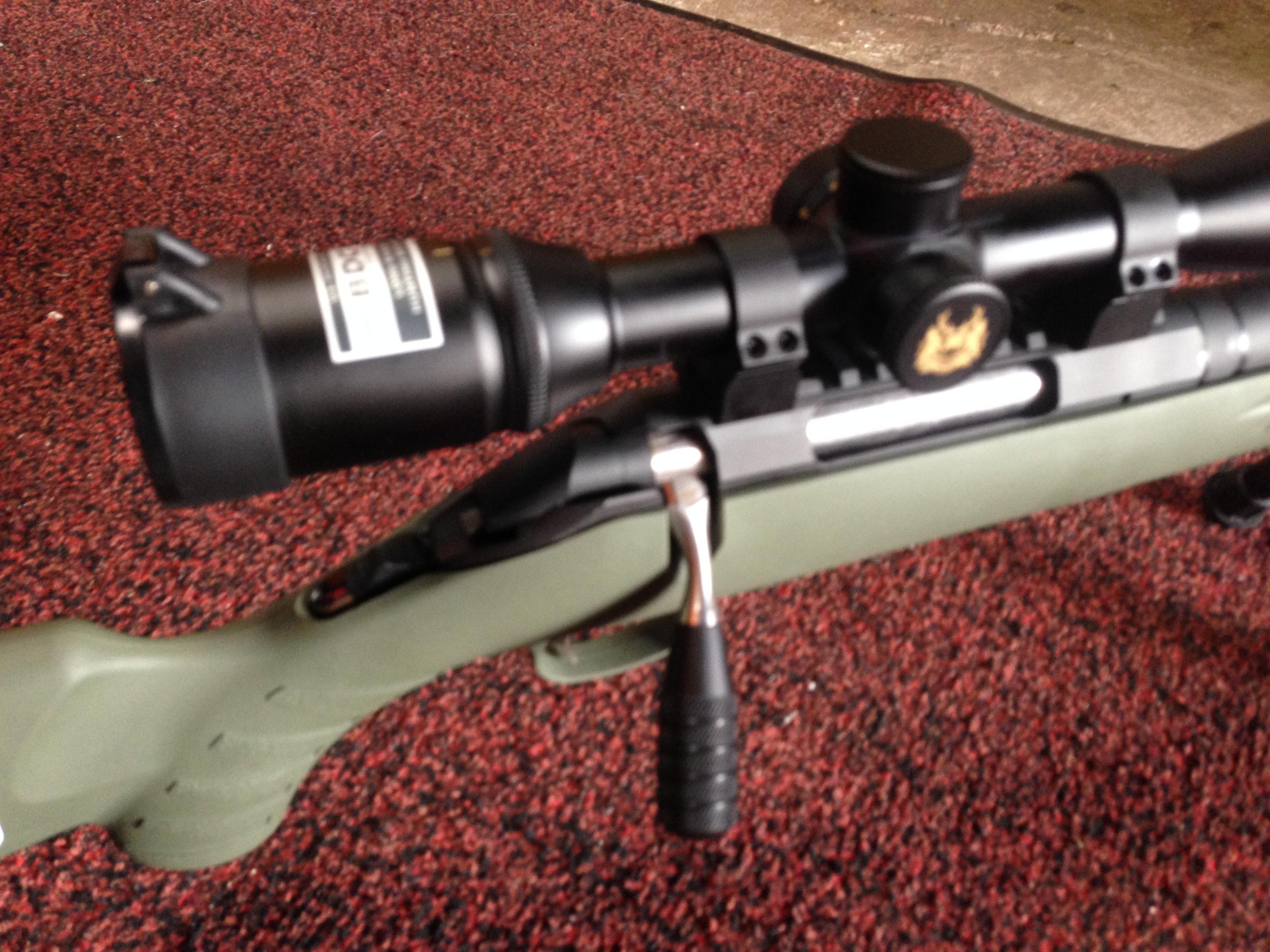

Hello I am new to the site but been reading posts for a while. I just got the 223 put utg bipod, tactical bolt handle, v6 gamma muzz/comp brake, 3x12x42 nikon monarch 3. Gun feels great , havnt shot it yet. BUT with bipod down if you move stock left or right you can see the stock tweak. And the floating barrel space closes. My thought is either buy a better stock. Or fill with fiberglass resin and maybe to small rods to stiffen the stock probably wouldnt be affected without bipod
The stock is extra-cheapo, and I think putting money into one of these would just be polishing a turd. What they do well is (1) have good barrels that shoot well, (2) have surprisingly good el-cheapo bedding, (3) feed surprisingly well from the laughable plasticka magazine, and (3) have decent enough triggers. and they're cheap.

i reinforced the fore end used a dremel tool with couple different style router type heads, 1/4 aluminum flat stock, drilled holes so epoxy would bond through.let dry overnight, mixed fiberglass resin with hardner 3oz, 2 layers of fiberglass mat till tomorrow and the i fill hollow stock behind the recoil pad with expanding foam
