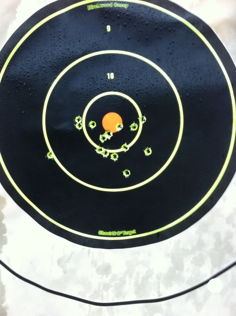

I have a ior 6-24 that won't hold moa @ 200 or 100 I bought it used from another site. I didn't get a warranty card..... So has anyone delt with them? Any info would help I've tried to contact seller and it's dead end..... I will hold about 3moa @ 200 which would be fine from hunting but its not what I want for this scope..... Here is what it looks like @209yrds

I'll try to get 100yrd in the next day or so but I was hitting x rings at 600rds with a falcon no problem
My rifle I'm shooting from is a remingon 5R .308 in a McMillan A5 adj. Beaded with a Harris bipod...with blackhills 168 a max match ammo. Now I'm very new to long range but I'm not that bad of a shot

sure u werent just having a bad day? the pattern shows a horizontal and vertical dispersion. If it was scope i would think it would manifest itself differently. But for sake of arguement, have you checked everything else?? (rings, base etc.)
Re: Ior customer service
Yes I've tried a different scope and groups are alot tighter I guess I should have shown better targets with different scope. I'll get two close then it seems to jump out of zero. all those shots where aimed at center while on a bench with bipod and bag so basically just squeeze the trigger and bang so to speak. Anyways I've read bad things about there cs and was just wondering if anyone had any experience with them with out a warranty card. thanks for the responses

I thought I had a problem with my ior, 300 yrds horizontal was .75 inch vertical was 2.5 inch. I started checking things over and found the mounts were loose. Hopefully this is your problem and may save you some headaches. goodluck Rthur
