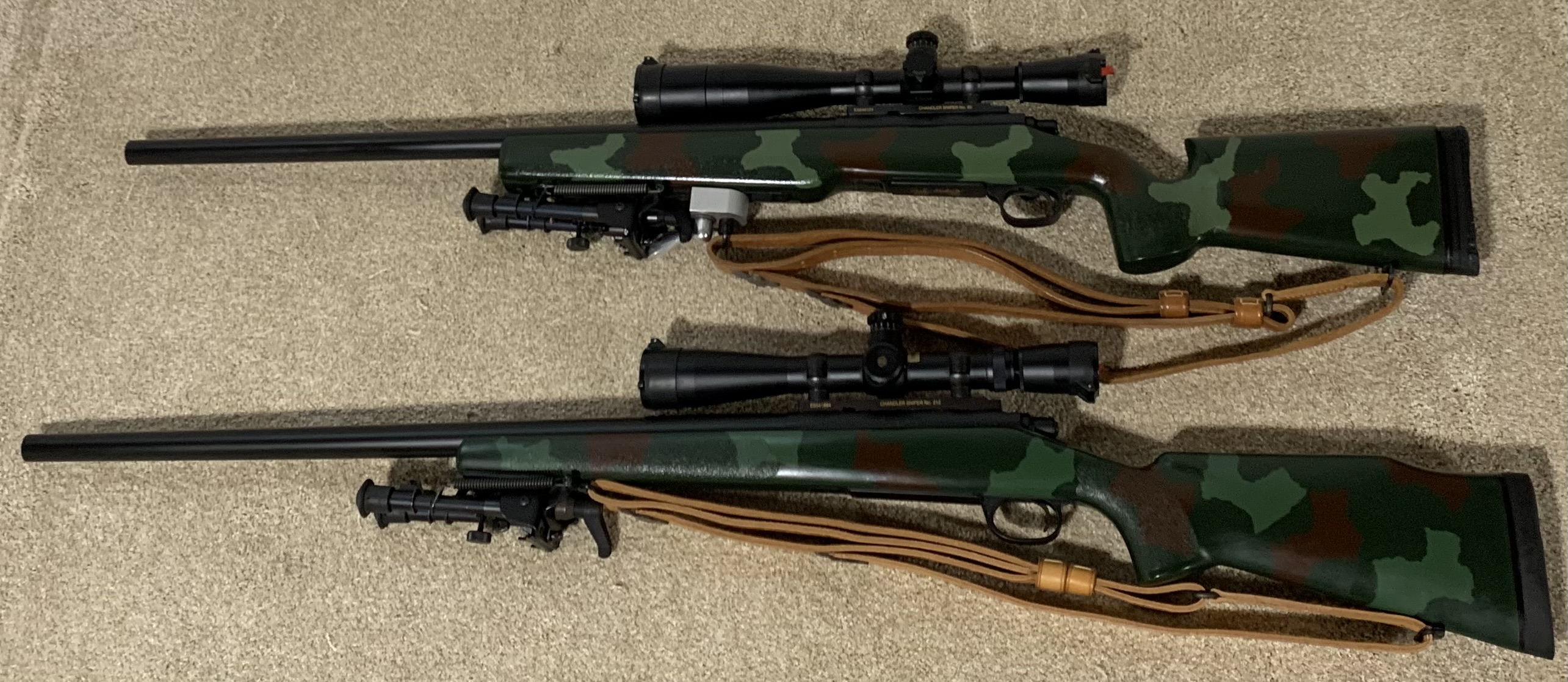

IBA rifles, 308 win (top pic)and 300 win mag (lower pic)…never shot them…hopefully they shoot decent 🤞one day in the future. I was always under the impression IBA barreled actions were built at Hart? D.D.Ross scope bases and I had extra bipods laying around…sucks to hear about your builds….JAFR pictures😉

Thanks for all the info that helps me to understand the custom build process.
