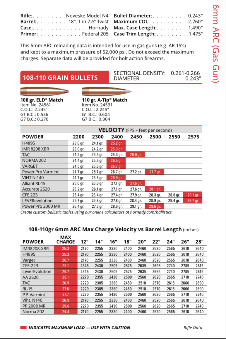

My own experiences with helping a friend build and load develop for a 16” 6mm Arc would tend to disagree. Yes it doesn’t perfectly match the numbers from a 24” barrel, but per Hornady (6mm ARC’s creators) 6mm ARC arose out of a DOD contact/project for better results out of a 16” barrel, not a 20-22” heavy barrel. Currently at work, once I get home I’ll dig up my notes from load development and post numbers. I don’t think the loss of 1.5” would be particularly detrimental
If someone asked me for a specific recommendation for a rifle to fill a modern DMR role, with minimal retraining, my answer would probably be a 14.5” SOCOM profile 6mm ARC build, with a heavy duty muzzle brake/suppressor QD (probably a Lantac Dragon)
I'm inclined to agree here, as my ideal "do everything" rifle would be a 14.5" chambered in an intermediate cartridge like 6 ARC, 6.5 Grendel or 6.8 SPC. My 14.7" 5.56 is a fantastic little gun, but I really do love the way my Grendel thwacks plates at 600 yards.

Still not home (second shift be like that) but on lunch so I figured I would provide some supporting material for my commentary. Here’s Ryan Cleckner’s commentary on the cartridge out of an 18” Rec-7: https://gununiversity.com/6mm-arc-review/
I'm not denying that the 6mm ARC has benefits.
All of Hornady's data on their webpage is for 24" barrels. The article you list, which you also point out, is an 18 inch barrel.
That is a difference of 3.5" of barrel length from the OP's 14.5" barrel.
If hornady touts that it was designed around a 16" barrel, why do they use figures for 24" barrels?
I'll give you a hint, it's to mislead.
Also note Ryan has concerns about the magazines.
But, as I said in my earlier post, more oomph is better and the 6 arc, Grendel and 6.8 spc all provide more.
It’s not necessarily to mislead so much as all the barrels used in test rigs by major manufacturers for sample testing and spec QA are 24” custom jobs because of the pressure transducers, etc.
For magazines E-landers have been dead-nuts reliable for my friend so far, but they do require a small breaking in period.
Edit: link a friend sent me off the Hornady site to barrel vs velocity data

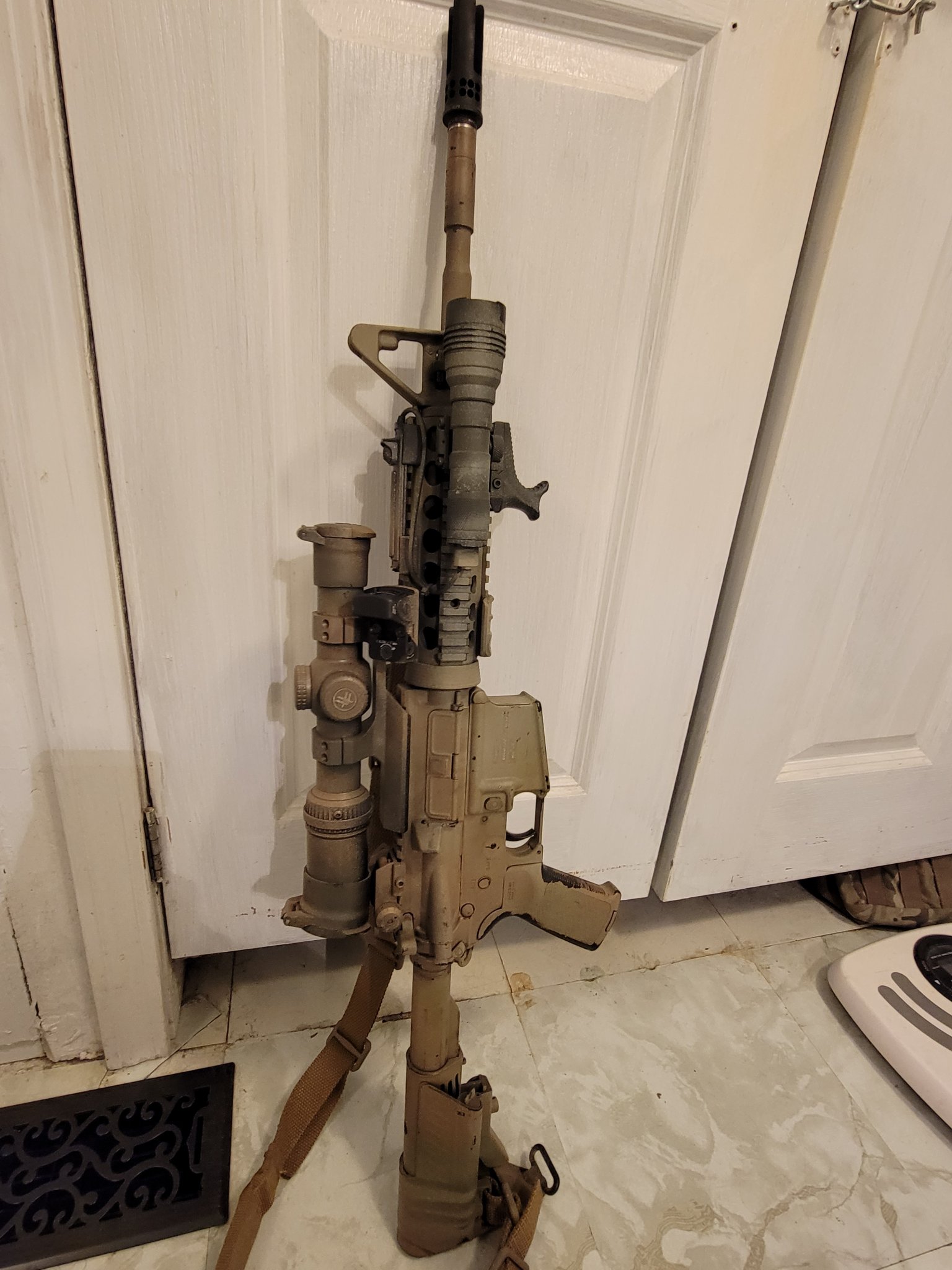

So, I've got this AR with a 14.5 barrel. The lower is already sbr'd so no worries about pinning the muzzle device. It consistently shoots 1"or less with the 8x scope that's on it. My question is, is this barrel too short to press into service in a DMR role? And, besides the suppressor that's in jail, is there anything I should be thinking about upgrading? View attachment 7833491
With what I've been learning over the last several months about rifles, I'm starting to think that the choice between 14.5 and 16 depends on if you absolutely must have a specific muzzle device. If you are content with a standard A2, seems like 16 may be the better way to go, even if only for the little bit extra velocity.
However, if you're dead set on something like a KAC or SF flash hider, then the pin/weld (or sbr stamp) may be worth the reduction in length.
More than barrel length, however, it seems that barrel profile is the attribute to look at -- not for "range" but rather precision/consistency (which has the side effect of making hits at any distance more likely, assuming the shooter has good DOPE).
Others who know more than me about all this seem to have already stated as much above, so maybe I'm just being redundant.
But if starting from scratch, I would probably go with a "medium" contour (like the SOCOM or Criterion Core) mid-length gas, 14.5" with a twist rate appropriate to my chosen ammo. I like 1:7 (maybe I'm a "fudd" in that sense), but a lot of mfrs are making 1:8s as their standard/general purpose offerings. I've been curious about the 7.7 twist and may eventually do a build based on one some day.
1" or less, eh? At what distance? Calling BS on that one.
I'd start with a free floating handguard instead of that damn delta ring and take a Dremel and cut that front sight post off.
But please, throw up a photo with a couple Birchwood Casey plasters at 100yds, say three of em, give em five rounds a peace, before you change anything.
An inch or less with a delta ring handguard and no bipod, I've just gotta see this! Video the whole thing and if all 3 are an inch or less I'll send you a box of ammo.
