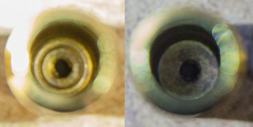

There is a difference. I just noticed it for the first time tonight after stainless steel tumble.
Only problem is I am not sure which is which. One of them has a little ring around the flash hole, inside the case. The brass is thicker there. These weigh about a grain more than the other brass which has no ring. I think the no-ring version is the FGMM 308, while the ringed version might be 7.62 AE brass.
OK, so I took a picture of it to show the difference. Anyone else seeing this?
One on the left is the one with the little embosed ring around the flash hole. I have about 100 of these as well as the regular type. Not sure which came from what batch, because like everyone I thought they are all the same (it looks that way from the outside), so I threw them all in the same bucket.
Nick,
The "ring" is actually a depression in the base of the case caused by a newer flash hole forming process. It creates a cleaner flash hole compared to the older process, but can still leave burrs. The burrs caused by the new process tend to be much smaller. I've seen the same thing in newer Winchester, Hornady and Norma brass. As long as the case volume/weight is the same, you shouldn't have any problems.
