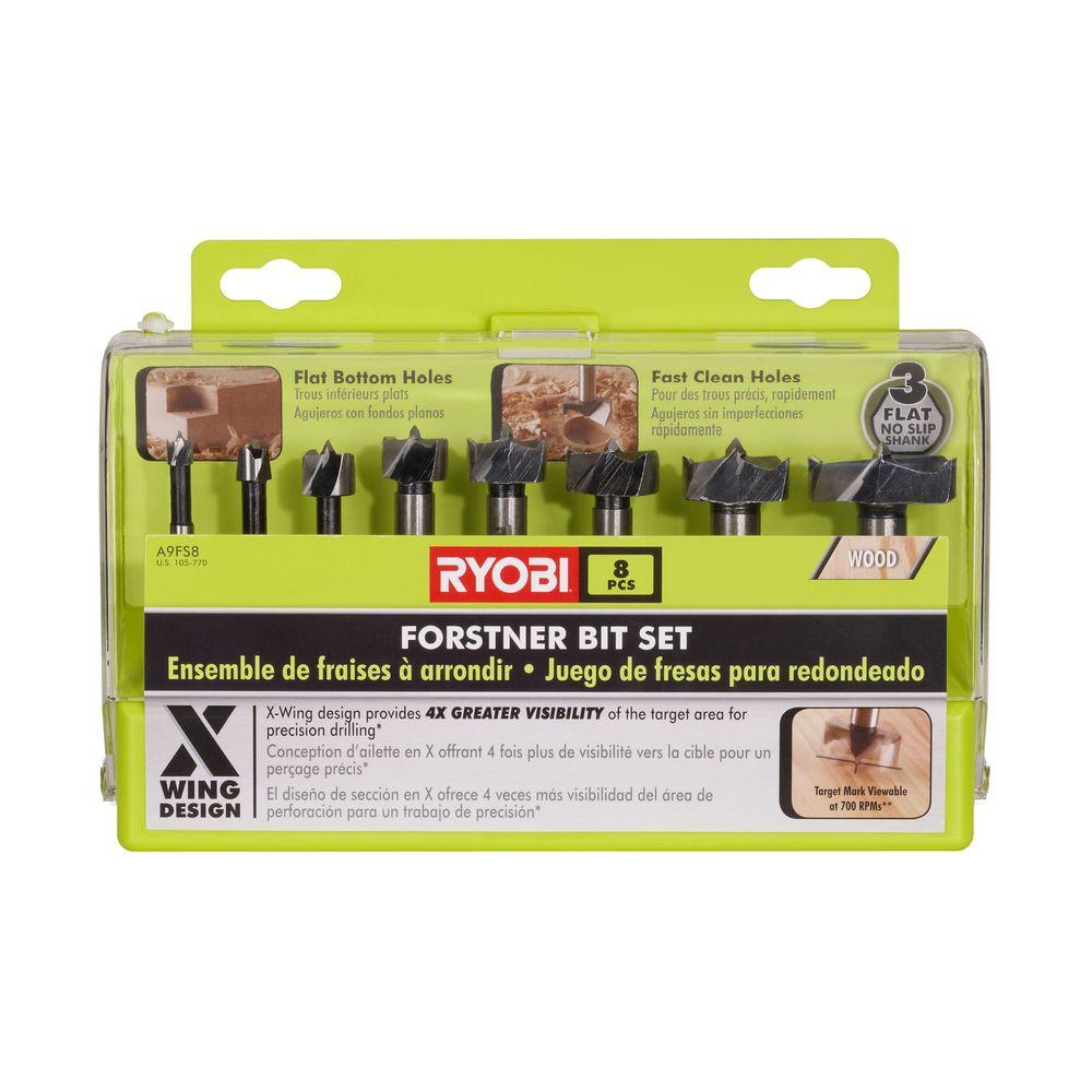

A grovetec flush cup (and there’s really no reason to use anything else) takes a 1/2” diameter hole that’s 1/2” deep, flat bottomed (Forstner bit), that’s then tapped 9/16-18 UNF.

in the linked thread, the op shortens spade drill bits.... would cabinet maker drill bits work better?
They cut a flat hole- similar to an end mill
