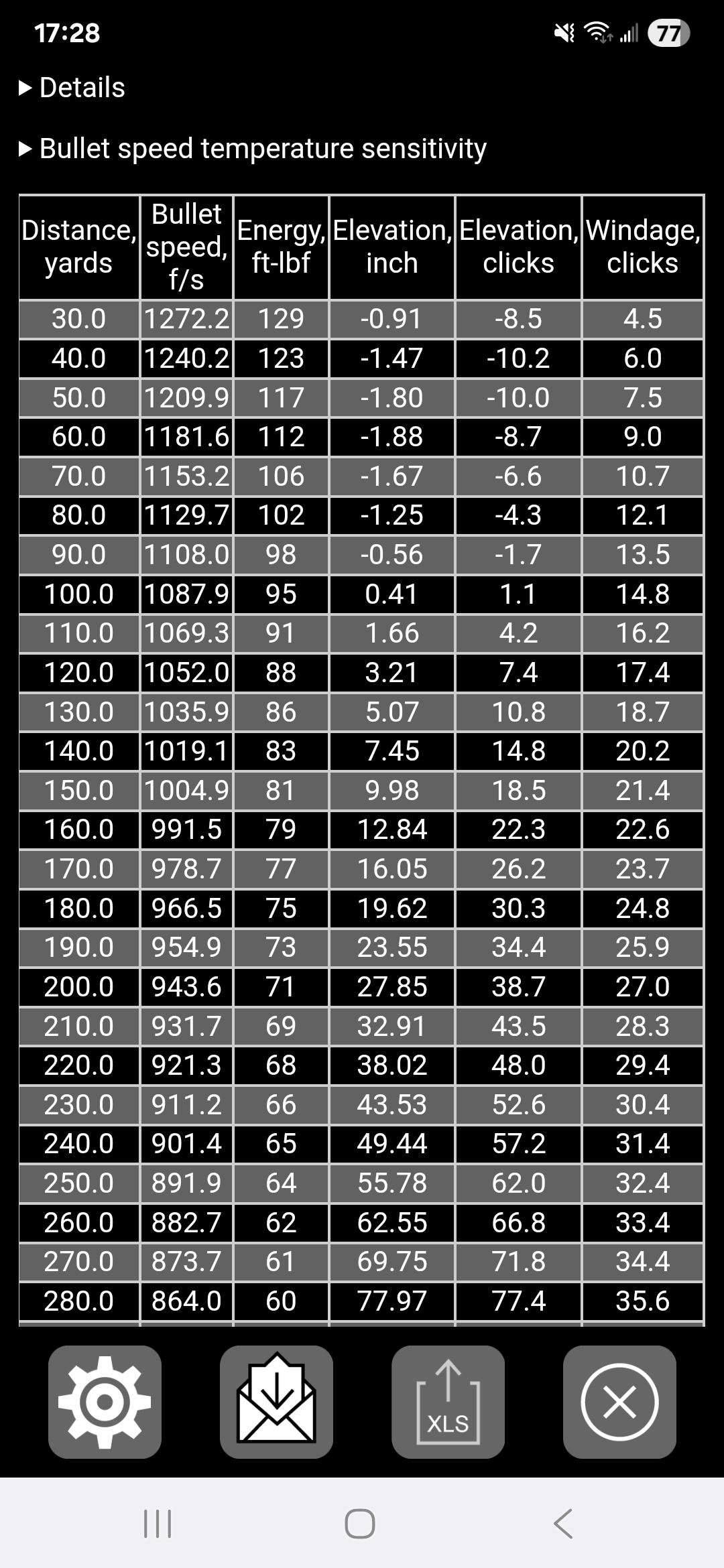

I am far from a ballistics expert but comparing the .17HMR to the .22 Mini Mags it's better but not a lot better.
Here's .22:
And here's the .17:
So it seems that my point blank range only increases from about 110 yards to 140 yards or so which isn't a lot really. Also not sure that bullet energy is the end all, be all of stopping power but it doesn't seem to offer a huge increase for larger animals.
Would I be correct to think the .17HMR is only 25 to 30% better than a .22 with Mini Mags? Stingers pack more of a punch but they weren't as accurate for me. The .17 does shoot flatter but past 150 yards does it have enough energy for the critters I would be going after?

Look at the wind drift, though. If you’re not good at calling wind, that little .17HMR that’s hauling ass double time is going to run a .22 into the dirt. Even at just 100y, the .17 has less than a quarter of the wind drift of the .22 Minimag. Everybody always looks purely at trajectory with regard to MBPR, but calling wind is what everyone sucks at. BIG difference in performance there, and I’d argue that’s what will make the bigger difference in your ability to make shots where they count.
Your charts aren’t apples to apples, FYI. The .22 has inches and “clicks,” the .17 has inches and mrad. Does “clicks” = mrad on these?

Yeah "clicks" are 0.1 mrad. Sorry I pulled them both up on Strelok and that was what was saved for each chart. I fixed it. I was more focused on the elevation in inches because for snap shots I wanted a longer point blank range and for me that's anything plus or minus an inch or two.

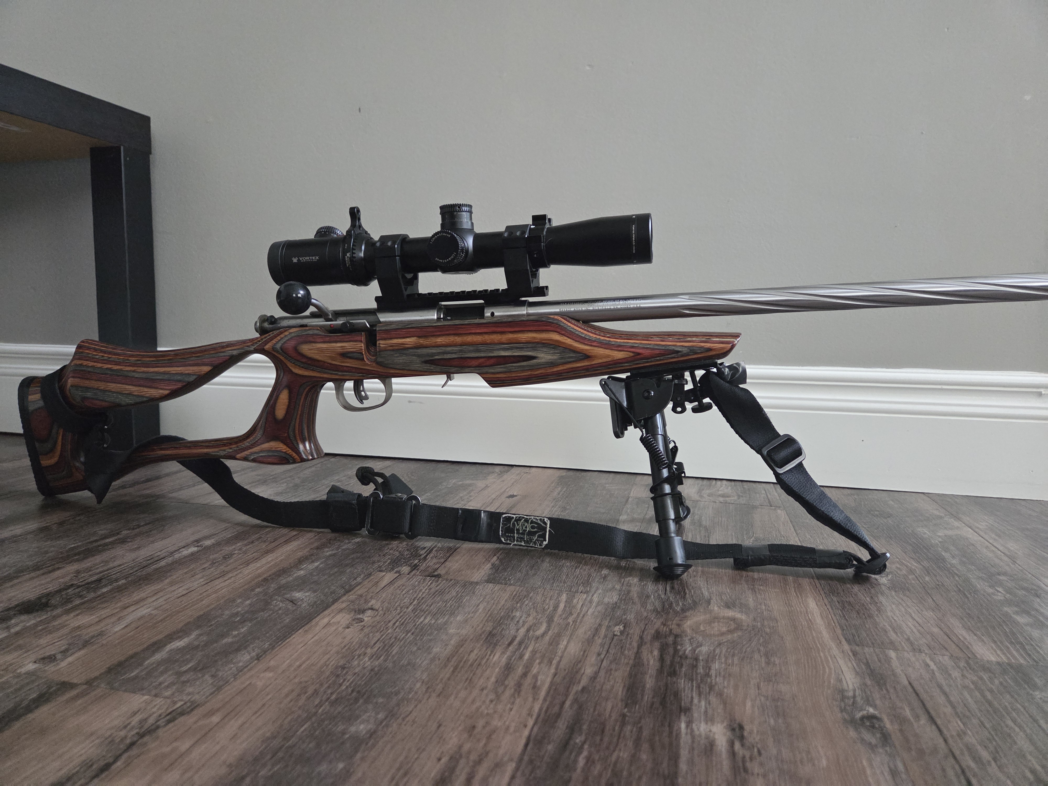

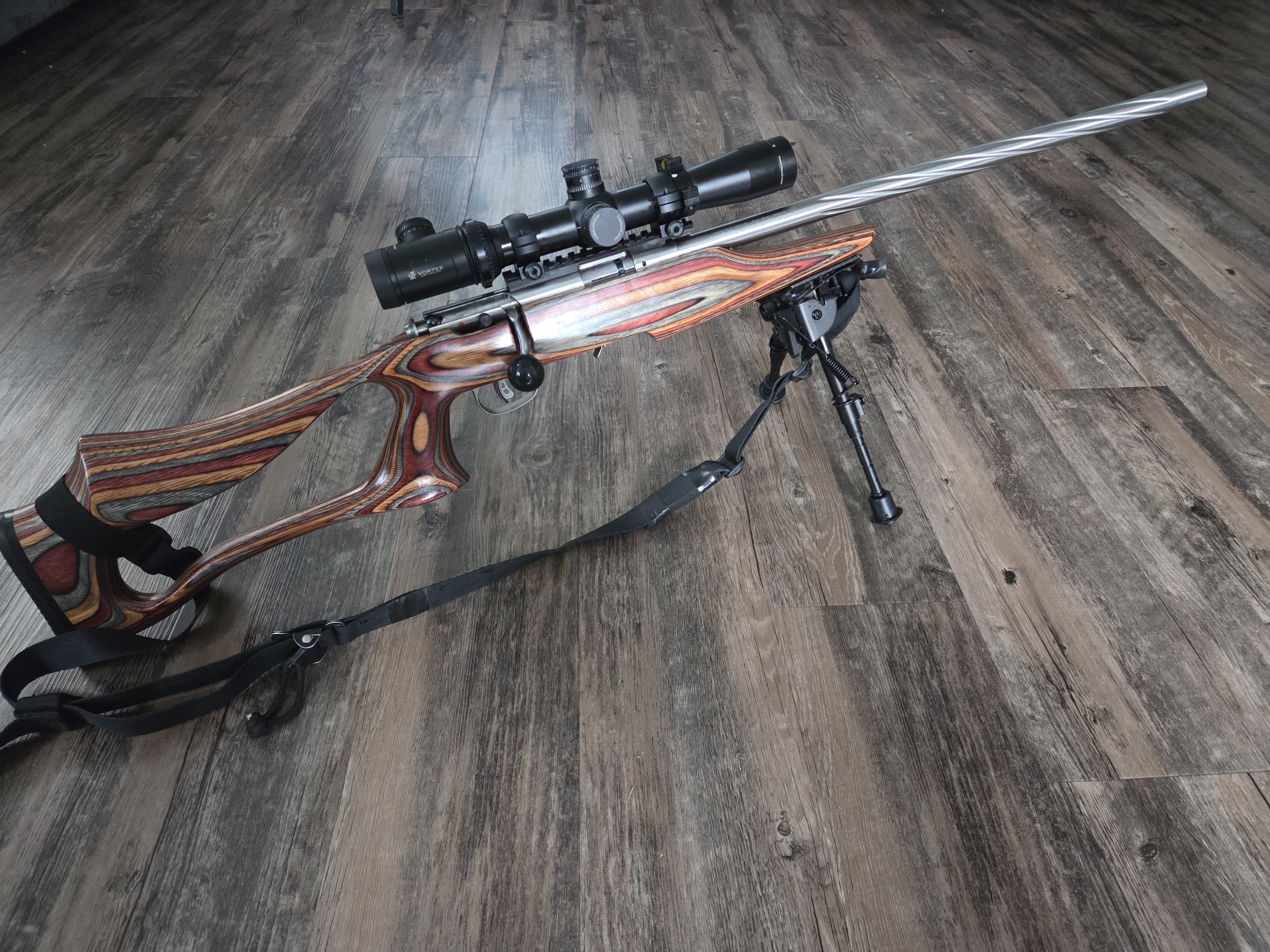

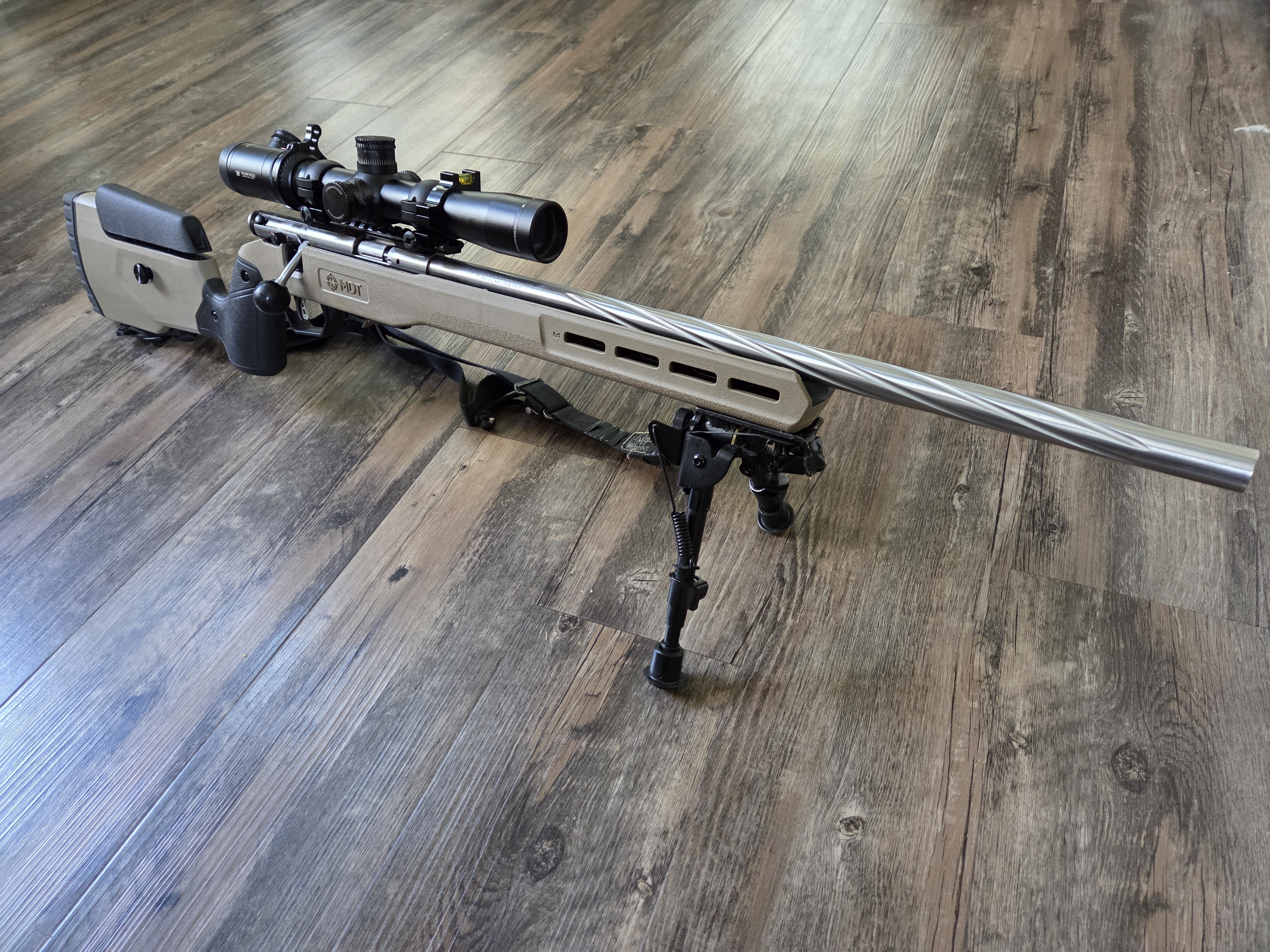

Well thank you everyone for the replies. I have ordered some extra mags and a scope rail.
I am probably going to get an MDT Field Stock as well. I'm just trying to figure out what arca rail length I need to use it on a tripod but still leave some bipod options for either a harris or picatinny mounted unit in front.
Reactions: MarkCZ
Didn't realize my Vortex PMR rings wouldn't fit on a the factory base so I bought a new base rail then realized the PMR rings were crazy high:
So then I went with Weaver sized Vortex hunter rings:
Also grabbed a bolt knob.
I used to like the lines of this stock and thought I might be able to live with it but it is very unbalanced on the bipod. Also lacks an Arca rail so I may have to get the Field Stock.

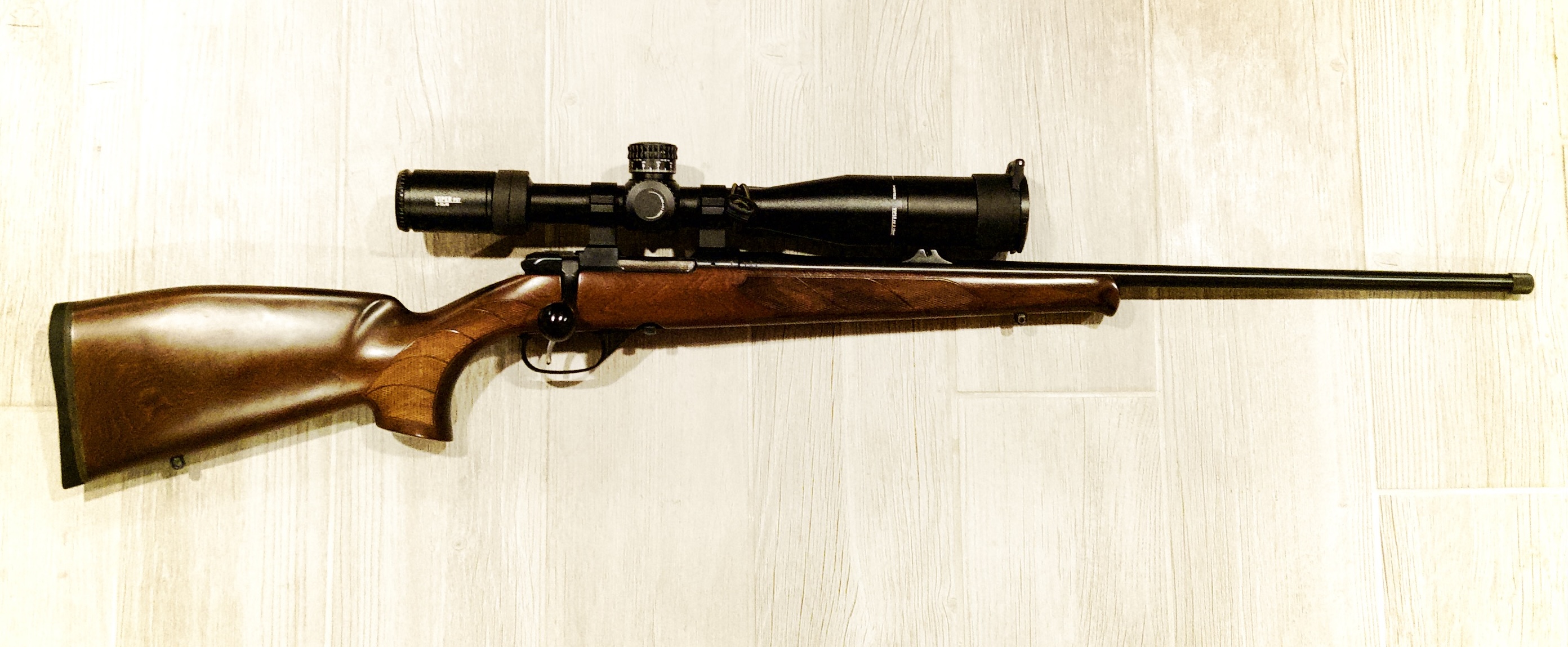

Totally off topic: I had bought a CZ 527 in 221 Fireball with glorious wood. Came with one mag. Then I discovered one could not find any mags. Literally zilch. Out of production. Sold the gun.
But in retrospect, maybe just one mag would’ve been fine. Probably. Ah well, live and learn.

You were quite helpful. The obvious answer is get both so I did. My new stock should be here in a couple days as the factory one almost sent me to the chiropractor zeroing it. As DFOOSKING pointed out it's trash.
I would never be without a .22 but there are times and places a .223ish round is too much and I think the .17HMR will fill that niche.
Also it's just a laser doing sub 3/4 MOA groups close in but the velocities go way high or way low occasionally, sort of how .22s seem to have the odd flier in almost every ten round group.
Just waiting on an arca rail. I ordered an Mlok one I will have to customize a bit.
I was always a bit annoyed with this rifle because the magazines did not insert straight into the mag well. You had to twist them to get them to latch. I was going to try to put a shim in the mag well but instead I modified this "L-bar" that the magazine attaches to by widening the hole and realigning the piece.
