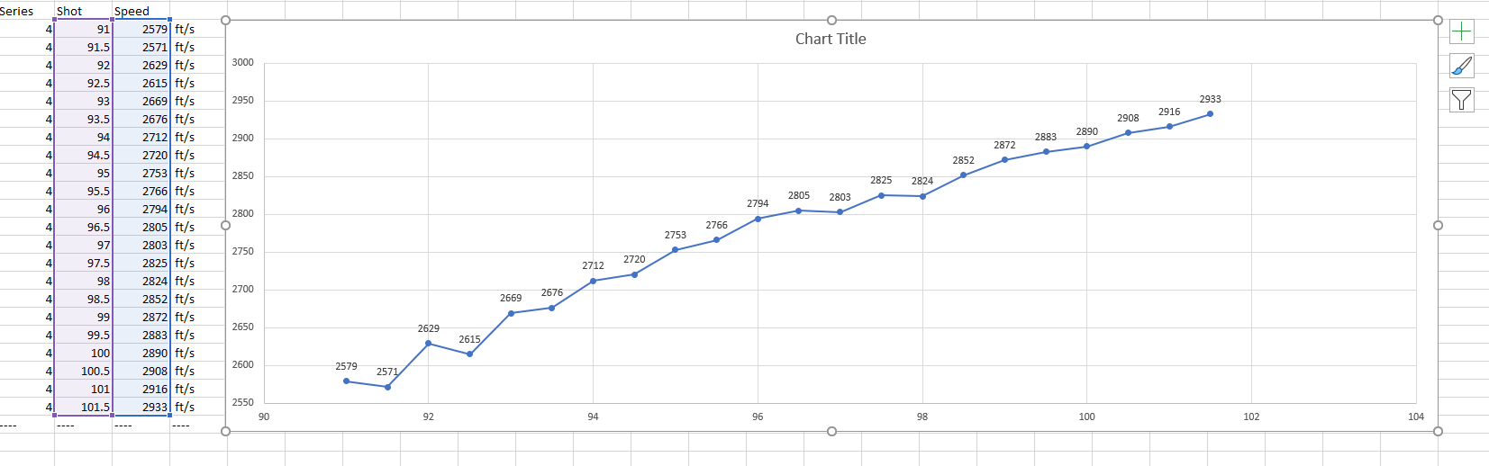

Been playing with Ramshot LRT. There is no data for LRT and 300gr Scenars so I went with the 300gr SMK data and loaded in .5gr increments from the min to .5gr over max. This is the results....
It looks like 96 to 98grs is the sweet spot to run an OCW but I wanted to see if I was missing something. Thanks for the help and for putting up with the stupid questions (I'm sure there will be more
