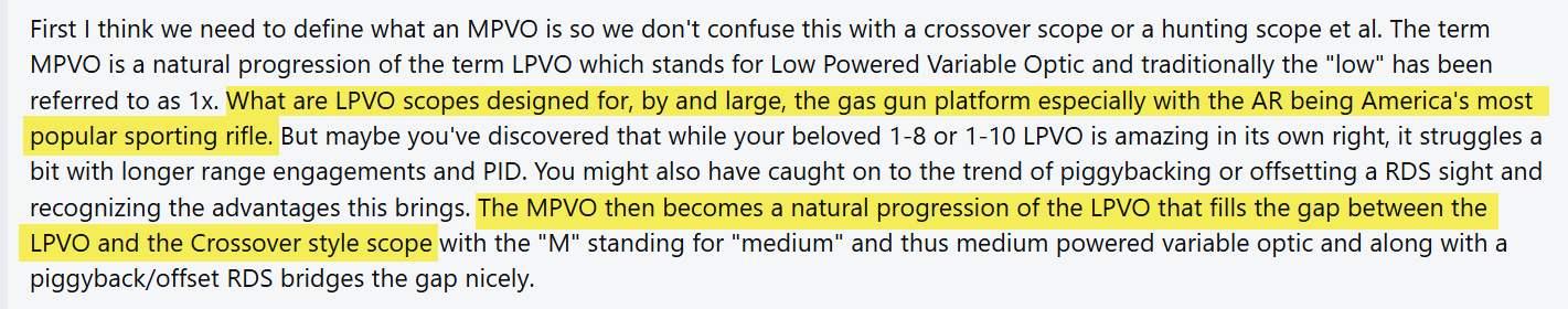

Rifle Scopes Is there a market for a good MPVO
Which mag range and objective best fits MPVO for you?
  • Total voters

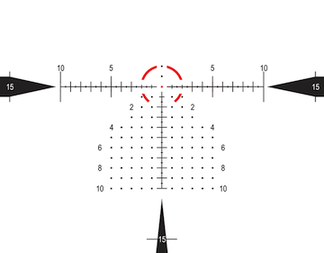

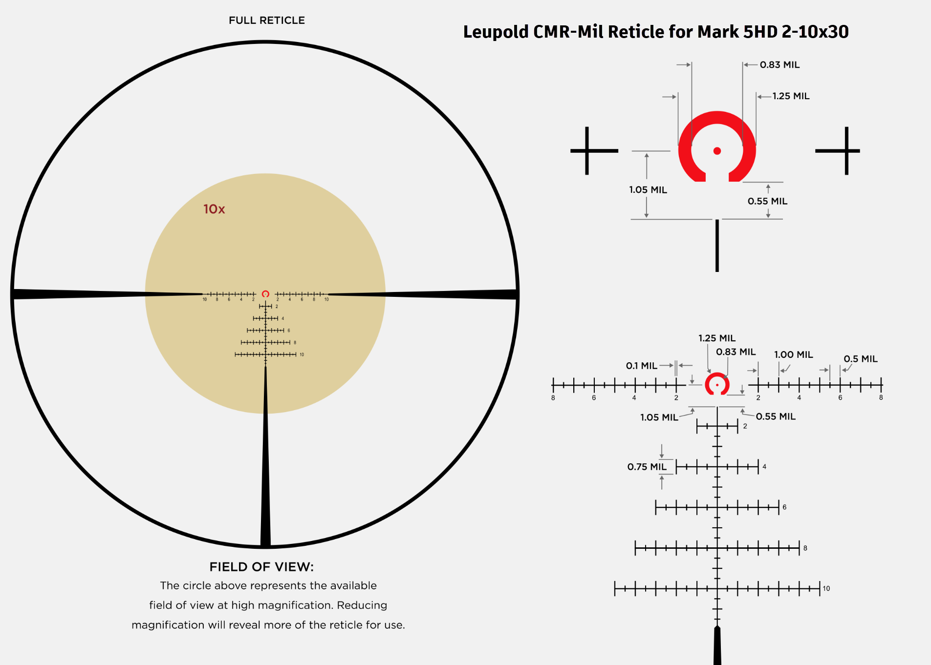

Have you seen Leupold's new CMR-Mil reticle for the 2-10, might be what you're looking for... personally, they should have brought the main horizontal stadia with wind holds inside the donut, at least with dots, they way it is right now would be frustrating with light winds and dialing the elevation turret...

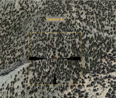

I agree with you on the horizontal stadia needs to be brought into the donut. I would also want the reticle fully illuminated. This reticle is kindof what I’m talking about when I say I think they make the compromises in all the wrong places.

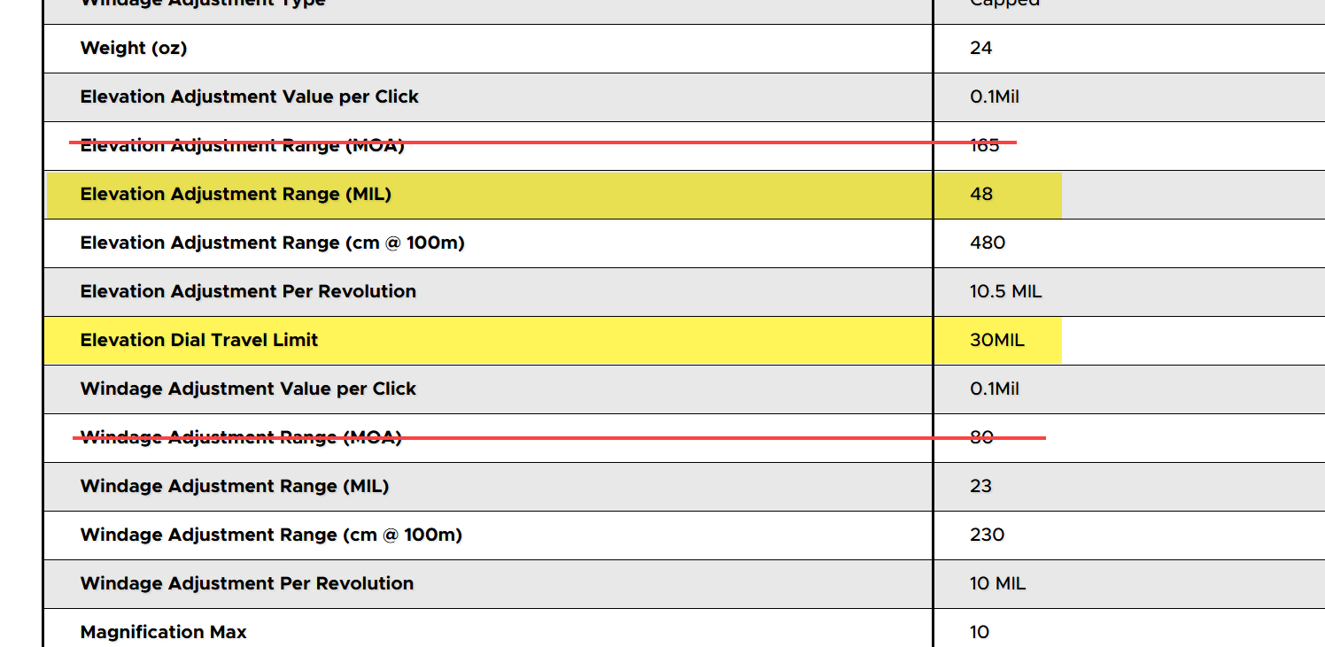

We bore sighted his AR using the scope with traditional rings and it had 8 MRAD of elevation remaining, which was not enough.
-Stan

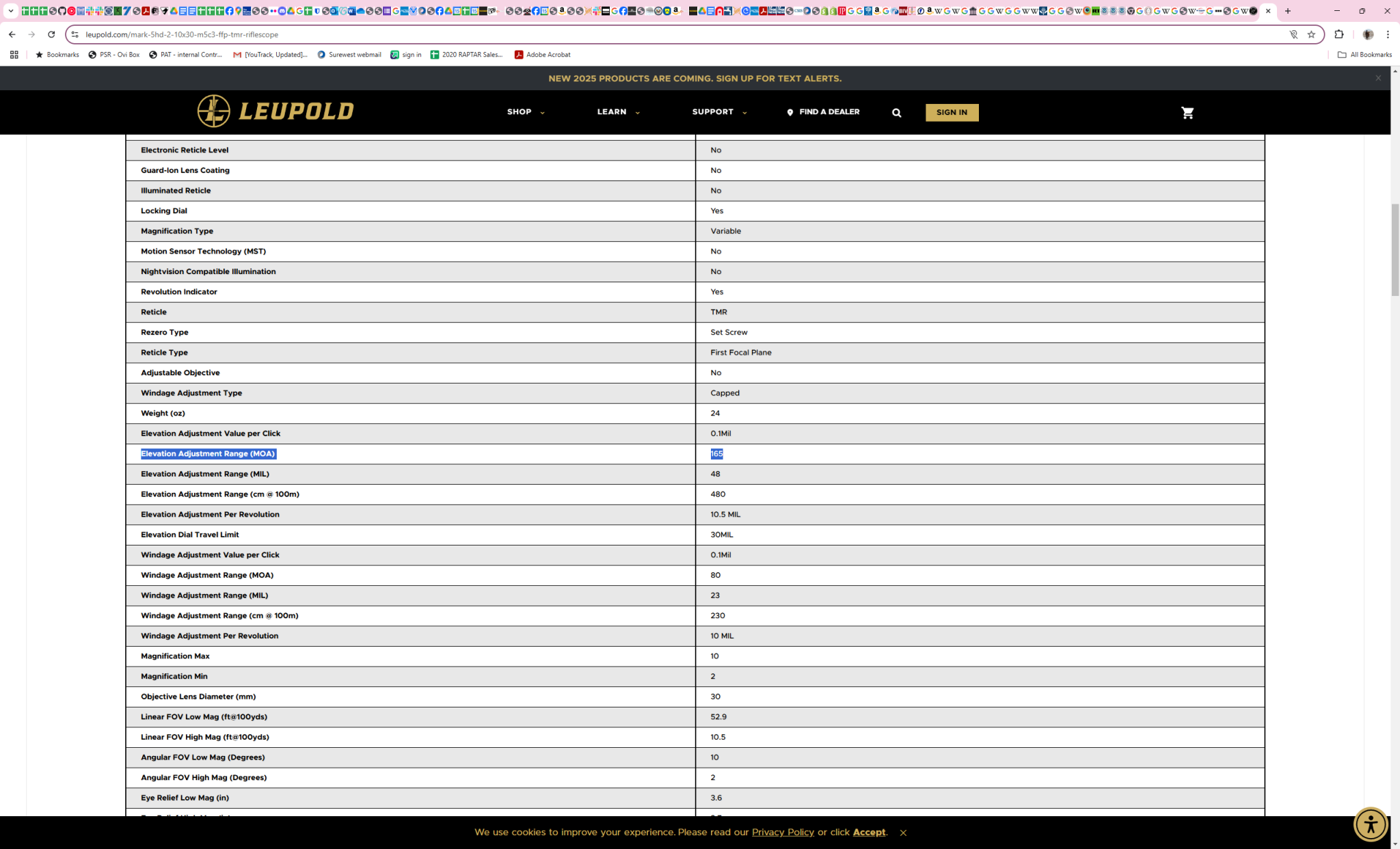

Something seems seriously wrong with that, Leupold lists their travel range at 24.7 mrad and travel limit at 28.7 mrad (a little confused what the difference is) but given the lower value of 24.7 mrad, after boresighting should have had closer to 12 mrad of travel... either Leupold is not being honest about their travel or something is wrong with your friends setup???
Reactions: stanley_white
You lost me on moa, what is that? Morons Of America??? :ROFLMAO:

I do think Leupold finally did a great job with their new reticle for the 2-10x30. Only issue is it’s overpriced I think.

What I'd like to see is a low end of 2ish and a high end of 10, 12 or 14x. Locking turrets (or capped windage to lower weight/cost), total length around 12" and weight below 25oz. I'd like it to be ffp with an illuminated Xmas tree reticle but with only the horizontal and vertical axes illuminated (not the whole tree). Out of these preferences, the least important are length (as it will be on a rifle with a long handguard hence plenty of place for a clip-on) and bottom end mag (the offset rds is the primary for short range so even a low end of 4x isn't a deal breaker).
On paper, the Mk5 2-10 with the new reticle seems like the best fit for my criteria, but I've yet to get behind one to see. Also, I've recently come to want more than 10x as a top end for this kind of optic. I came to this realization recently when trying different optics on a new build (.223 gas gun with 20" SPR contour barrel, 75s around 2750). I had a Razor G3 1-10, PST G2 2-10 and LHT ffp 4.5-22 on hand to try. I started with the 2-10 as I already knew it outperformed the 1-10 at 10x based on previous testing I'd done (despite the weak points of the 2-10: 26oz weight, sub-par reticle and exposed turrets) and didn't find myself at a disadvantage at close range as I was running an offset Acro (which I'd run with the 1-10 anyways for night use). The only downside relative to the 1-10 was the extra 4oz and 2.5" of length. What I was kind of surprised to find was that past 500, in less than ideal light, with partially obscured targets, targets in the shadows or with snowy backdrops, 10x just wasn't quite enough. Maybe better glass would make all the difference (the PST G2 glass is ok but not Razor level or anywhere near "alpha")? This made me look hard at running the LHT ffp 4.5-22. The more I thought about it, the more it made sense: it is only 3/4" longer than the PST G2 (13.3 vs 12.6"), is 4oz lighter, has better glass, better reticle, locking elevation and capped windage. Another optic I'd happily run (but no longer have) is the NF NX8 2.5-20 which hits all my points but weight. All this to say that I think the lines are super blurred between the ideal MPVO and really good crossover/compact scopes, based on your individual criteria and where you're willing to compromise which is probably a big reason that no one has yet released the ideal model...

I get the use of a red dot on top. It has its merits but if the reticle was designed right you really wouldn’t need a rmr on top unless you are looking for speed and not to touch the magnification much. In a hunting type context we could have the option of eliminating the rmr. I agree with the above about it being a shame bushnell dropped the LRHS/LRTS.

As for the reticles, It seems to me we are so close already. The wide-open of this tremor 8 concept with interior details of the current FC-DMX seems like a "95% there" solution. Maybe it could be better, but not sure how much before you see feature creep.
The seeminly imposible part is getting it in the right form-factor...

Agreed, having just the center dot or a horseshoe illuminated is much more suited to an LPVO or hunting optic where usability on low mag is a primary consideration vs a "nice to have".
Reactions: DM1975
All in all I prefer to dial elevation whenever I can and hold for wind. Where I’m at the wind is usually so switchy that it makes dialing and bracketing nearly useless. Having said that though I still prefer to have the tree illuminated as well.
