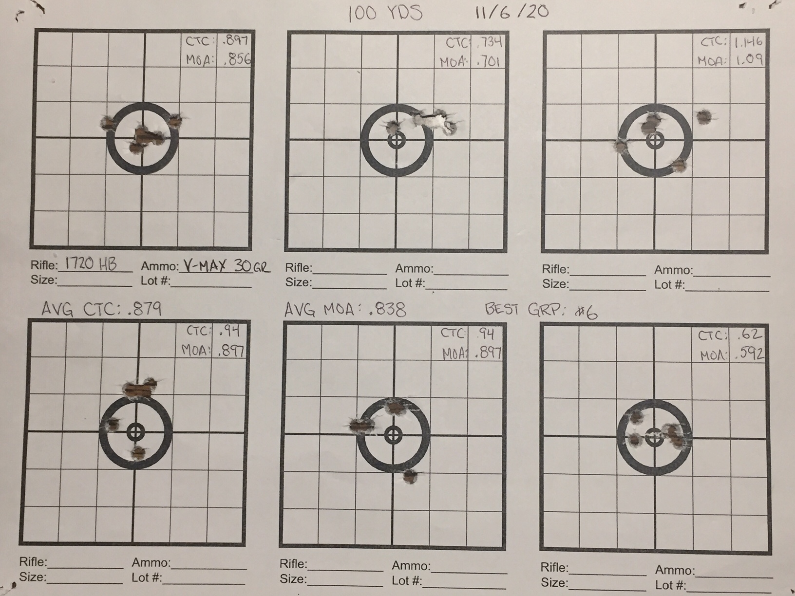

Hornady .22 Mag 30 Gr V-Max seems to be pretty consistent hunting accuracy for me but definitely not "sub-MOA all day"
I did find some CCI 40 Gr TMJ that I want to try when I get a chance.
That's about as good as I've seen from a 22wmr, R8.

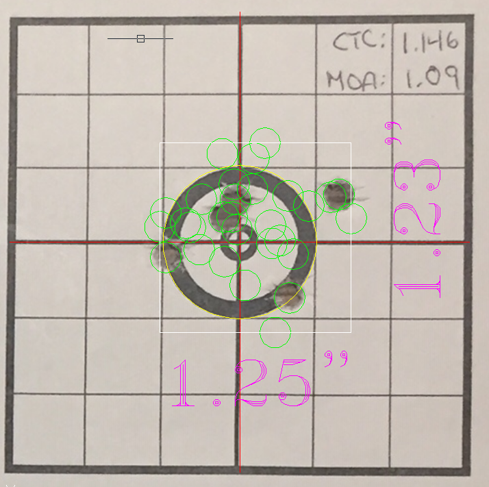

Built an aggregate to see the total spread...1.25 inch horizontal, 1.23 inch vertical.
Very nice. (y)

Okay, so let's say 1" at 100 yards.
Funny thing; I just took the 93R out and shot a mess. Don't know if it was the wind or what.

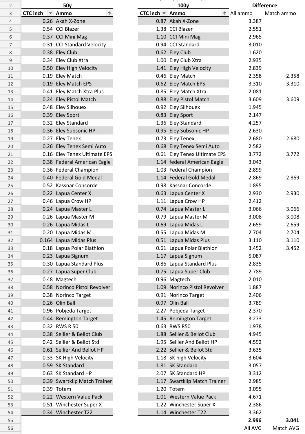

I agree with that also. I did a short comparison, this data is from the accurate shooter rimfire test, shot with the Bleiker in year 2013 or so. Probably everybody here has viewed it at some point.
