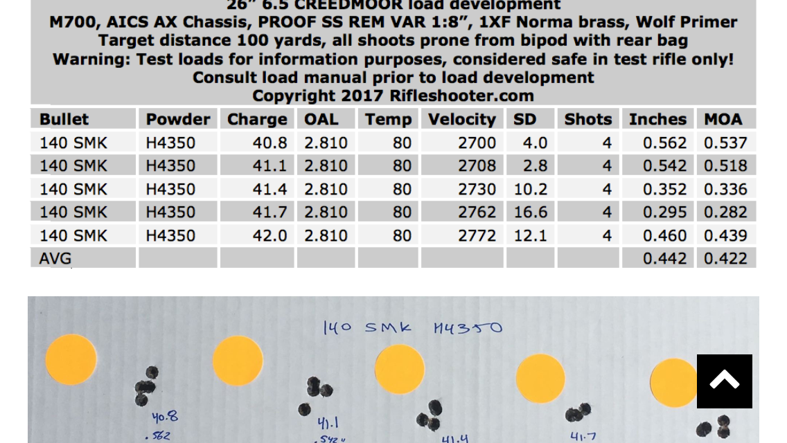

So start by asking the question “What is the easiest to tune, most forgiving bullet for a 1-8” 6.5 Creedmoor?”
I would venture to say it is something with a tangent ogjive, about 140grs in weight, and made by one of the big 3 in reloading. The reason these bullets aren’t more popular is because people tend to buy and load for extreme possibilities, hence very high BC at a very high velocity, something these old designs don’t look good for.
But you want to shoot at a moderate distance so who cares about BC or speed. Look at the 140SMK, 139 Scenar, Berger 140 LRBT or 140 Nosler Custom Competition. Check out this article as well as others on his page:
