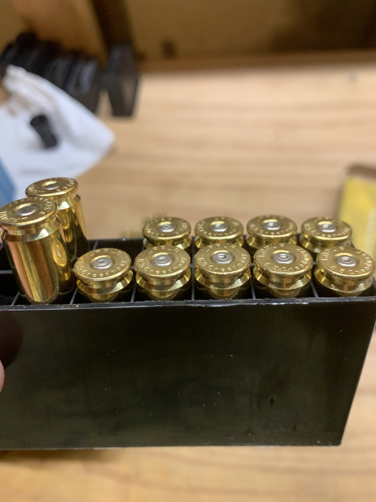

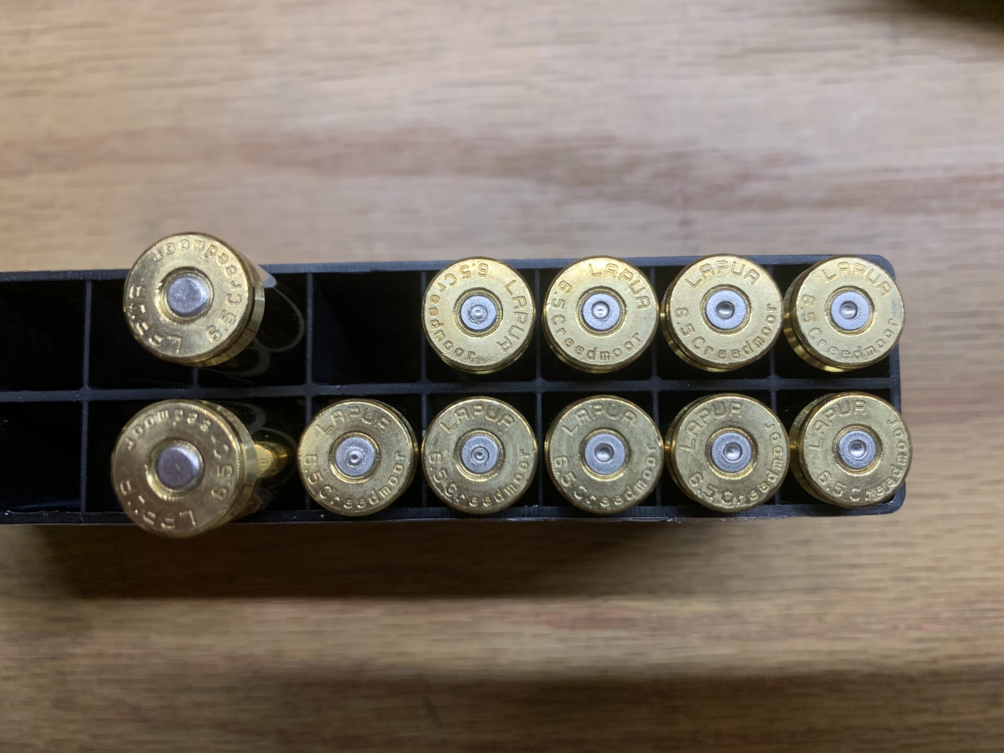

    While shooting yesterday I noticed that the first 3 shots with the small primer, the primer looked good. Shots 4 and 5 the primer looked weird, like it was a light strike or something? The large primers didn’t have that issue.
    Pic of 120 scenar brass, shot #1 at right and work to the left.
    Next to them are factory rounds.

    Gotta love a fast response from the owner of the company! George just confirmed its a issue with the medium firing pin and the SR primer loads.
    Total rookie mistake, thx for bearing with me. Now to sell some ammo....
