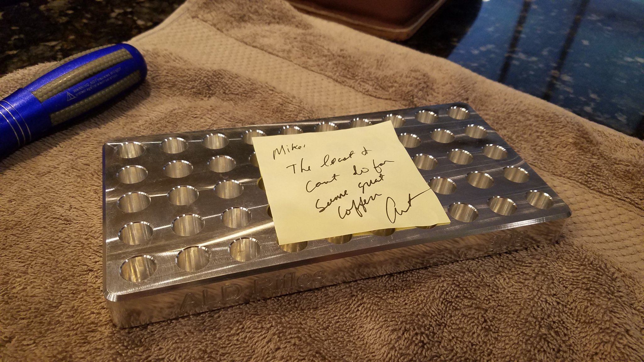

I normally park the good brass in its aluminum tray made by our very own @Rthur of ALD Rifles. He makes some nice stuff.
This is the only image I have of the proper loading tray.
Reactions: Rthur and Stevo86
