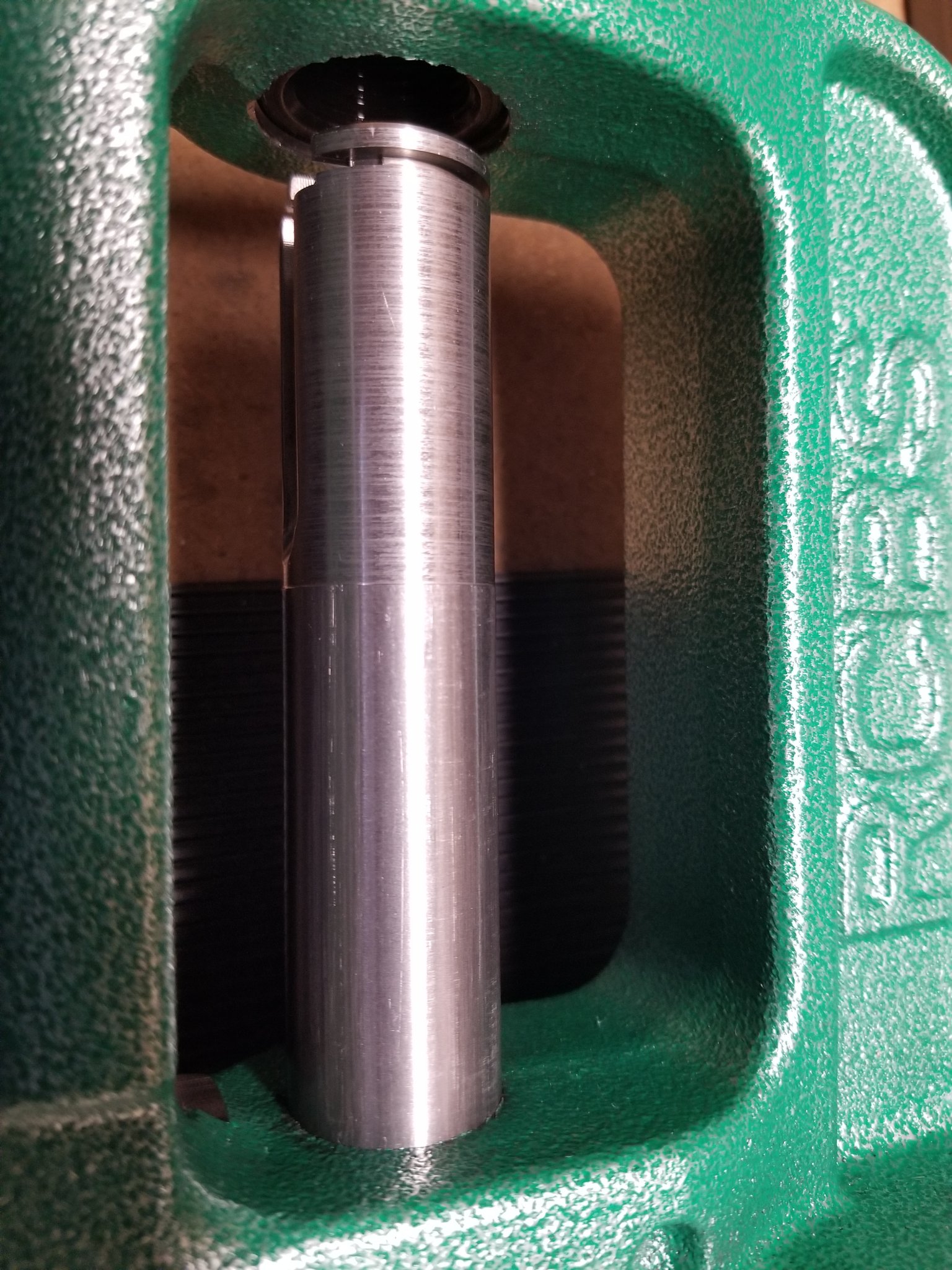

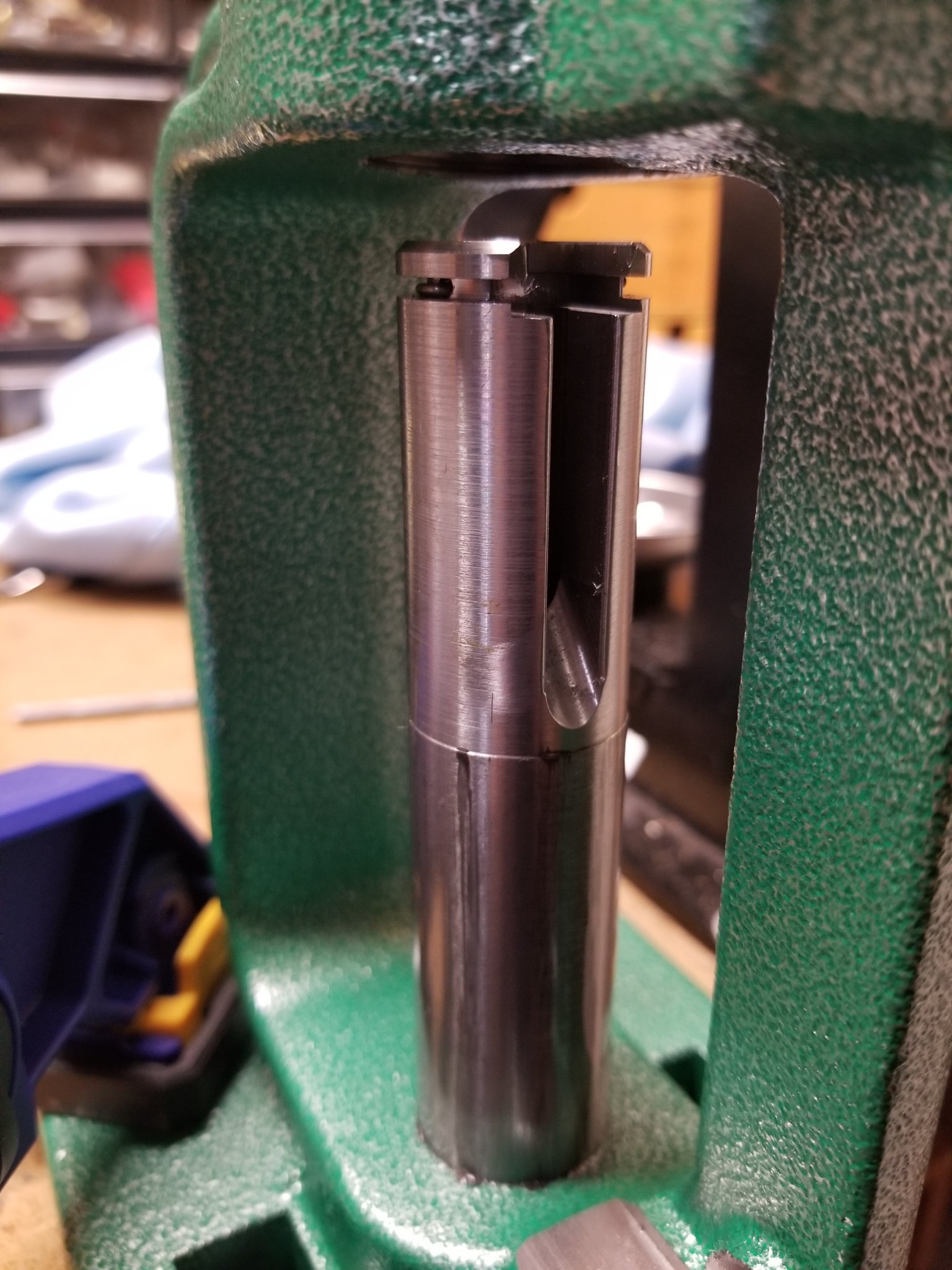

I recently purchased this RCBS RCS4 from OP. Awaiting Inline Tech. stand so I used a clamp to hold it down to examine. Working the press it drags feels "gritty," and I noticed machine marks on the ram. I sent online email to RCBS, awaiting response. Is this typical? Should I attempt to polish or bug RCBS to replace. I can't see OP sucking it up for a manufacturer's mess.

Disassemble ram and remove from body. Chamfer and polish the lower port. I had this issue on one years ago. Took less than 30 minutes to resolve the issue. Never had it before or since. So per my experience 1 out of 8 had this issue. Hope this helps.
Lower port and downward is O.K., the ram from that port upwards is where the striations (?) are located. I guess some fine steel wool will smooth it out. Would really appreciate a response from RCBS.
Thx for advice.

Contacted RCBS, they recommended using Vaseline as a lubricant. (Wife gave me odd looks seeing me go down to the basement with a jar.) Anyway, still "chattered," sounded raspy. Sent them photos of ram, no argument, they sent me a new one, arrived in four days. Touched 1000 grit sandpaper to pivot points, i.e., ram, ram tube, pin, and pin holes(?). reassembled. Very smooth, problem solved.
