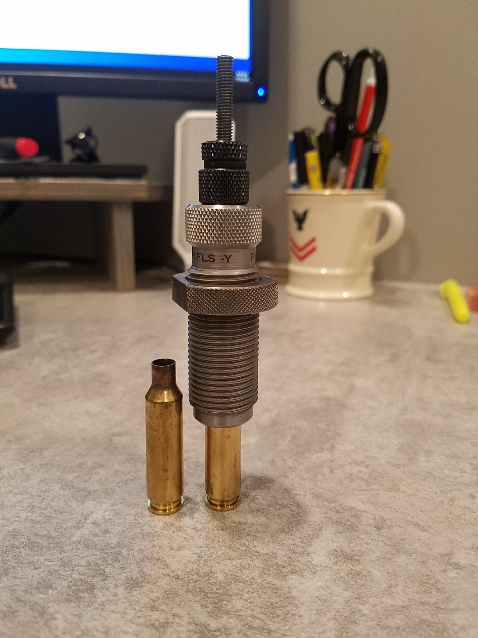

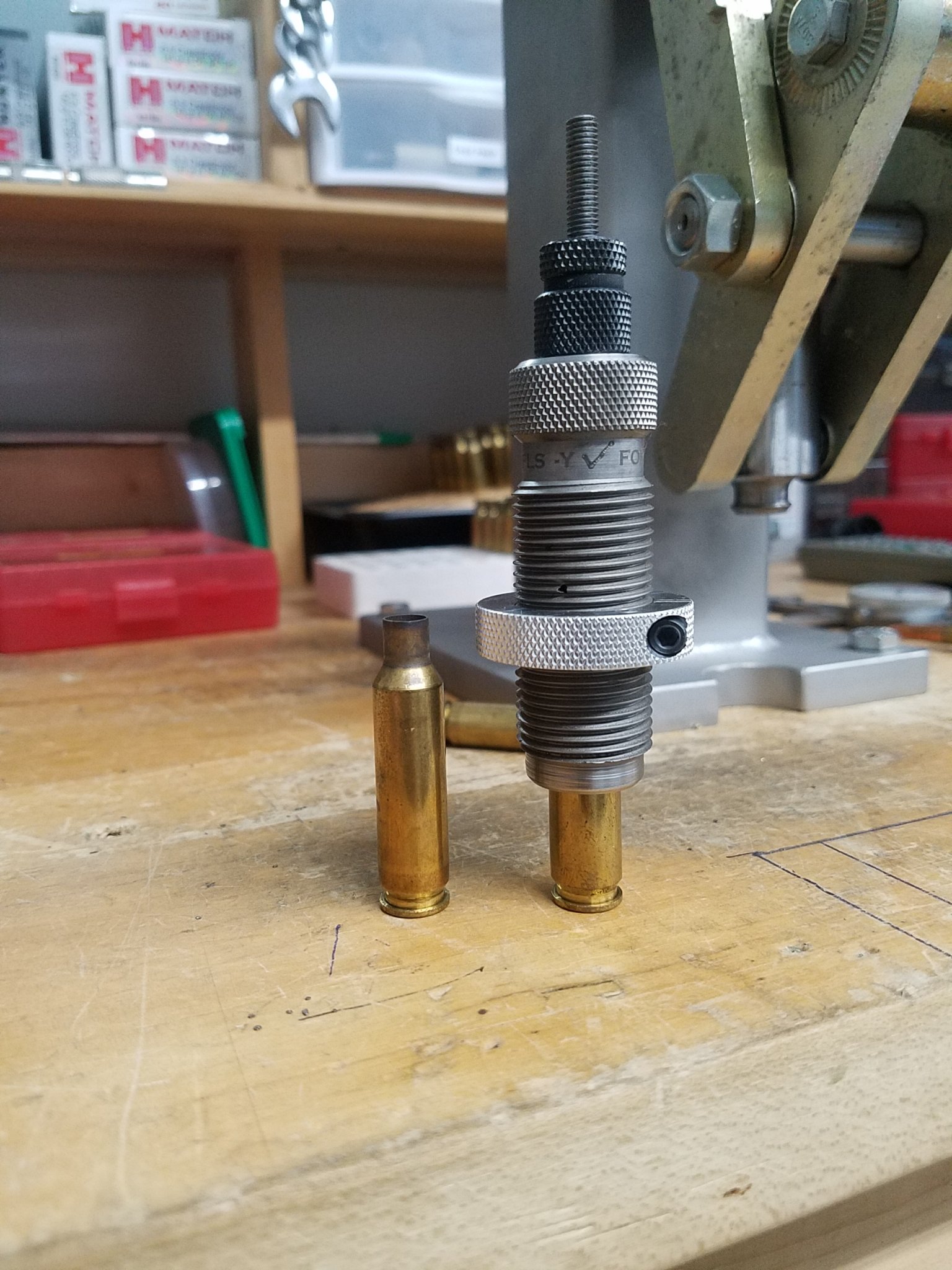

I received the replacement die today with a nice letter. They honed it to .288"(not sure what dimension that is) and the die does go down a good bit further on an fired case. I should be good to go now. Here's a pic of the old and new die.
Old die:
New die:
