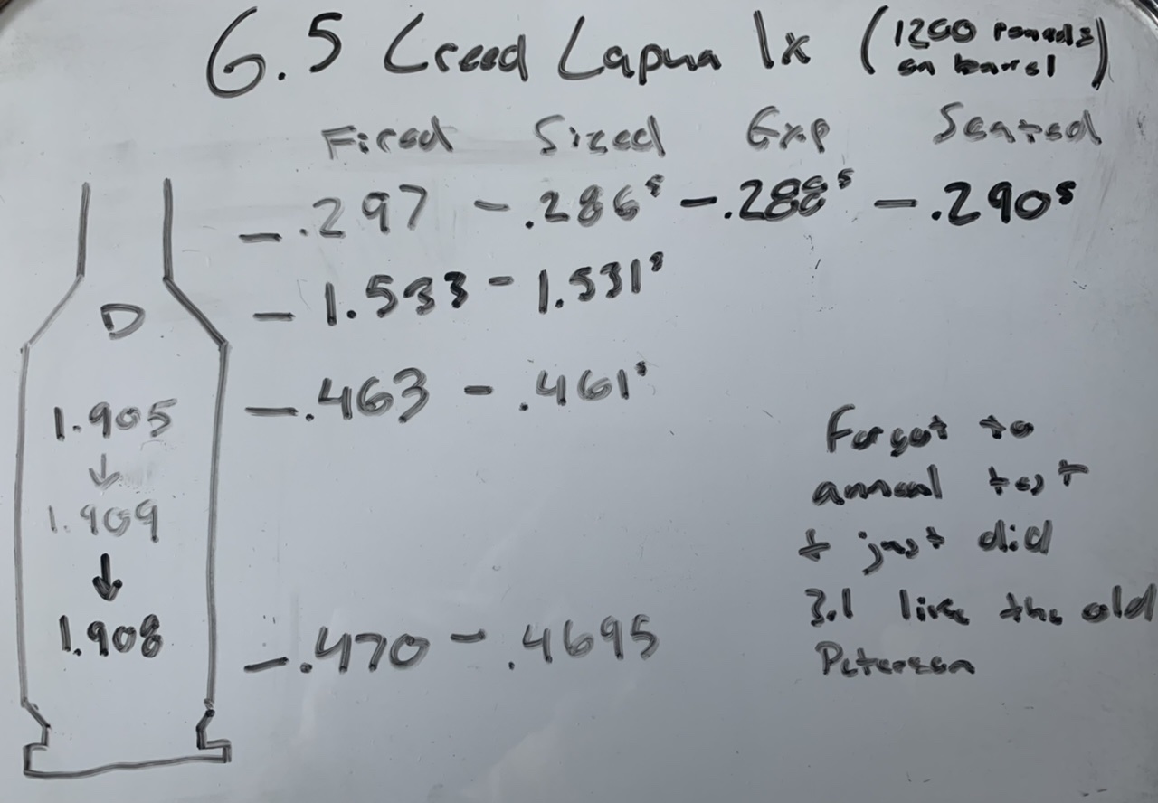

You seem to be pretty on point with your diagnosis, you walked through the steps I would, but I’d also take some actual measurements of each step along the way if you haven’t.
the top row of numbers is the neck diameter at fired, sized, expanded and seated.
I had the same results as you when using a standard die. Eventually picked up a .305 bushing for .308 resizing. Still needs some lube in the neck, but it isn't a struggle to run back over the expander.

So I did a few measurements on the neck:
Sized - 0.282
Expanded - 0.290
Loaded - 0.293
Fired- 0.297
By my reckoning that's an 8 thou expansion of the neck, and that's rather a lot. The expander is .261, so if I assume no spring-back that makes the neck wall about .015 thick, which is about right.
I like the neck tension I have when loading so I think I want a .290 and a .289 bushing for a bushing die.
