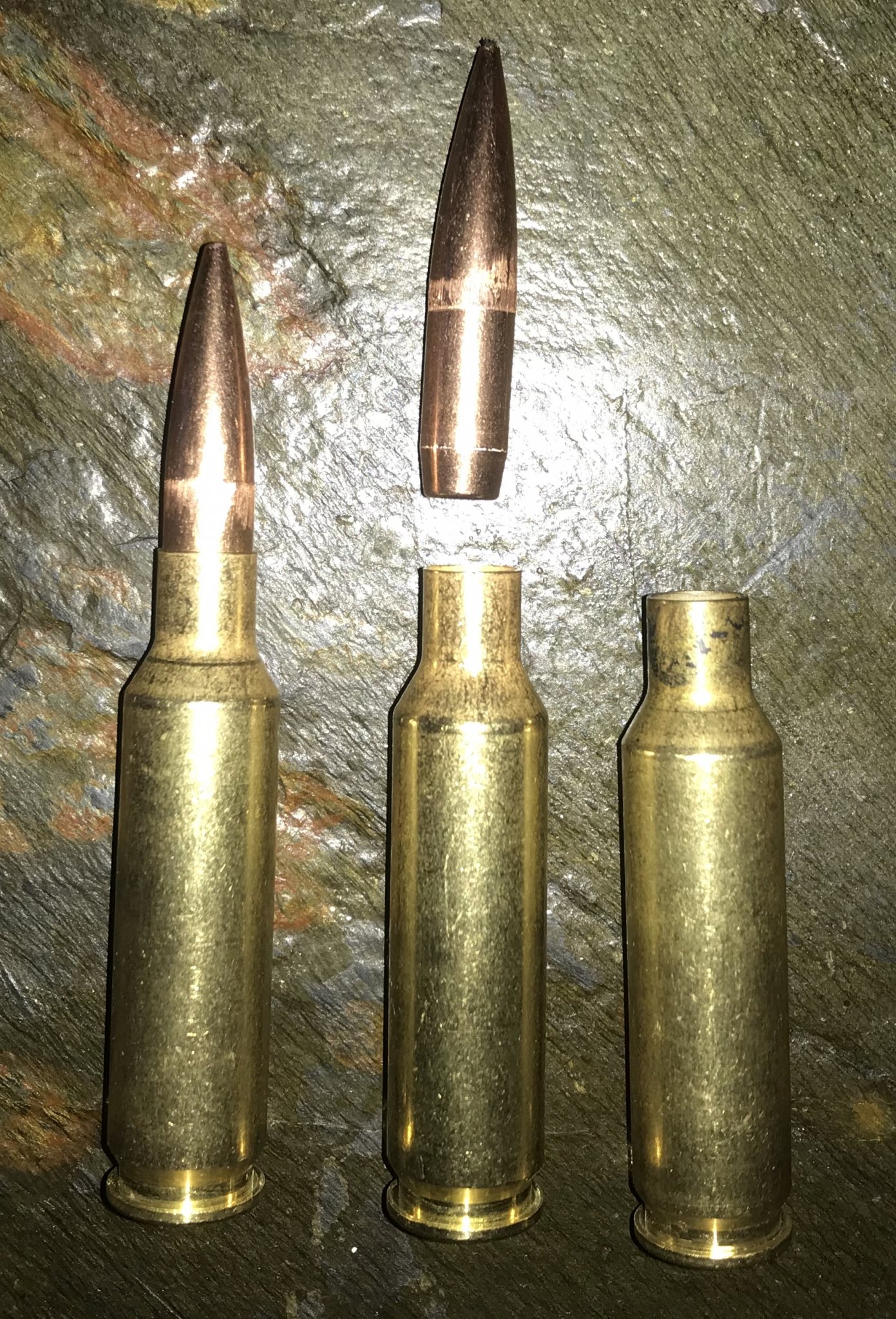

Im currently awaiting response from Bergara but here's my problem. Looking for anyone with similar issues. November 2019, purchased a brand new Bergara HMR Pro in 6.5 CM in hopes to getting involved with PRS matches. As with all brand new firearms, I cleaned out the manufactures grease and oil. I settled on factory Hornady American Gunner 140 gr HPBT ammo. After initial break in then sight in(25-30 rounds), I cleaned the rifle after that range session. I was quite impressed with this combination as I was grouping .33" groups at 100 yards. Velocities(through chrono) revealed 2718 FPS highest reading, 2705 FPS lowest reading, 2711FPS average. Pretty consistent velocities. Initially, I thought that maybe Hornady got match ammo mixed up with my 200 round bulk ammo sale. Next range session, things get a little interesting. Shooting 100 yards then every 100 yards out to 500 yards, I get to round count 30-35 and the bolt begins to become very tight chambering a round, but will chamber a round. After the shoot, once I notice this occurring, the bolt will not extract the spent casing without a blow to the bolt rearwards. I then chambered another round and same stiffness as previous. As I extracted that live round, I noticed that the lands and grooves are imprinted on the bullet. I ceased that session, went home and thoroughly cleaned the firearm again. After cleaning, a tested and a round chamber smoothly and extracted smoothly. No land and groove imprints. Today's ranges session, same story, after shooting 30+ rounds, chambering stiffness and extraction is extremely tight. On 2 occasions today, after chambering a live round, then attempting to extract that live round, the bullet got stuck and lodged in the chamber while the brass was extracted. See attached pic. Round on the right is a chamber round with markings on the bullet. Middle is one of the bullets that got stuck in the chamber and last round is spent casing from today. Anyone else having these issues with the Bergara HMR Pro and Hornady American Gunner ammo or is this ammo/firearm not a good combination? I have not tried match ammo yet as I still have a bunch of this ammo left. There maybe 120 rounds through this firearm and I've never had one act like this especially with factory ammo.

I would also measure the bullet diameter. I've heard of a reputable bullet manufacturer that had a lot that was out of spec. Worth a check.
Bullets measure dead nuts at 0.264. I picked out 6 random rounds out of the bulk pack and measure COL as followed: 2.793, 2.791, 2.803, 2.795, 2.796, 2.790. Hornady reloading manual advises 2.800"

I agree with the carbon theory. I would guess the free bore is to tight and a thou of carbon (for example) is enough to stick it. I've seen a savage with a similar problem. It would pull 175 FGMM. Gun Smith said it was tight and touched up the chamber, been great since. A tired reamer in production could give you this result. I'd get with the manufacturer first. If you take it to a smith it's yours! Let us know what fixes it.
On another note, I pretty much disassembled the gun for a thorough cleaning. Leaning towards carbon build up but again, why after so many shots, it's carboning it up that bad? Yes a question for Bergara or independent gunsmith. Here's what else I discover last night and don't know it it would have any bearing. The firearm does have a muzzle brake to tame muzzle jump for follow through. I removed that last night to soak the barrel of loosen the carbon. On the recessed crown, the carbon was so thick and harden, it took me over and hour just to get the carbon off the crown. Honestly, it's a Precision armament brake and I hate it. Doesn't reduce muzzle jump at all. My spotter yesterday also noticed that the bipod jump off the bench. Would a muzzle break accelerate carbon build up throughout the barrel to include the throat? I know the Bergara is far from being a custom firearm with tight and close tolerances but should this be firearm need to be treated, as far as cleaning, any different that one of my other factory firearms?
Worn or resharpened reamer is undersized in the freebore. Going off memory here but I think the SAAMI spec is 0.2645" for freebore diameter so it doesn't take much if you have a reamer that's cutting a 0.2643" hole, and it's fairly typical for bullets to run a couple of tenthousandths over nominal.
#s are just for example. A proper cerrosafe cast and mic might show what's up.

I shot about 400 rounds of that ammo down the same setup - typically 40-50 rounds per session. I bought two bulk pack of 200 rounds and I had that happen to me with 2 of the rounds on one day. It freaked me out when I had a really hard time getting the bolt to close on 2 bullets in a row. I was able to extract them and there was a very similar looking mark on the bullets. Probably not smart, but I went ahead and shot them anyway. I went home and cleaned the chamber really well and did not have the issue again. I don't think it was the ammo - I think it was a cleaning issue with the rifle and maybe a carbon ring.
