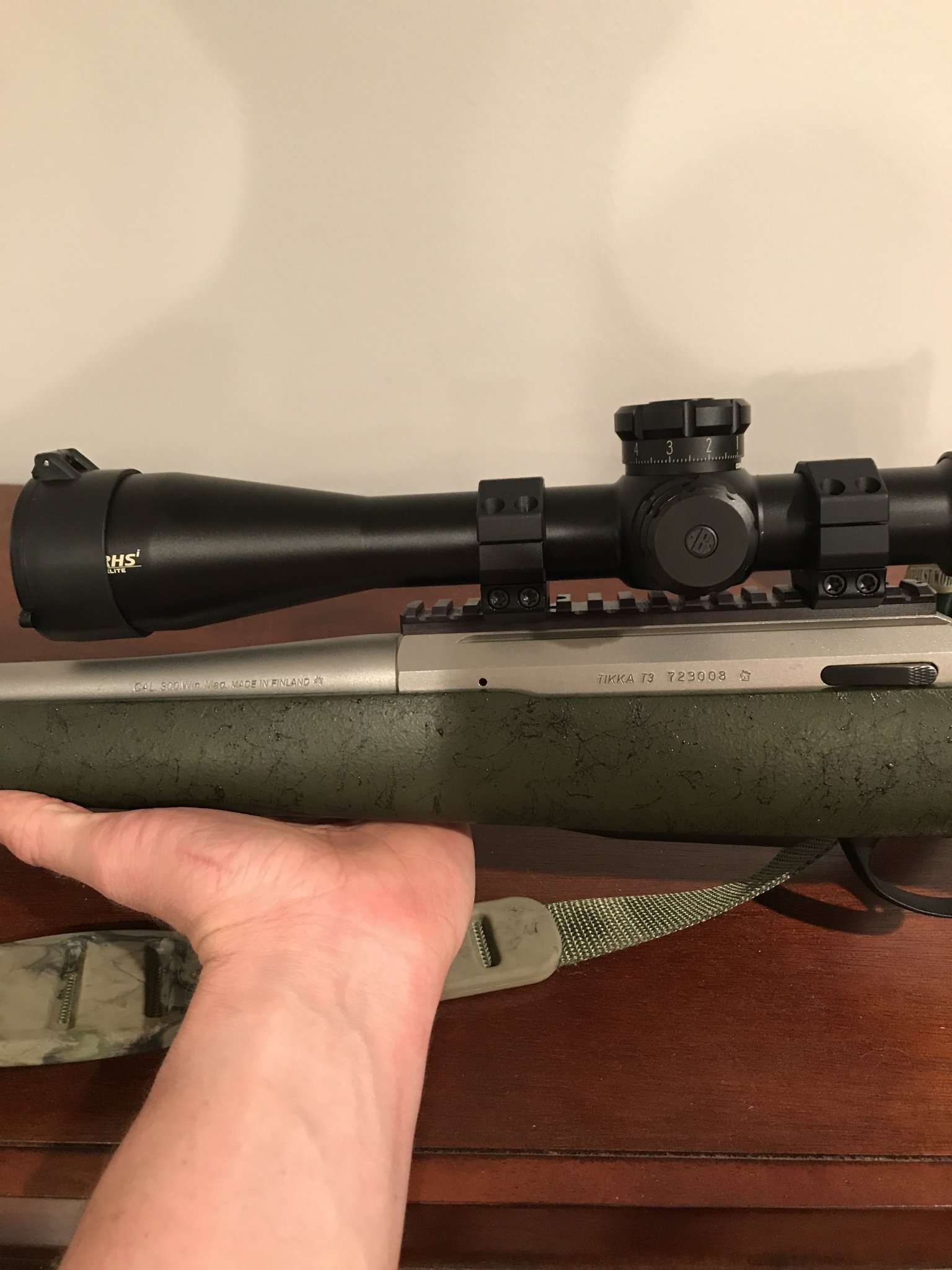

I have a 6.5 Creedmoor ctr with a mountain tactical 20 moa rail and a 6-24x50 vortex viper pst, my rings are . 875" from the top of the base to ring centerline. This leaves about 3/16" between the objective end of the scope and the barrel. With a 44mm objective you will be fine with the lowest, .820", rings.
I would go with .87" height to give some room for caps and room in case you upgrade the scope in the future. It's not overly high.
definitely go with the regular medium, the vortex defender caps that you may use are kinda thick being made of rubber. they'll need a bit of space. have the 5-25 PST on my tikka with 20moa rail and seekins medium fit just right, not too high, not too low
Low .82" rings On a 20MOA EGW base with LHRSi 4.5-18x44
