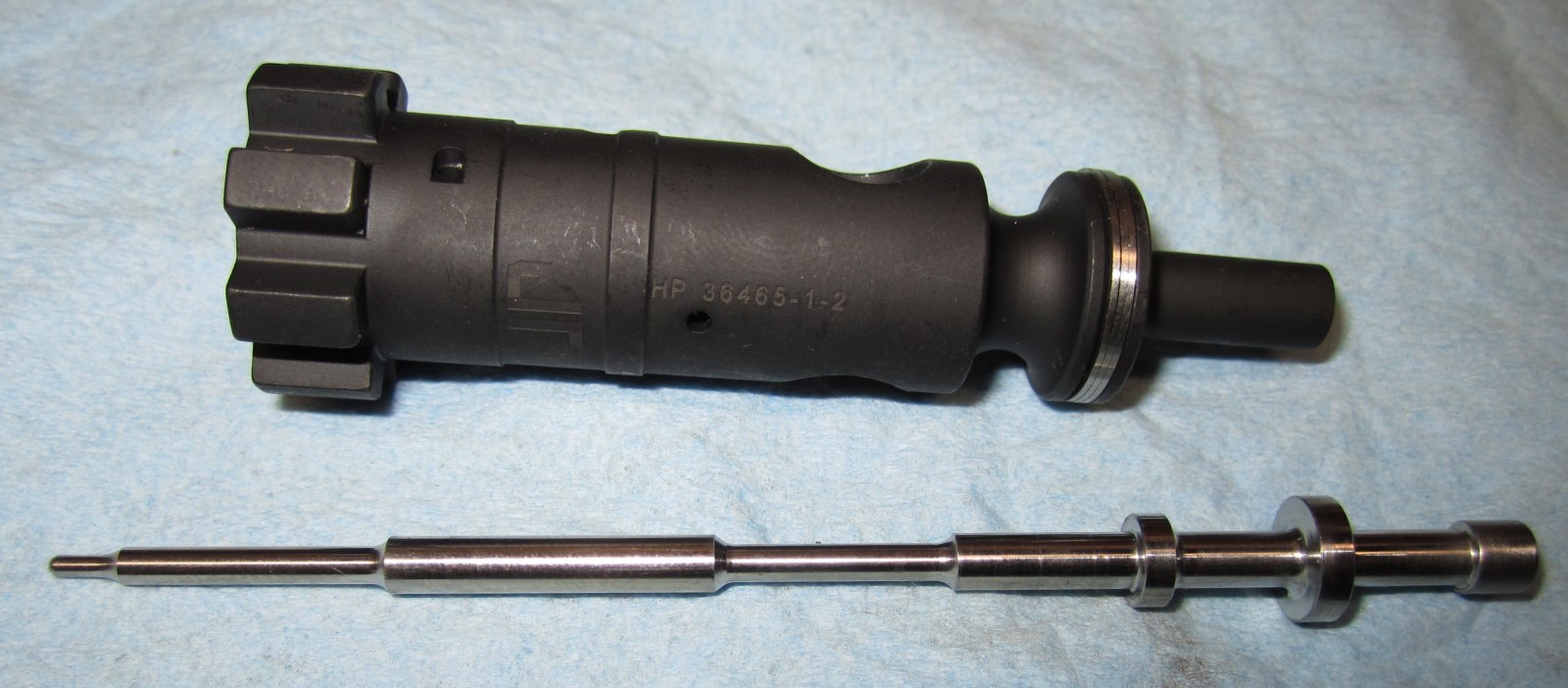

Earlier last year I had horrendous primer piercing issues with my new 6.5 CM GAP-10, George's solution was to switch it from a DPMS BCG which uses a .080 firing pin to an Armalite BCG which uses a .068 firing pin and all the cratering & piercing issues went away. The .080" firing pin isn't typically a problem with .308 but it's calibers like 6.5CM and .260 with different pressure curves that usually have primer issues with the .080" firing pin.
I've been wanting to do a similar fix to my 6.5CM JP LRP-07 for almost a year now as it has always lightly cratered the primers but I didn't want to switch to a complete Armalite BCG and give up the JP low mass carrier. A couple months ago I heard JP had something in the works; Ben at JP hooked me up a couple weeks ago and sent me one of their new "high pressure" bolts before they hit their webpage. JP's new bolt is DPMS pattern so it's a drop in to rifles that currently run DPMS-pattern BCGs but it uses a smaller .068 firing pin.
Here's a pic of the new "high pressure" bolt & firing pin...

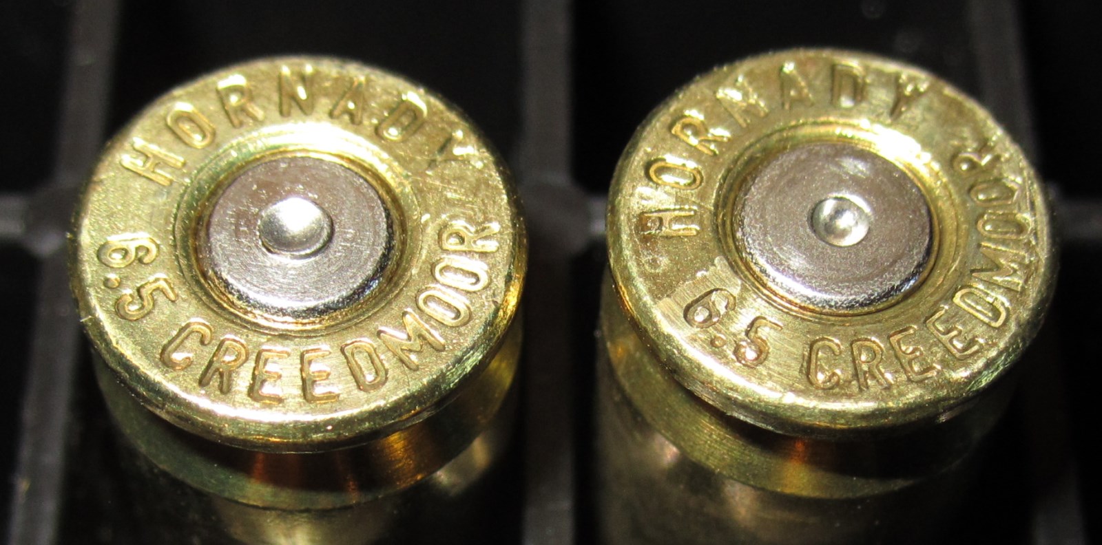

And here's pictures of the primers. Same rifle, same load, each round fired only a couple of minutes apart-- just enough time for me to change bolts. Old bolt with .080" firing pin is on the left, new bolt with .068" firing pin is on the right. Huge improvement in primer condition is an understatement. I won't have to worry about ragged primers on hot afternoons anymore!
I want one. What did it cost?
JP only had limited quantities a couple of weeks ago and didn't have them on their webpage. However, I just looked on their webpage and it looks like they're available now under the "bolts and carriers" section. Comes with the firing pin obviously. When I was on the phone with Ben I also wanted to snag a spare firing pin "just in case" but he mentioned they won't have an inventory of spare firing pins for a few weeks-- right now there's only enough firing pins to cover what bolts they have on hand and not enough to sell spares yet.

Sorry if a dumb question but why exactly is primer cratering a bad thing? What does a cratered primer affect? Although none look as bad as the one in the pic above, I have more than a few rifles that show slightly cratered primers with mild-med loads. To me, this has always been a sign of a over sized firing pin hole but never a sign of a problem.
Because cratering is getting close to a pierced primer which can cause a lot more problems and damage. The primer condition pics in the first post is from the JP and is what I would call "mild" cratering. My 6.5CM GAP10 as initially received left the primers in far worse condition. There's a difference between cratering caused by excess firing pin to bolt clearance and cratering caused by a firing pin diameter that's too large and leaves too much of the primer unsupported for the case pressure. In the case of .260 & 6.5CM in DPMS-pattern rifles it's the latter-- the .080 firing pin and hole in the bolt leaves too much of the primer area unsupported for the pressure curve of the cartridge and the primers will show cratering and stress even with very mild loads.
In addition to badly cratered primers my 6.5CM GAP10 as originally shipped with the DPMS bolt & .080 firing pin used to pierce primers with alarming regularity. It wasn't uncommon to pierce 3-5 primers out of 10 rounds fired with factory Hornady ammo. It was irritating to have to disassemble the bolt every time it pierced a primer to clear out the primer piece stuck inside the bolt... but it was far worse when it stuck the firing pin because of firing pin tip deformation from a pierced primer and then the thing ran away full auto for the remainder of the mag. Luckily none went off out of battery which could have damaged the rifle or myself!
When GAP switched the rifle to an Armalite bolt which uses a .068 firing pin all cratering and piercing issues went away. While my JP never pierced primers I wanted the same solution-- I did *not* want to pierce a primer and have a repeat of that full-auto runaway and risk of an out of battery ignition. Once was enough! Anything that gives the rifle and primers more safety margin is a big improvement and the smaller firing pin provides a LOT more safety margin when it comes to cratering & piercing primers.

I can only speak from a sample of 2 rifles, but my 24" GAP10 in 6.5 CM had horrible cratering & piercing issues with factory Hornady 140 ammo and my 22" LRP-07 had mild to moderate cratering issues with Hornady 140 ammo when using the original bolts with .080 firing pins. All primer cratering issues in both rifles went away with a swap to a smaller firing pin (Armalite BCG swap in the GAP10, new JP HP bolt in the LRP-07.) The cratering issues in both rifles was much worse with the 140s compared to 130s or 120/123s. Personally, I'd go either Armalite BCG or JP HP bolt and you'll probably never have to worry about cratered or pierced primers.

While the gas system has an effect on primer condition it's not as much of an influence on the primer condition as much as the firing pin diameter is. Even with the gas system shut off the GAP10 would still crater & pierce primers with the original DPMS bolt and the JP would still leave mild craters on the primers-- this was with the DPMS .080 firing pins in both. Prior to swapping to the HP bolt in the JP the change that made the largest positive improvement on primer condition was switching from 140gr to 123gr bullets-- again, even if the gas system was shut off.

For reference when I switched my LRP-07 from the original bolt to the new high pressure bolt the headspace changed by about 0.0005". While I don't have a full set of incremental headspace gauges I do have access to a CMM so I wrote a program and measured and compared both bolts for the dimension between the bolt face and the back surface of the lugs before swapping them. Comparing fired cases to the CMM bolt measurements confirmed the CMM measurements to within about +/- 0.0001".
